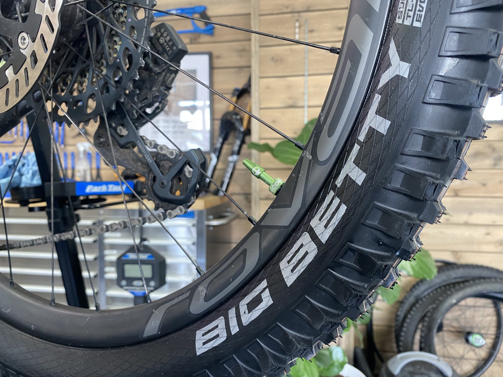

I got a set of Cushcore for the Levo.
Anyone running these with Schwalbe Super Gravity / Super Trail Big Betty and Magic Mary combo?
Thinking that Super Gravity and cushcore may be overkill?
Mate has cushcore, but we all run vitoria inserrts now... Easy to fit, more support... 5 of us ran these in the lakes and no flats, twinned with eddy currents.. Considering iv ridden over 25 years in the lakes on every bije, tyre and tube this has been the 1st puncture free trip!!!
Riding that exact combo with Cushcore right now. I've been a fan of Cushcore with every tire I've used it with, and don't feel it's overkill for the Big Betty/Magic Mary combo for the trails I ride in Western Canada. I don't think there's much to lose on an ebike? Maybe a bit of battery life?
You using super gravity casings?
I just installed a set of Cushcore Pro on Big Betty 2.6 / Magic Mary 2.6 both in Super Trail casing.
I’ve a set of Super Gravity on the at way also. Not sure if I’ll use them?
I wouldn’t normally bother with inserts where I ride, but the event I’m doing - Trans Savoie, the organisers have said to use DH tyres, within inserts if possible for the Rocky sections.

For your trip I'd definitely fit the Super gravity casings. Super trail is just a trail casing. ie. not particularly tough (prob perfect for your local riding though)
Infact I'd probably fit a Super Downhill casing on the rear depending on how smooth/quick/clumsy you are these days.
fit a faster rolling compound/tread on the rear if you think the extra weight is going to be too draggy on the climbing sections.

Yeah I’ll likely fit the Super Gravity when they arrive. I did these today as I wanted to see how to install / remove cushcore before I hit the Alps, so no bother swapping them out.
I do notice that the Super Trails seem way thicker on the sidewall than most other trail tyres, even Exo+. In fact I don’t think they’re that far off a Maxxis DD on the sidewalls (the Super Trail Big Betty 2.6 in 27.5”weigh 1240g!)
