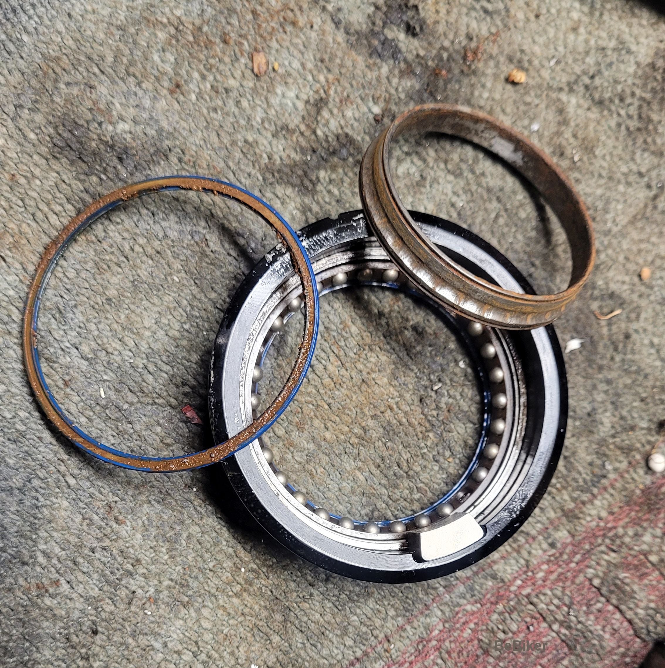

This is how the old bearing looks, after cleaning.
My guess is that some water got above this lower bearing, and slowly entered through the upper sealing to the inside.

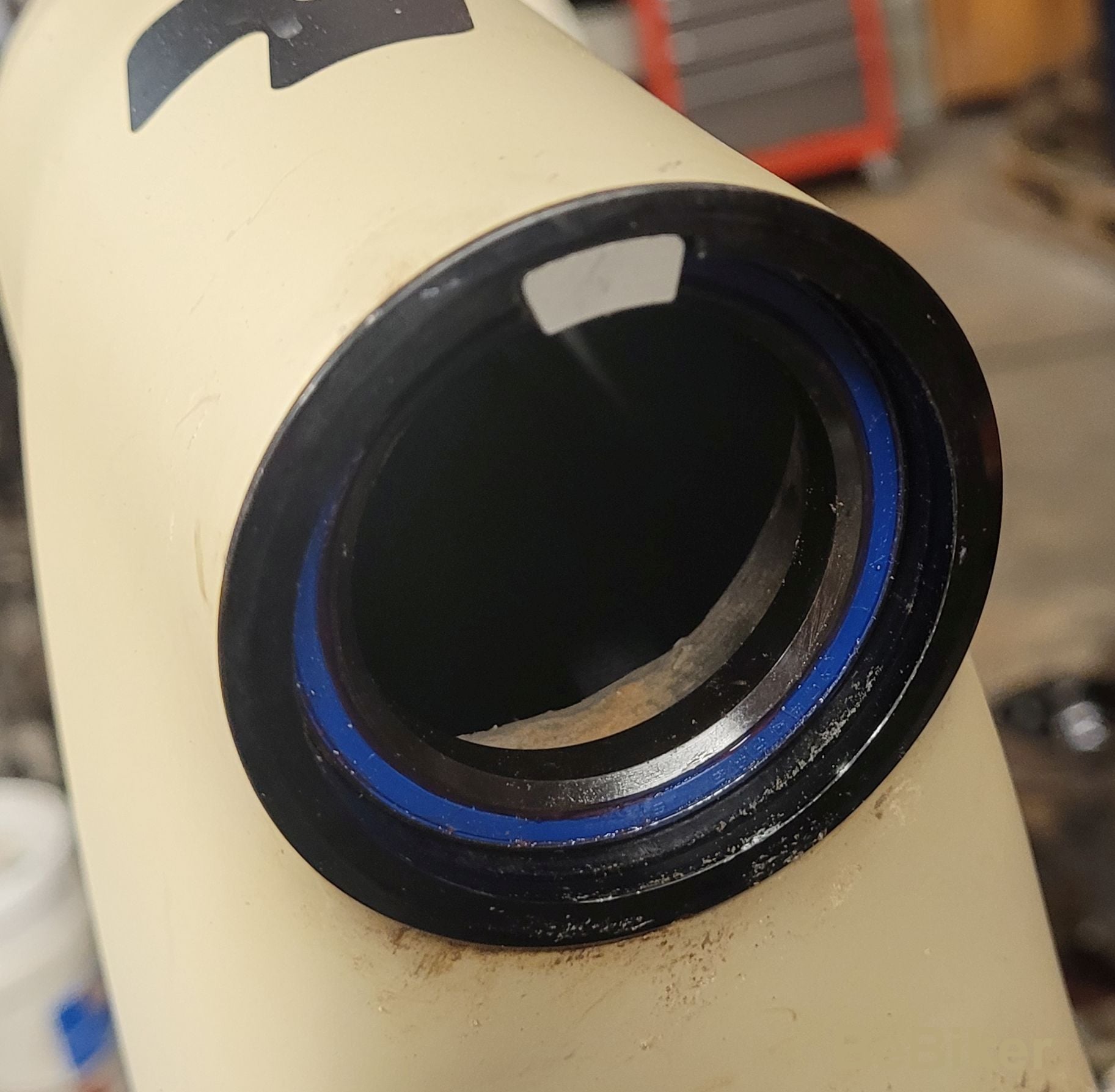

The new bearing inside:

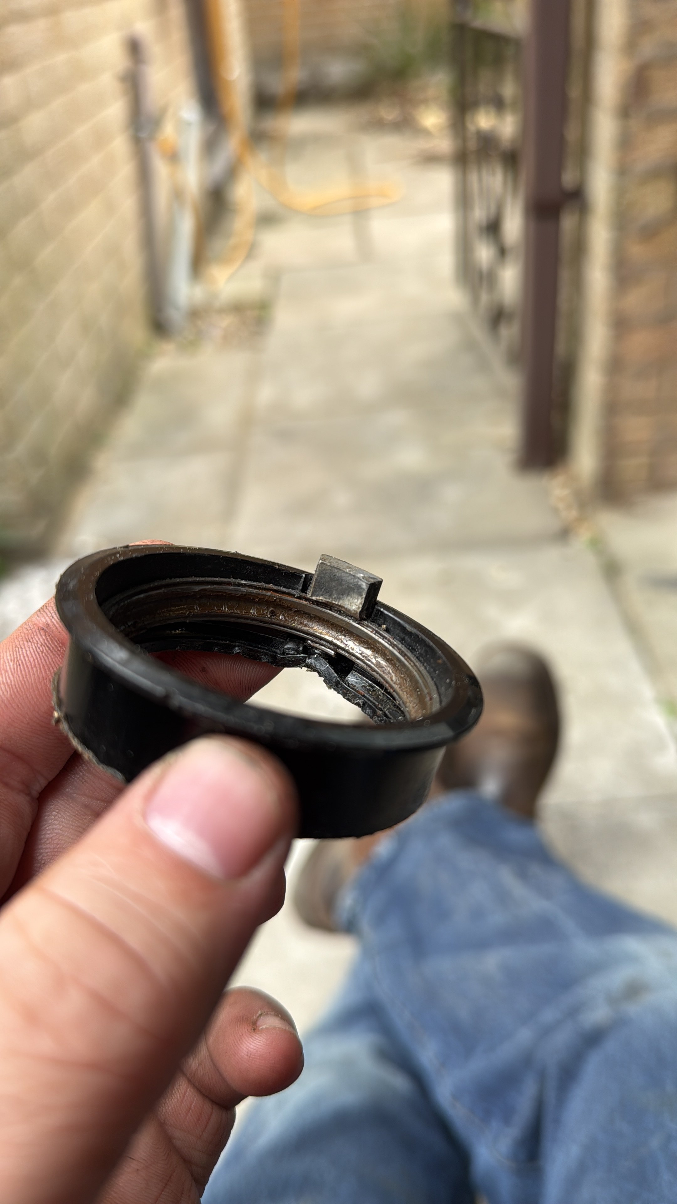

Hi @BeBiker can I ask how you removed the bearing from the blocklock lower casing?
Acros say it's not seperately replaceable and I have to buy the whole thing

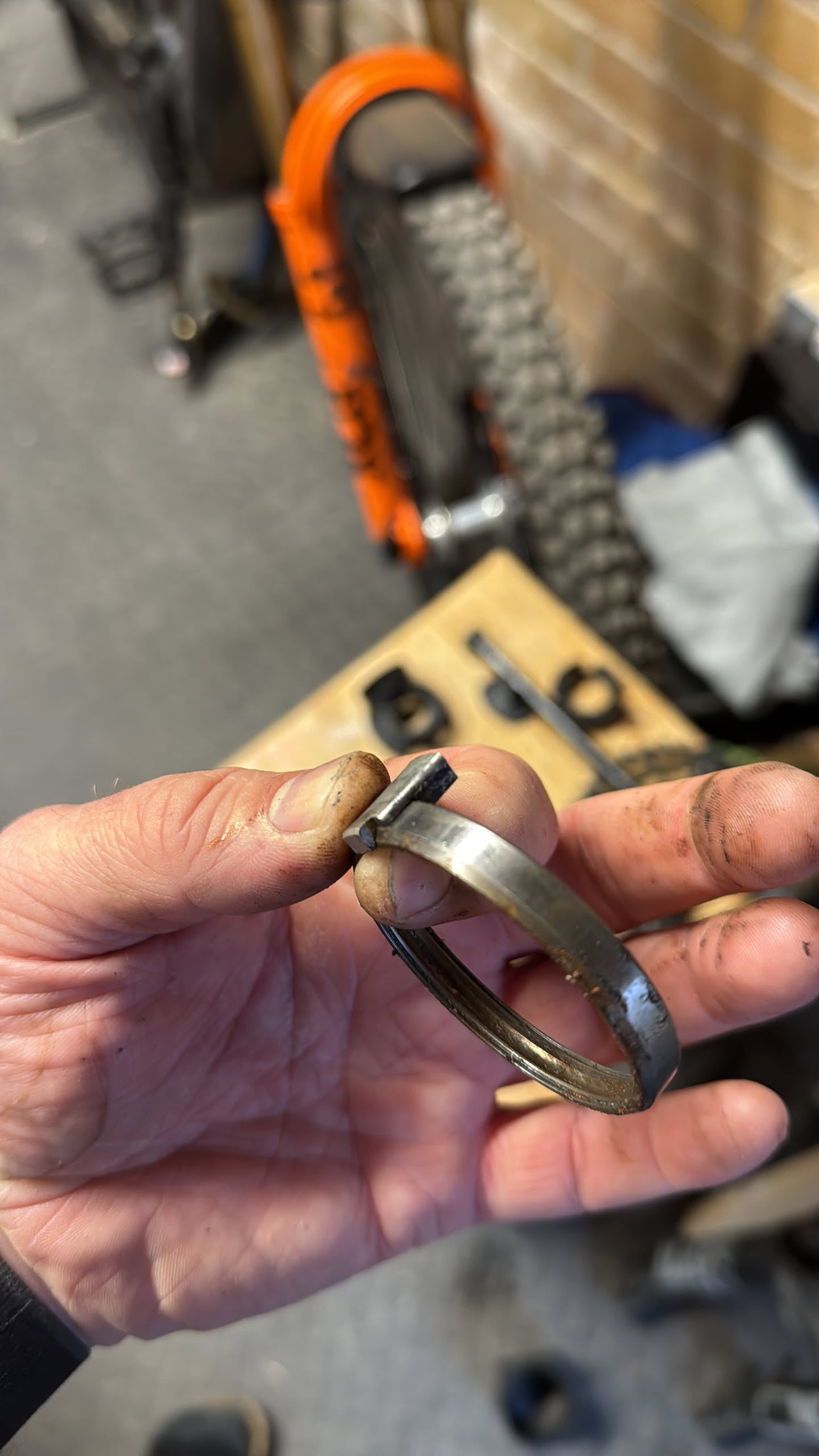

I'm sorting a mates Mondraker Crafty R out at the moment which uses the same headset and I tried to remove the bearing from the lower but it seems to be encapsulated into the blocklock steel part which is then screwed to the outer casing - so it ripped to pieces trying to come out
I've ordered the full £110 top and bottom replacements from Acros - but I will have to do this on my Cube soon as it's creaking and they're terrible for water ingress due to the internal cables - I'd rather replace with high quality bearings for £40 instead of spending £110 at acros that will last another 6 months at best :(

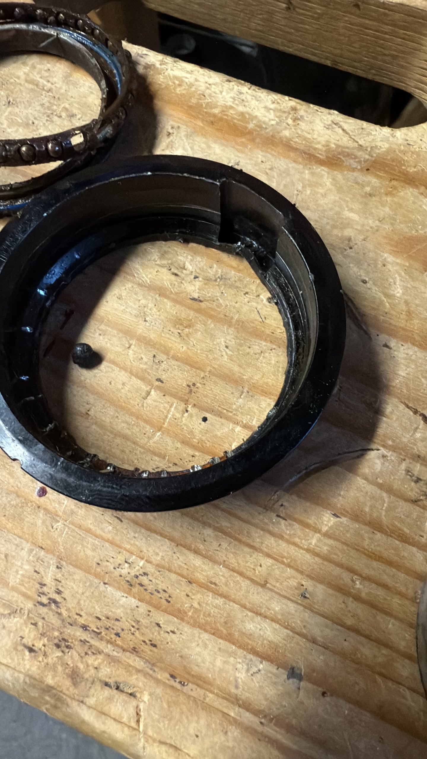

If you turn it around, press or hammer on the bearing ring, it comes out together with the blocklock.
There's not a lot of space to hammer or press, but it works.
Got it thanks!
Obviously too late for this, the outer bearing race was rusted in - my mates Mondraker Crafty was a 2022 and never been replaced so I thought it was somehow screwed or welded in.
Turns out just a few blobs of glue and a LOT of rust
