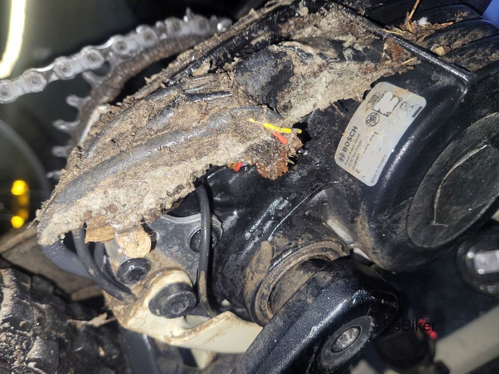

Since the beginning, the bike falls out completely every +-100km.
No warning, no error, unrelated to asphalt, jumps, cobblestone,...
When restarting, that always works instantly.
The bike has been in the shop for this: Update, blabla, didin't change a thing.
Until last week, then it was unable to restart, sometimes falls out again after 5 seconds, falling out 10 times in a row,...
but I was able to make it home.
BeBiker
Aug 26, 2020
663
404
Belgium

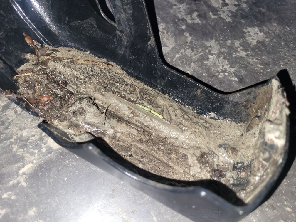

Let's check for bad connections:
The original bashguard: >2cm of mud, sand, dirt
Upside down, the motor and connectors:
I cleaned everything, pulled out the connectors, cleaned that, problem solved.

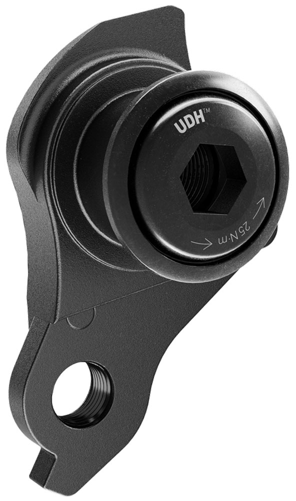

Impossible to look up which derailleur hanger is mounted on our Cube.
They all go by names like: Cube standard, Cube 160, universal,...
So I took it off, it's this one: Sram UDH
Now I'm ordering spares, the speed sensor is the 615mm one:
The power cable is the 500mm one.
I need this in case one day I need warranty.

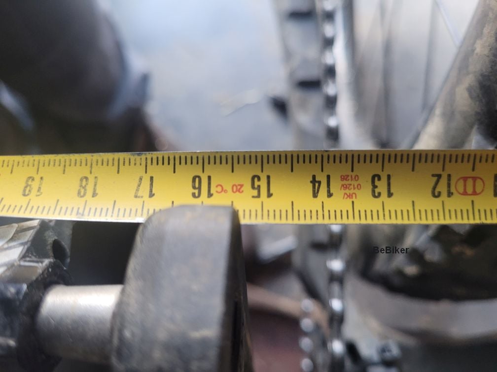

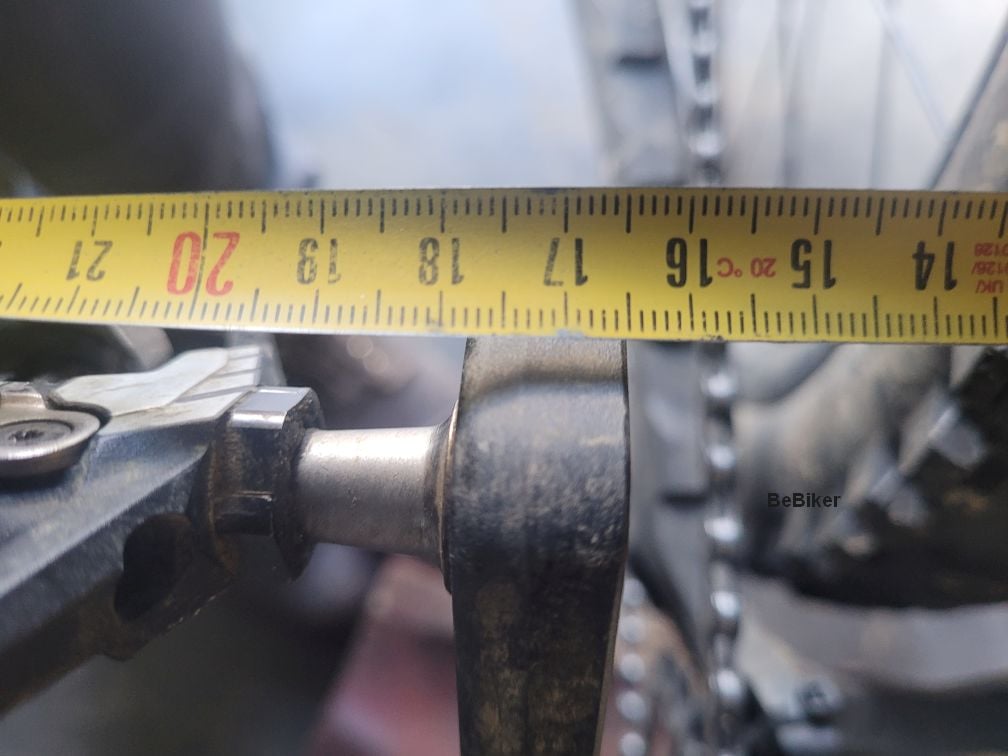

The crank arms are 165mm long.
Touching the ground with the pedals is a brand new experience to me :oops::oops::oops:
I plan to install 152 or 155mm.
Inbetween the cranks there is 153mm, Outside between the recessed surfaces +-175
This seems to fit:
Any experiences ?

Funny for my Cube 537113 they indicate the Radon Derailleur Hanger 8651, while the Sram UDH is installed.
Maybe compatible with both, and they installed another one due to the 2021/2022 stock shortages?

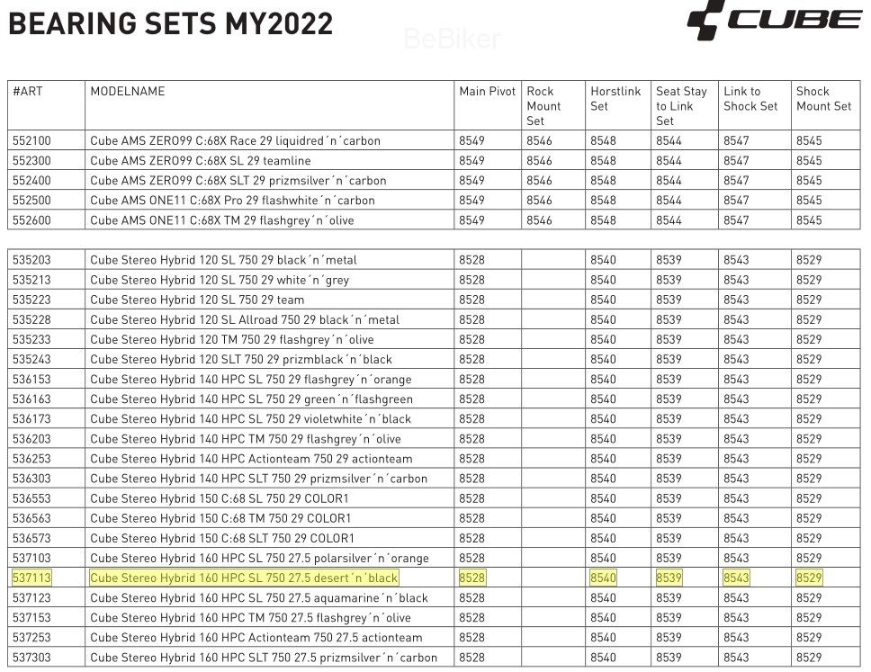

Belgium
  • Derailleur-HangersBearing-Sets_2022.pdf
  • CUBE-Bearing-Sets-MY2022.pdf
BeBiker
Aug 26, 2020
663
404
Belgium

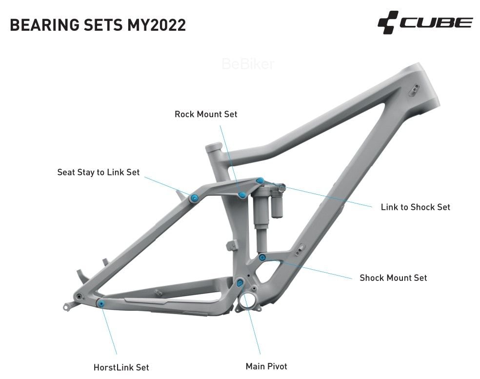

Those are Cube numbers of the set, which contains bearings, spacers, bolts.
Didn't find any further dimensions info, but at those prices I think just ordering the sets.

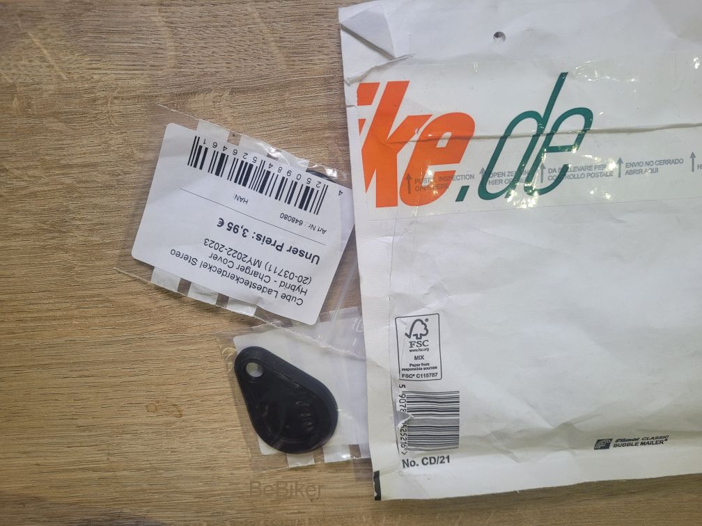

You get a new port and cover as a waranty at your dealer. Much improved version.
Do you have some more details what has been modified vs. the „old“ version:

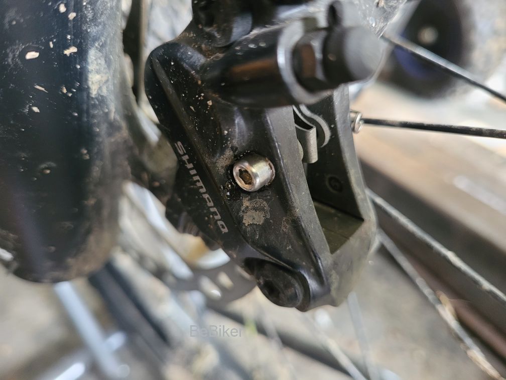

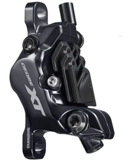

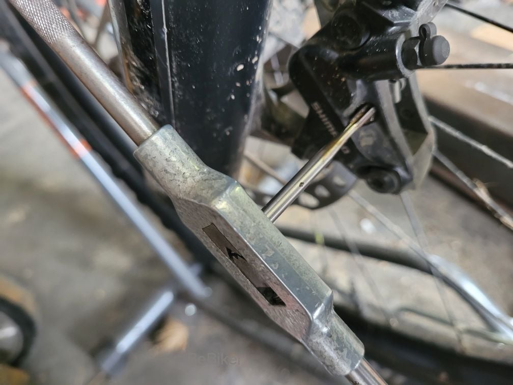

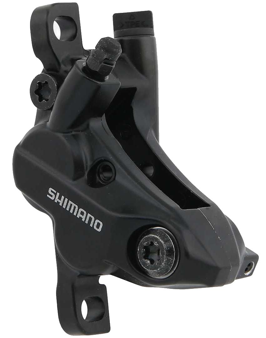

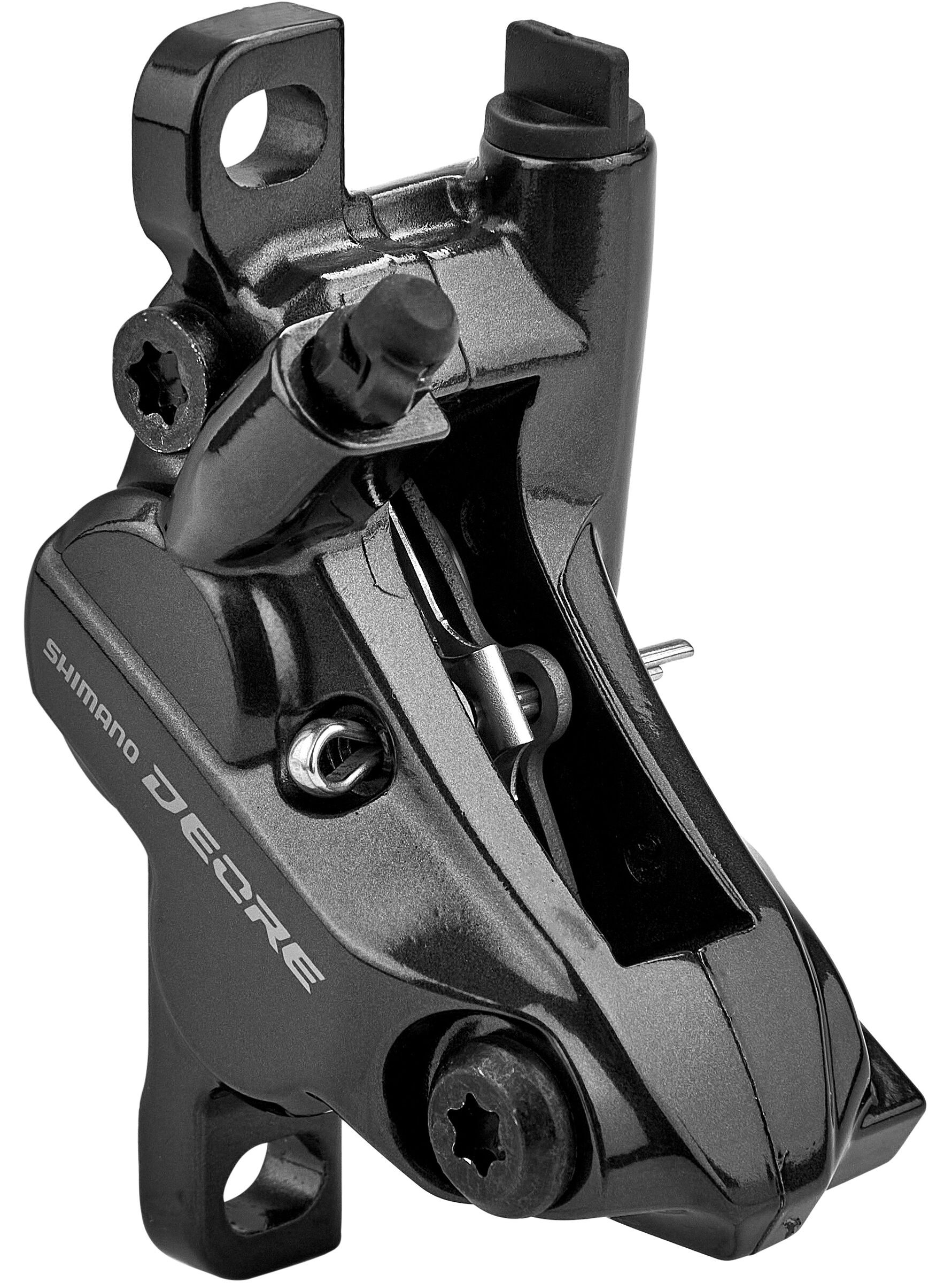

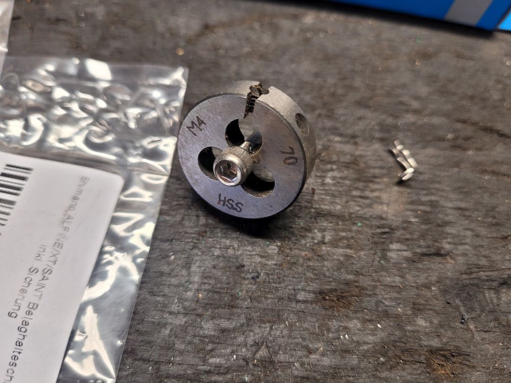

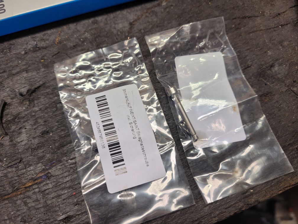

I always was a bit underwhelmed by the split pin in the Deore BR-M6120 MT520 brake caliper.
The Deore XT brakes, and even the Tektro brakes from my Decathlon Rockrider have a bolt with a clip on it.
Then stumbled upon a tread about the conversion on this forum:
On the forum there was some confusion about the thread size, it's definitely M4
Scientific aligning, angle correction and positioning
Bolt and clip in place, ready to go !
