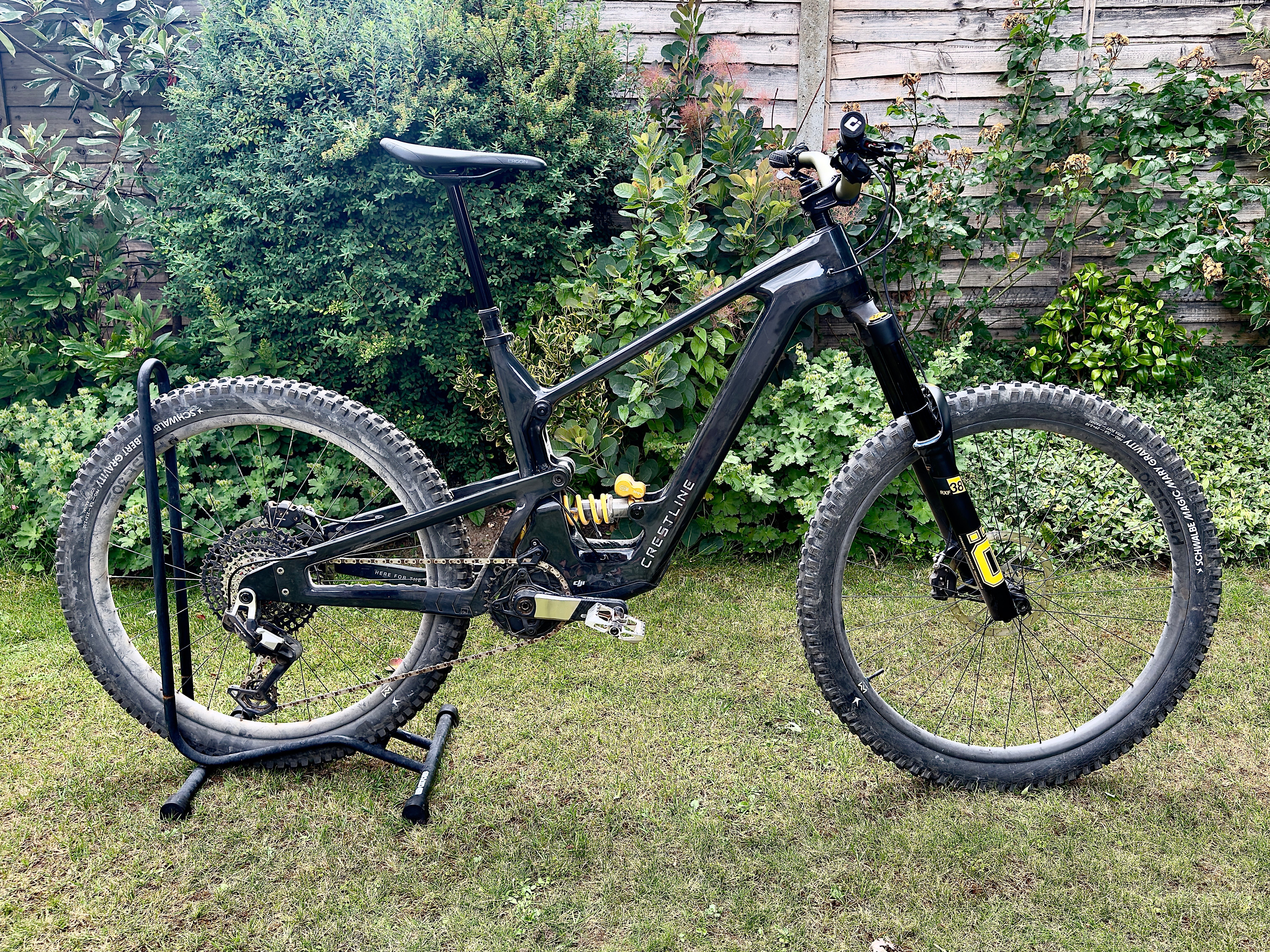

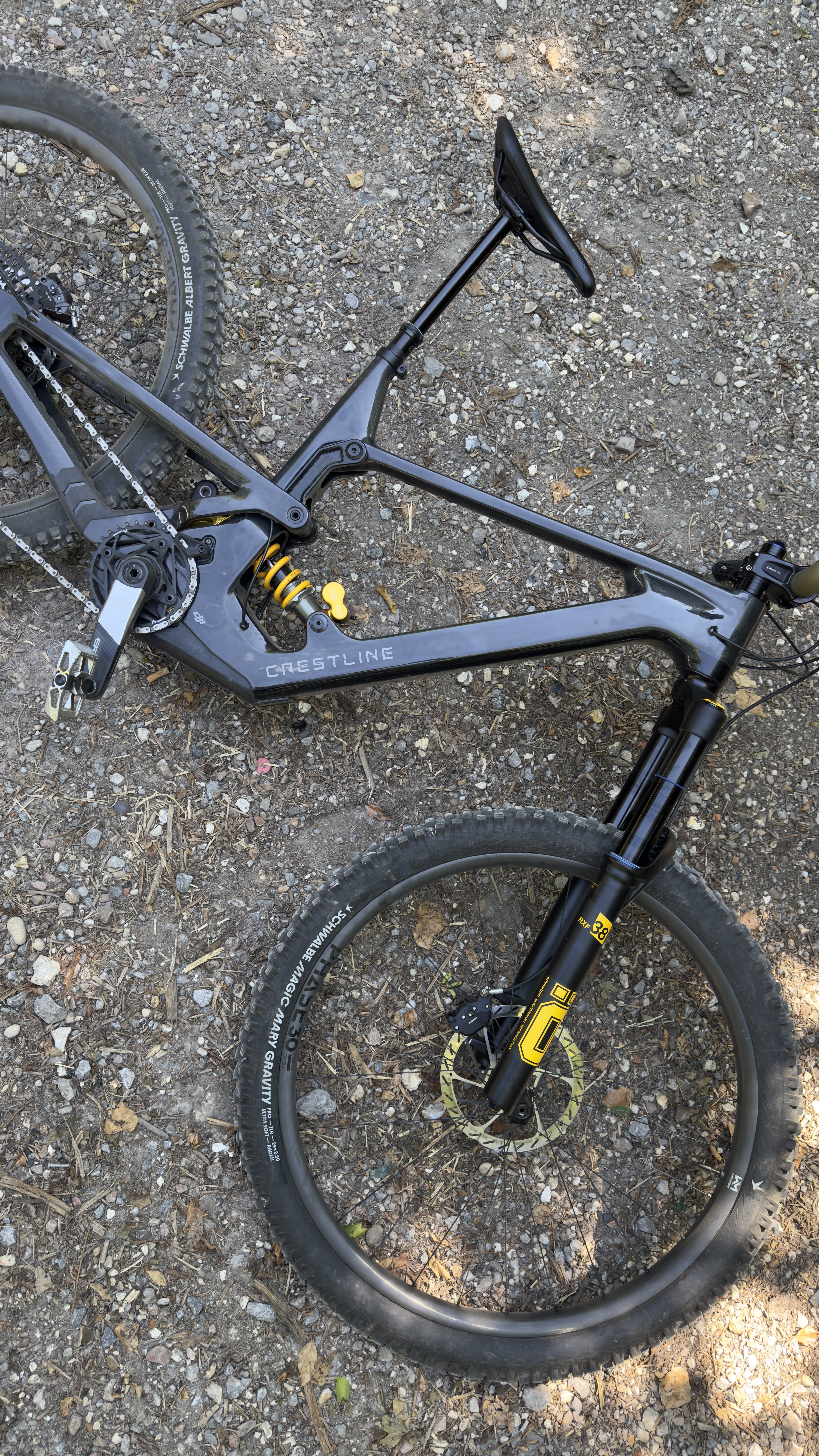

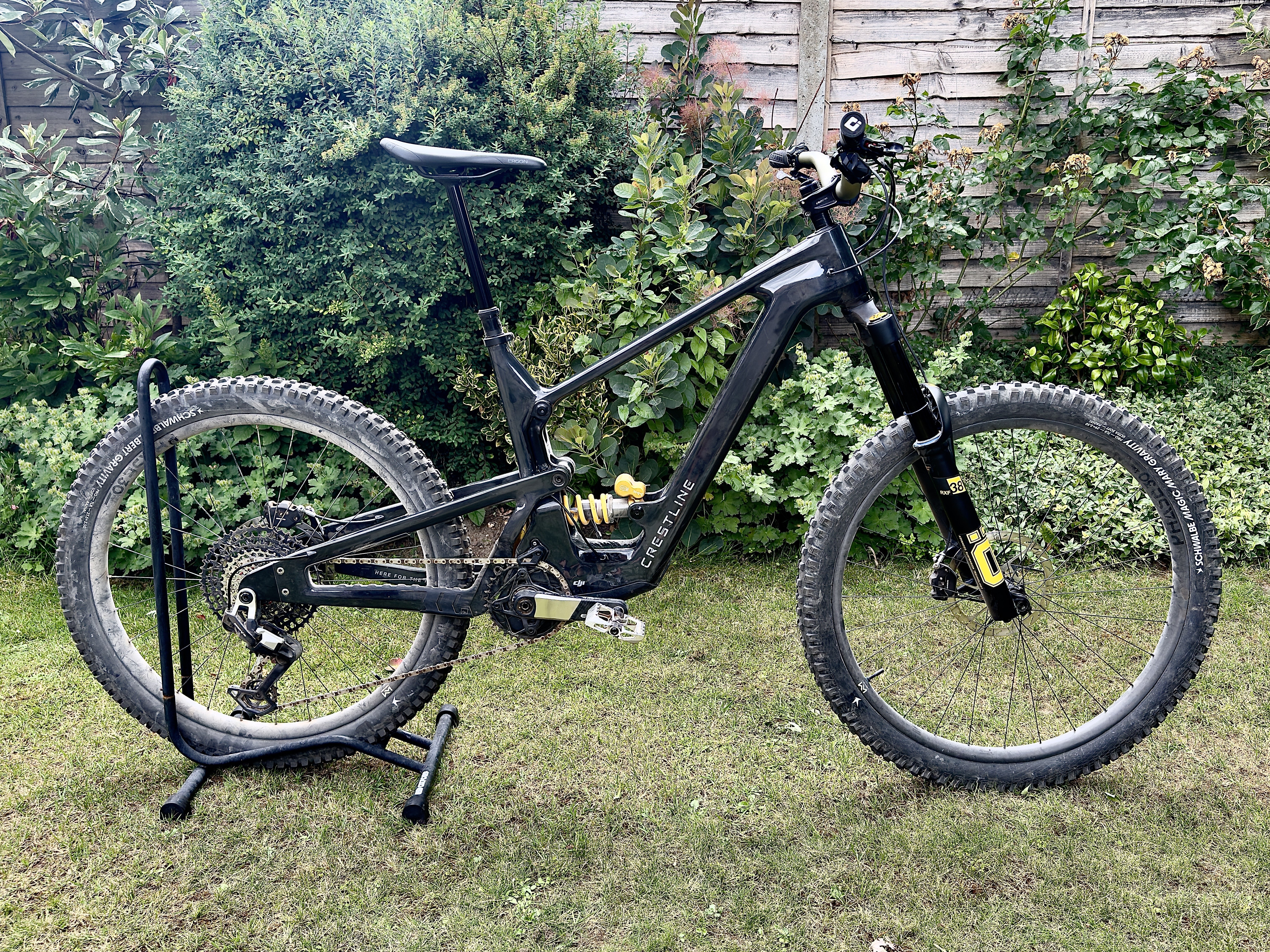

Simply one of the best bikes I’ve ever ridden.
Full coil setup (RXF 38 Coil Forks)
Mullet
460 Chainstay

This is a size Large. Its a 210mm OneUp dropper, thats about as far as it'll go.
I have only had 3 rides so far, but the thing feels quite different IMO to the Bosch bike. It feels a lot lighter and sharper, but its probably not much lighter at all, I think its around the same weight.
Big differences:
Positives
- Mullet, with long rear centre, put tons of grip on the front wheel. Customise your rear end with dropouts is a massive plus.
- Feels far more lively all over compared to the Bosch version. This one is 15mm shorter in reach (485mm) than the Bosch one I've been riding, which will definitely contribute to that feeling.
- Measures pretty slack on my measuring device, like 62.9 degrees
- 1309mm wheelbase, 180mm travel front and rear
- Rear suspension tune feels a bit firmer in the first bit of travel, maybe its less progressive
- Exists corners with lightning pace, step on the pedals and its fricking fast!
- DJI makes the Bosch feel like an SL. I know its been said a lot, but I left my Bosch mate standing.
- Looks stunning. Literally not far off a normal pedal bike in looks.
- Steeper seat tube angle over the Bosch
Negatives (so far)
- Motor rattle. Personally I'm super sensitive to bike noises. The rattle annoys me (I hear rattle on all the Avinox bikes I try)
- Seat tube insertion. Never gonna be able to run 240mm droppers on this bike, sadly.
- SRAM cable transmission feels a bit cheap on the lever end. I’m moving back to wireless, especially now DJI has coast shift!
So happy with it so far!

Yes potentially, the Ohlins is brand new, and likely contributes. Also, I prefer how the new one feels over the old one :) I ran a Fox X2 and DHX2 on the Bosch version.
I just spoke with Troydon now, he said the progression is very similar, but there's less rearward axle path on the new bike, due to the battery being higher placed and more weight on the front wheel, so he didnt want extra weight on the front with the rear centre growing under compression.
So perhaps thats contributing to a lesser of a lever arm on the back end, as there isn't as much growth.
I measured the BB height of approx 346mm, with Schwalbe Albert 2.5 rear and Magic Mary 2.5 front.
As for the dropper at 210, you don't have it slammed down, so would the 210 allow it to be fully inserted in your opinion?
No, it wont slam down any lower than what I have it. I tried (size Large frame). The cable actuator at the bottom of the post doesnt allow free movement of the dropper cable to be pulled.
About the same / very slightly less.
