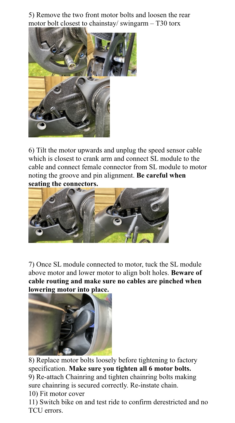

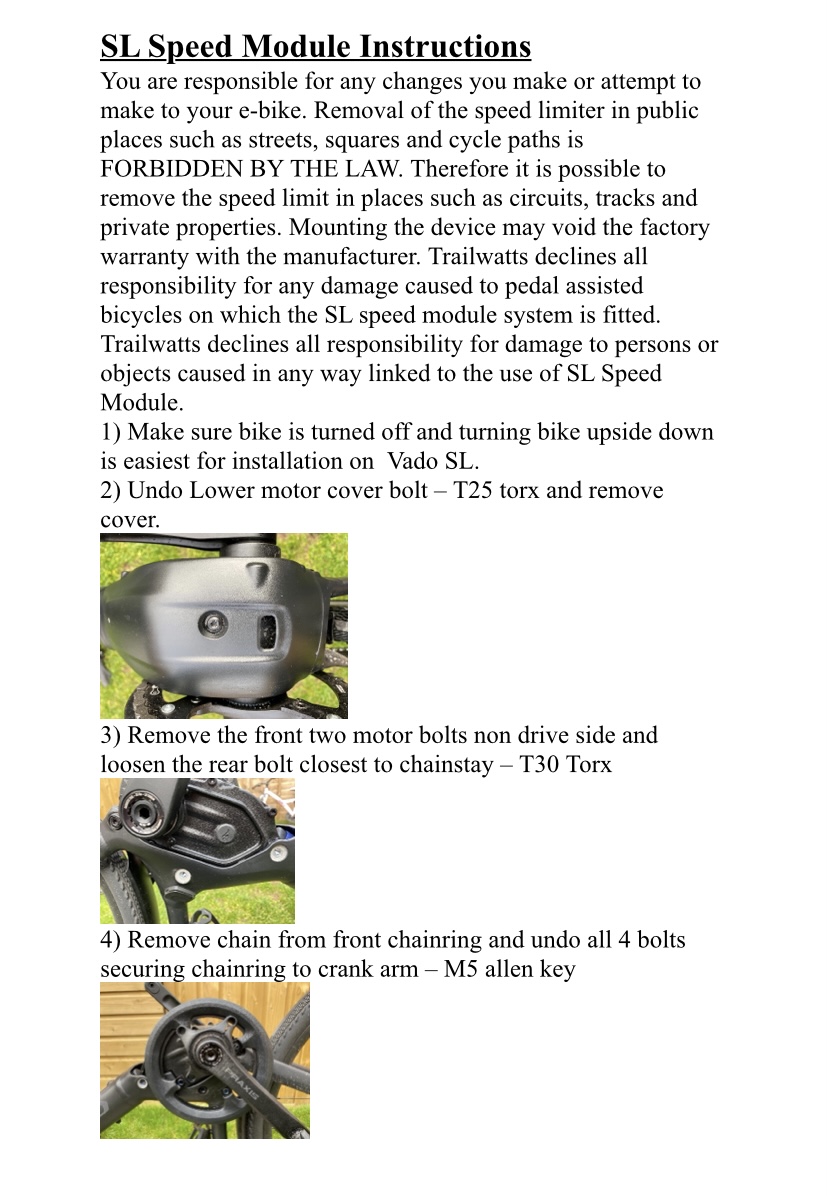

Creo/ Vado instructions should be posted here tomorrow.
