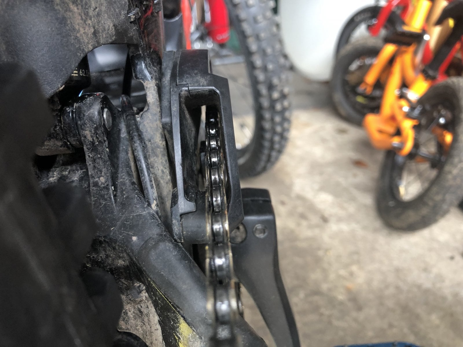

So turned out to be that the chain guide mount had loosened/been knocked and rotated backwards, which was causing the swingarm to hit it when going though the suspension movement, which was in turn pushing the guide against chain ring.
You can see in the attached how the guide was touching the chain stay.
Mine was like that from factory. It ate through the rubber and a tiny bit through the metal before I found out where the noise was coming from.
9,185
Just to clarify it was the mount/bracket that had come slightly loose and rotated backwards, not the actual plastic guide. You can access the bolts through the chainring
