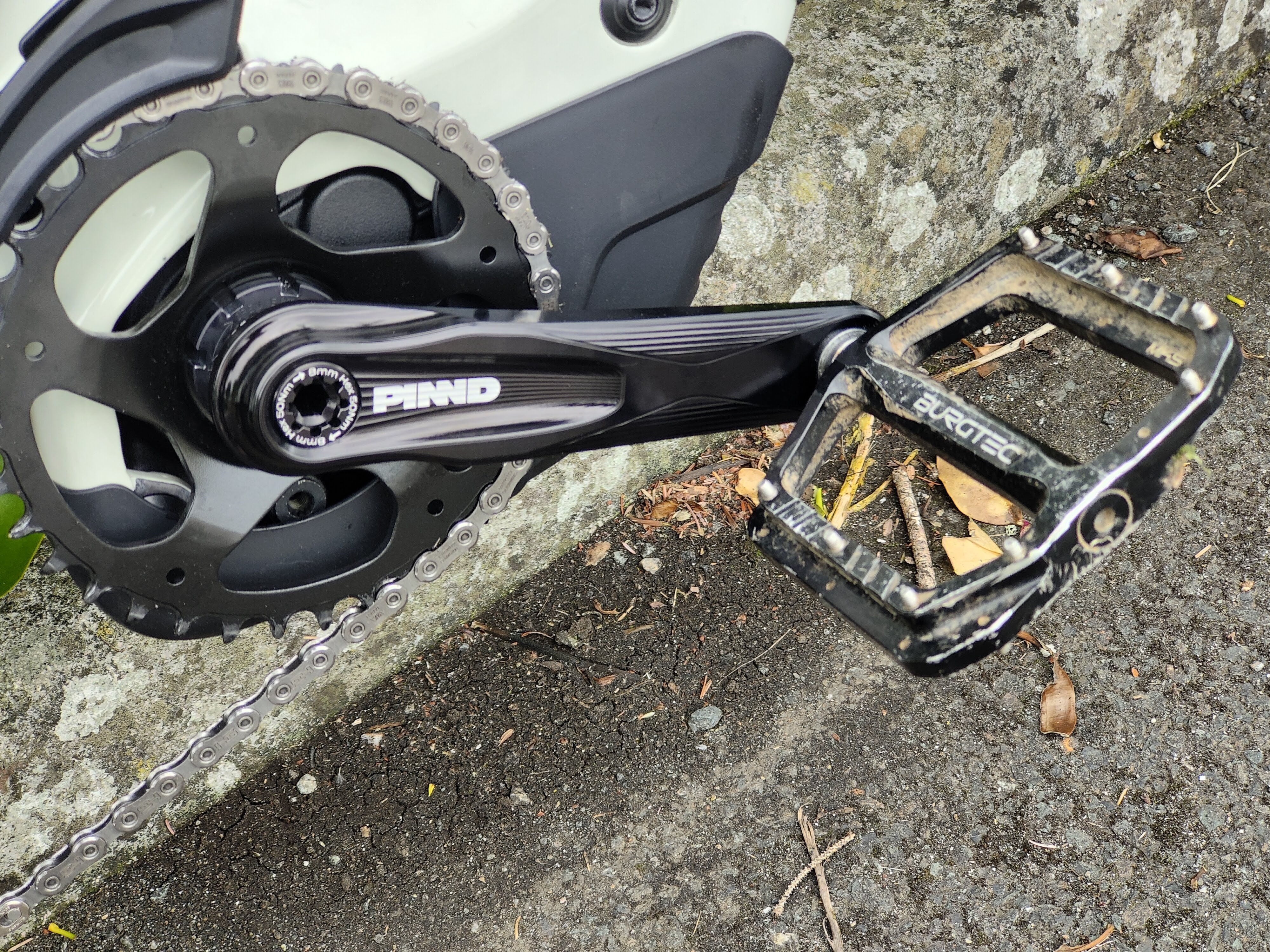

I've gone to short cranks, Pinnd 145mm on Shimano Ep8 motors (from 165mm standard) and find them great - I ride bikepark and local trails (y)
img_8128-jpeg.162114
recent photo, also shows my new Outlier MTB Pendulum pedals 😜
Rich.
