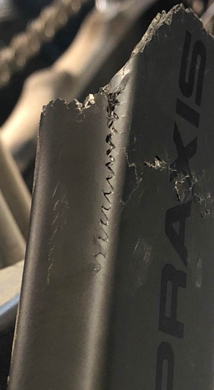

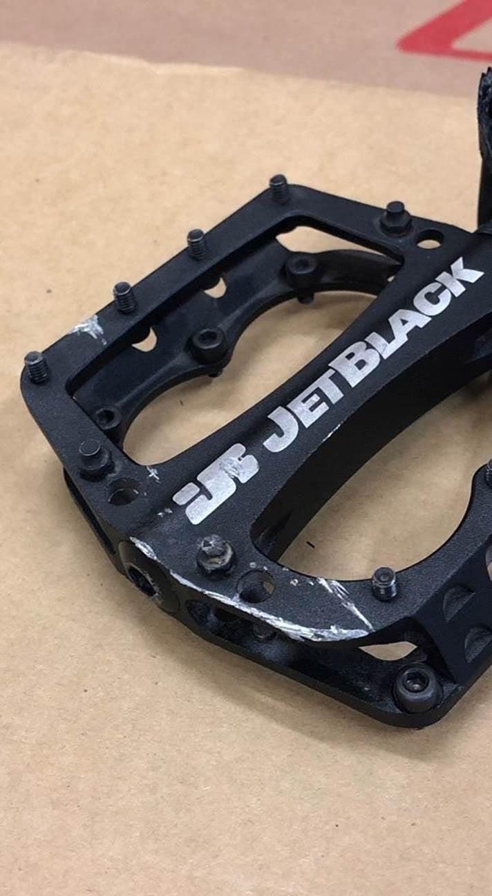

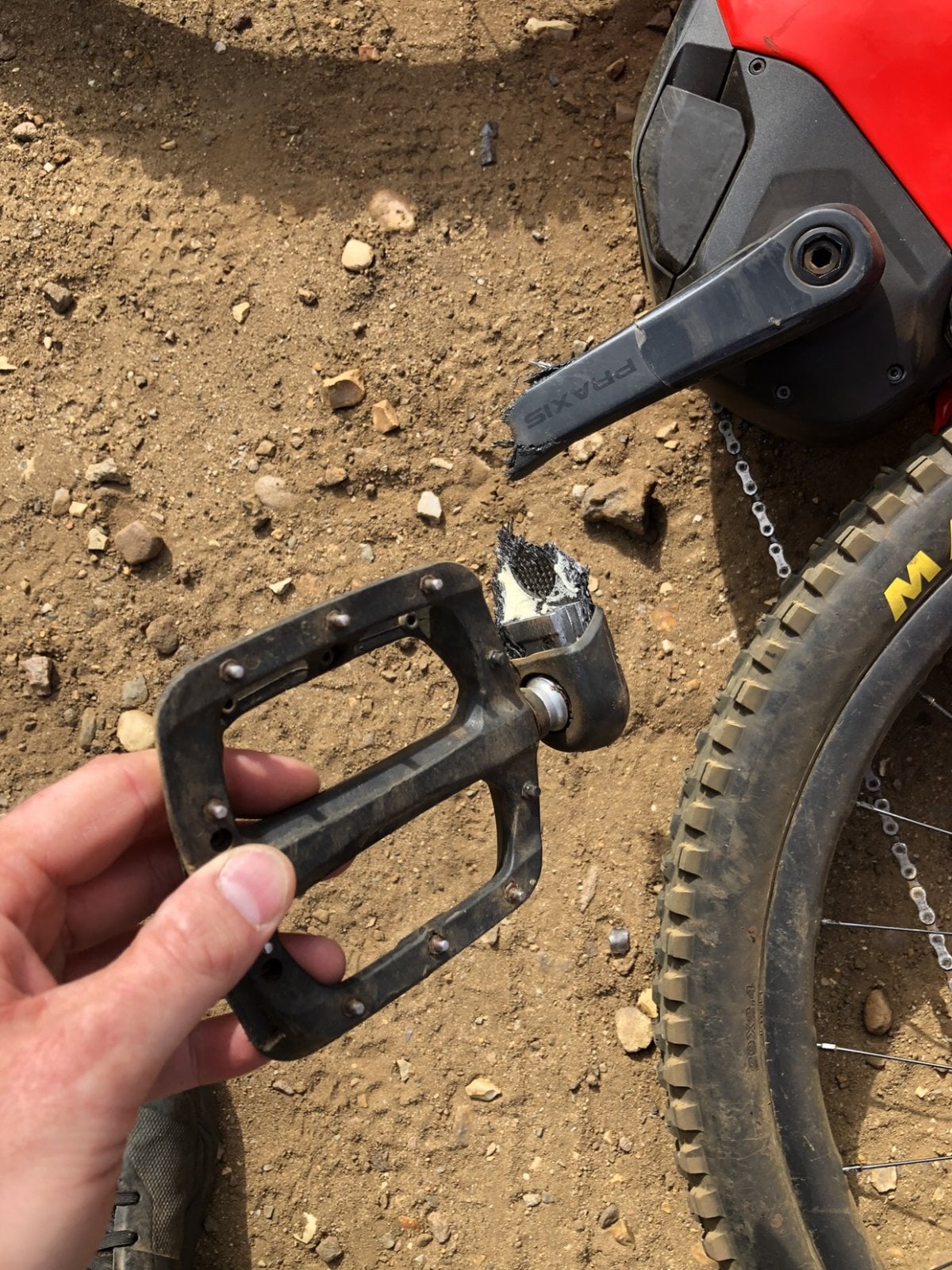

Not sure if you managed to find any but here is my experience. 20 mins of riding from brand new, 2019 s-works. First minor pedal strike.
NSFRACING28
Dec 26, 2018
20
21
BURLEIGH HEADS
Thank you so much and sorry that happened hopefully they give you your money back.
Sadly no, Praxis stated no manufacturing fault. Personally, if that is the case, I cannot see how they can be fit for purpose. I have replaced them with alloy and will not put carbon cranks back on. Pretty poor for a $15,000 bike.

and to add insult to injury (at least financial), when the pedal wasnt there on my next down stroke, I ended up going over the handlebars. In a funny/not funny slow speed crash. The resulting damage to the bike, helmet and smashed Apple watch was way more than the cost of the cranks (Specialized agreed to cover the cost of the Helmet as a goodwill) However, the CSU on the forks was damaged and needed to be replaced. The LBS ordered the new one and when it arrived it was for E-bike specific forks. All good you would think!? But No, the Fox Factory Forks on my 15k bike, although advertised as E-bike specific, and marked on the leg as E-bike specific are actually not. They are the standard ones with 1mm tube thickness. LBS then had to order another one as the internal piston and valving was for the standard leg. So how about a warranty failure if they have decided that E-bike specific forks are necessary? What about premature failure? I will be very interested to hear what Specialized Customer Care comment about that. Anyone else had this?

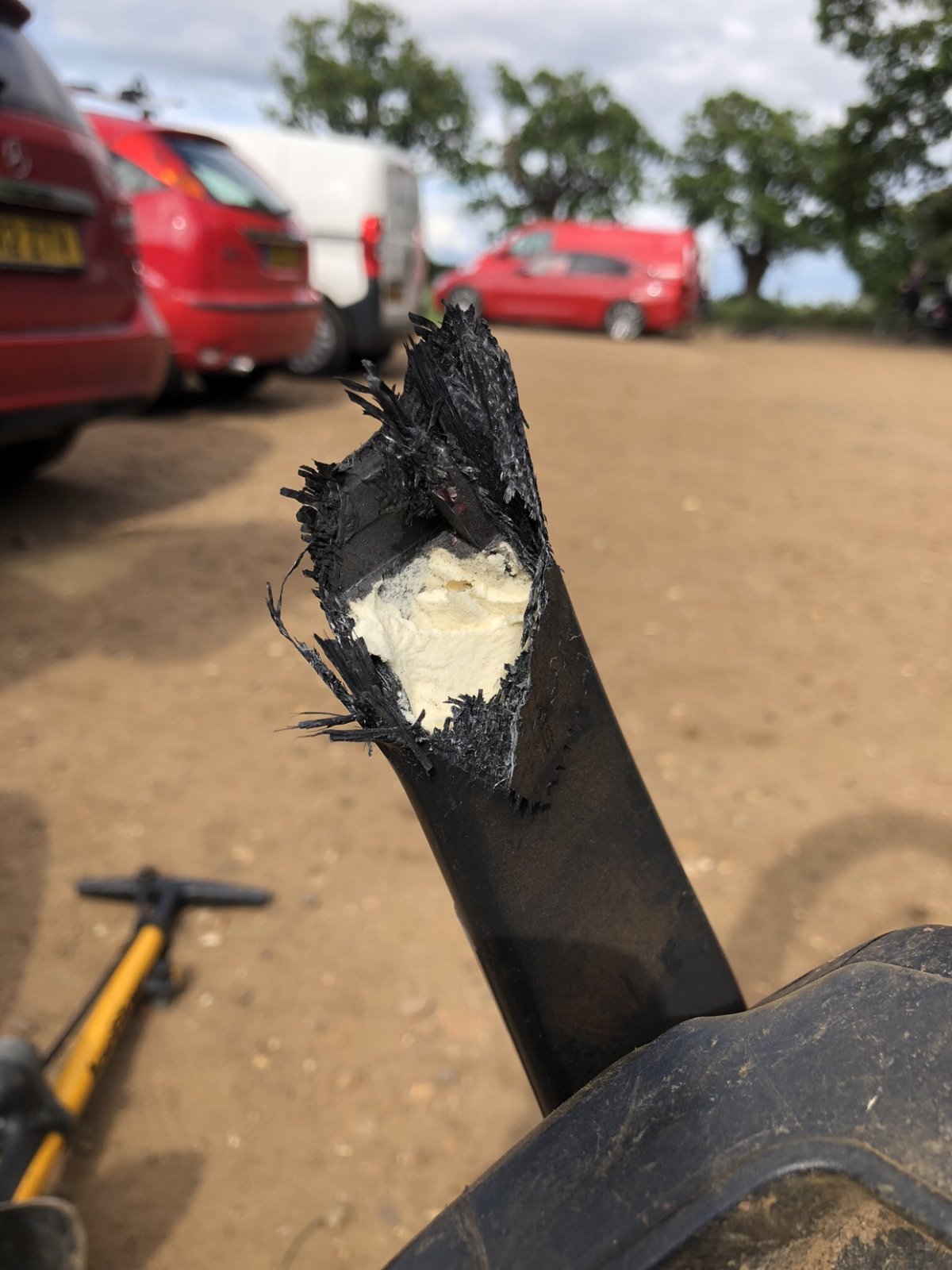

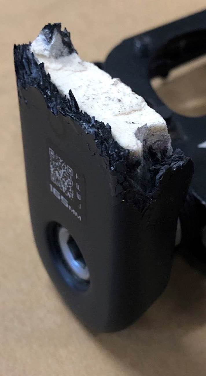

You can make carbon composite more impact resistant by using a biax weave with kevlar but that is hard to lay up other than as a flat surface so usually added to a composite in small vulnerable sections. Strange with the broken crank pics There was no obvious laminate layers almost as if they were moulded using epoxy with micro fibres rather than a composite lay up.

The pics of broken cranks show that they are constructed using a foam core machined to shape then layed up with carbon and epoxy wetted and then vacuum wrapped. I assume the metal parts are bonded in after it is cured. I saw one video of Race Face making carbon cranks and it said they use UD cloth.....ok its the lightest and very stiff but only in one direction and very brittle...it would not be my choice of cloth. The video did not inspire much confidence in carbon cranks for me. About the only real gain is that carbon does not suffer from repetitive stress fatique like ally and it can be lighter. Weight saving on a small component is marginal however. Carbon has nowhere near the same impact resistance as ally. Ally will deform/dent, carbon snaps. Any impact that fractures the weave can be invisible but will lead to failure. Not for me!
