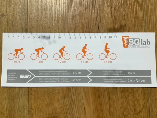

  4. Already own an SQlb saddle where I was measured by the lbs. Remeasured and added a couple of 3 cm as per the 602 instructions. Sometimes wish I had gone another size up?

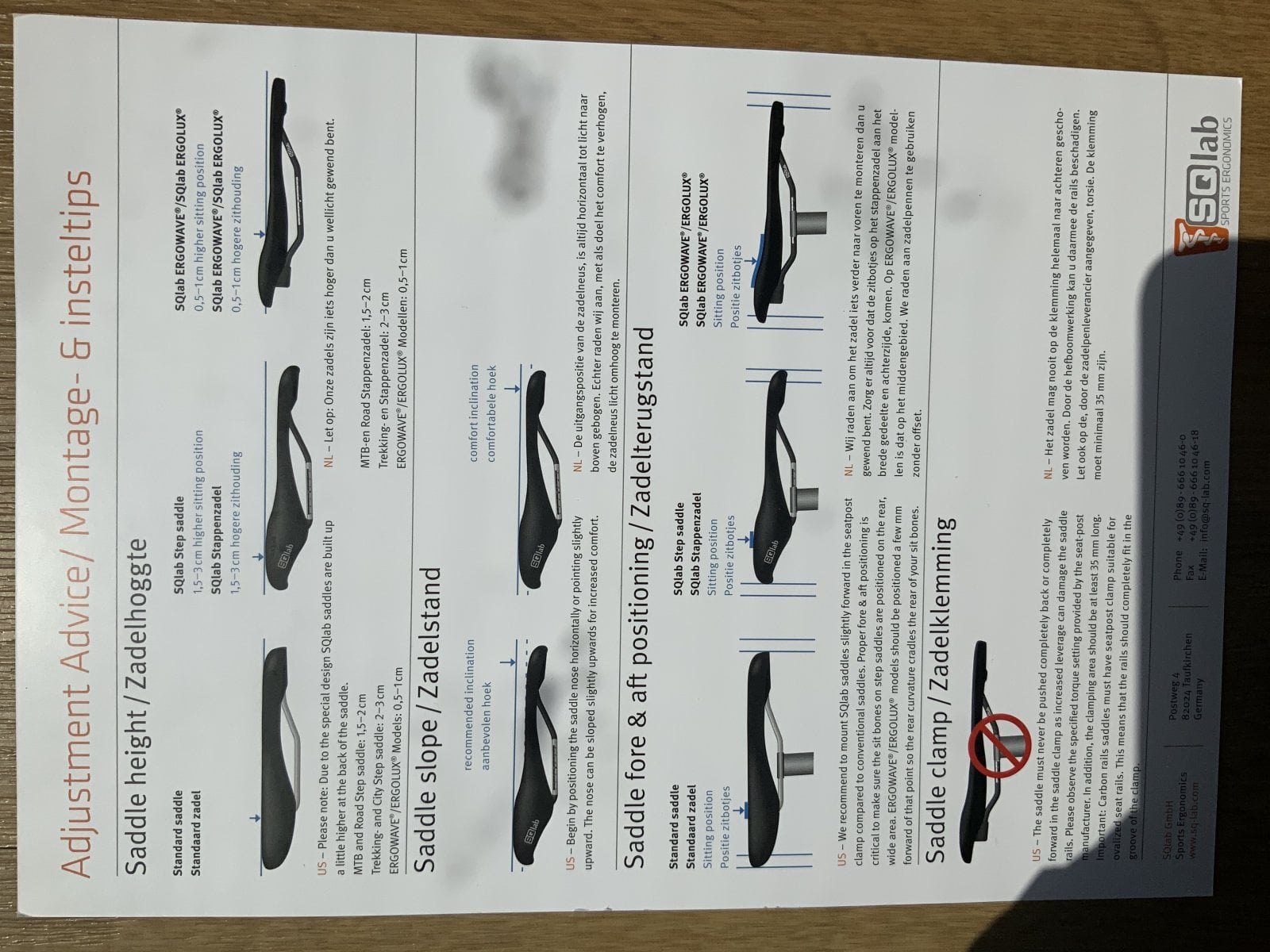

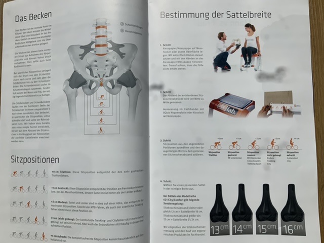

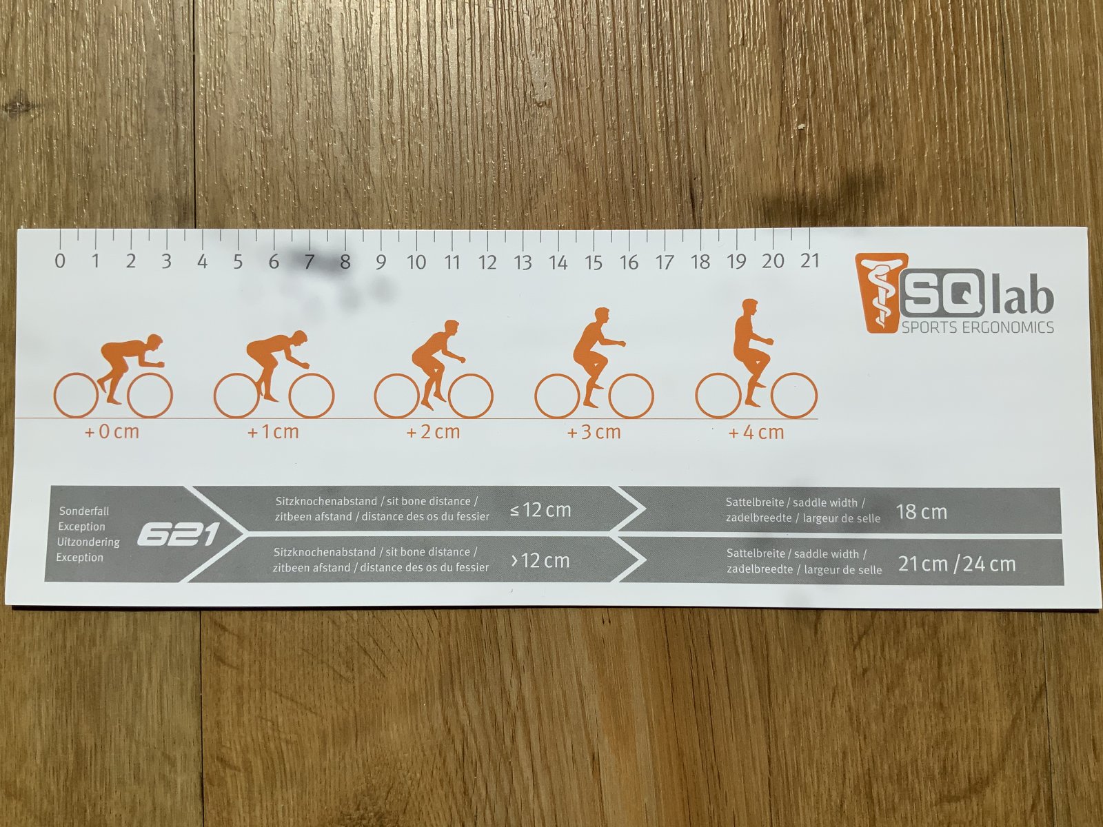

Attached are a couple bits and pieces from the marketing material that arrived with the saddle. May be helpful to those looking to size their butts!

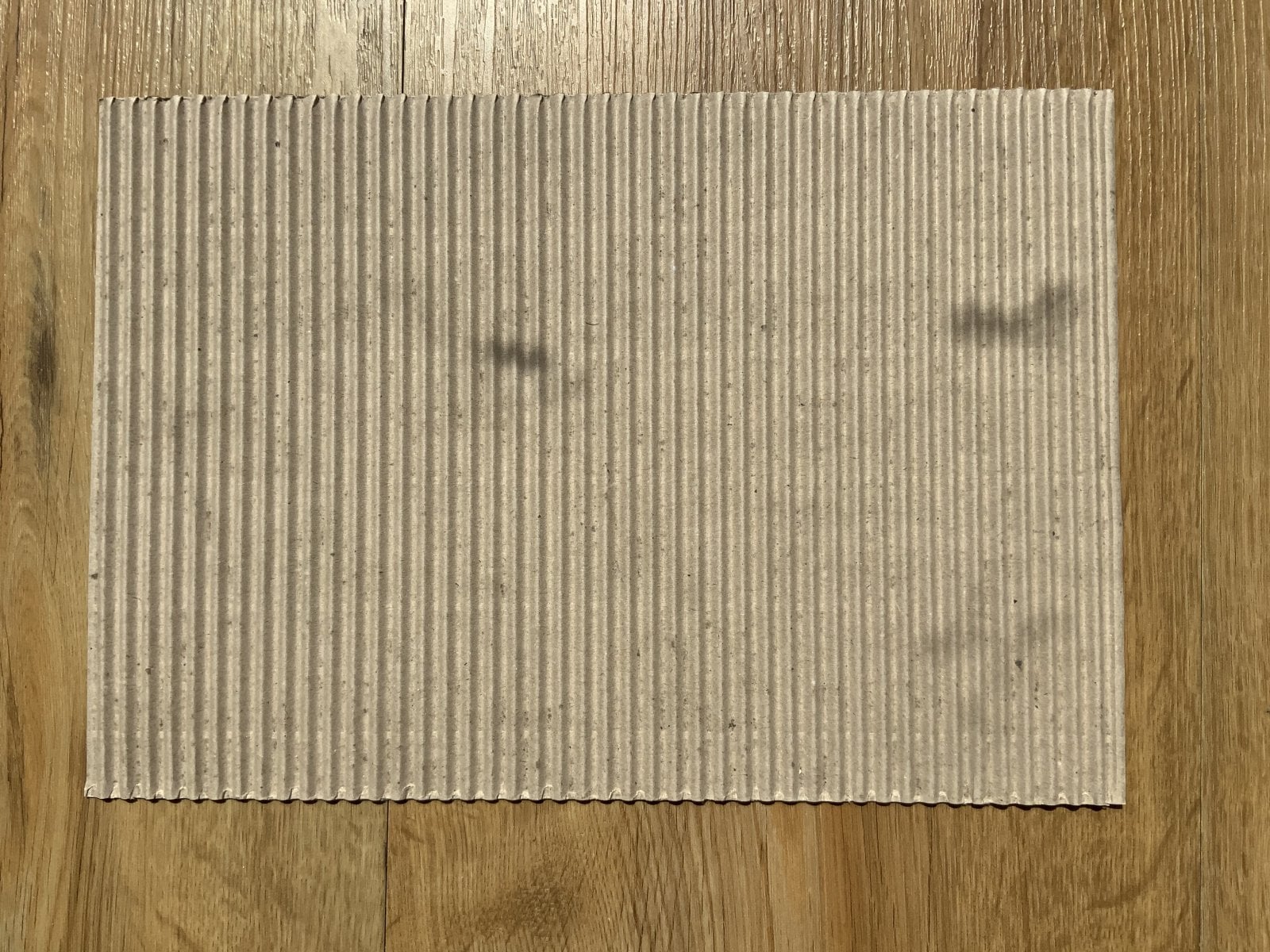

The corrugated cardboard is a great aid for making a butt template prior to measuring.
Failing all of that, do what I did and place the palms of your hands on a bench (knees at 90degree ish)and then sit on the back of your hands moving them accordingly until the thumbs find the sit bones. Then ask her in doors to measure the distance of the thumbs. A bit heath Robinson but I found this method rather accurate especially as I did not realise at the time that the original SQlabs saddle had the saddle size clearly marked on a clothing tab stitched to the side of the saddle!

With the sizing, did you order as per the advice on the site? My sit bones are 9.5cm, which means even the 13cm 610 would be a little big and the 14cm (smallest) 602 even bigger.
That would be surprising. If they are though, then you should be looking at saddles for children; they would get down to that size. You might find a good quality bmx saddle for example.

I used the sitting on card method to measure my sit bone twice to be sure, and it came up the same both times. Looking at the SQ site, ir recommended a 14cm and Ergon the Ergon site S/M.
