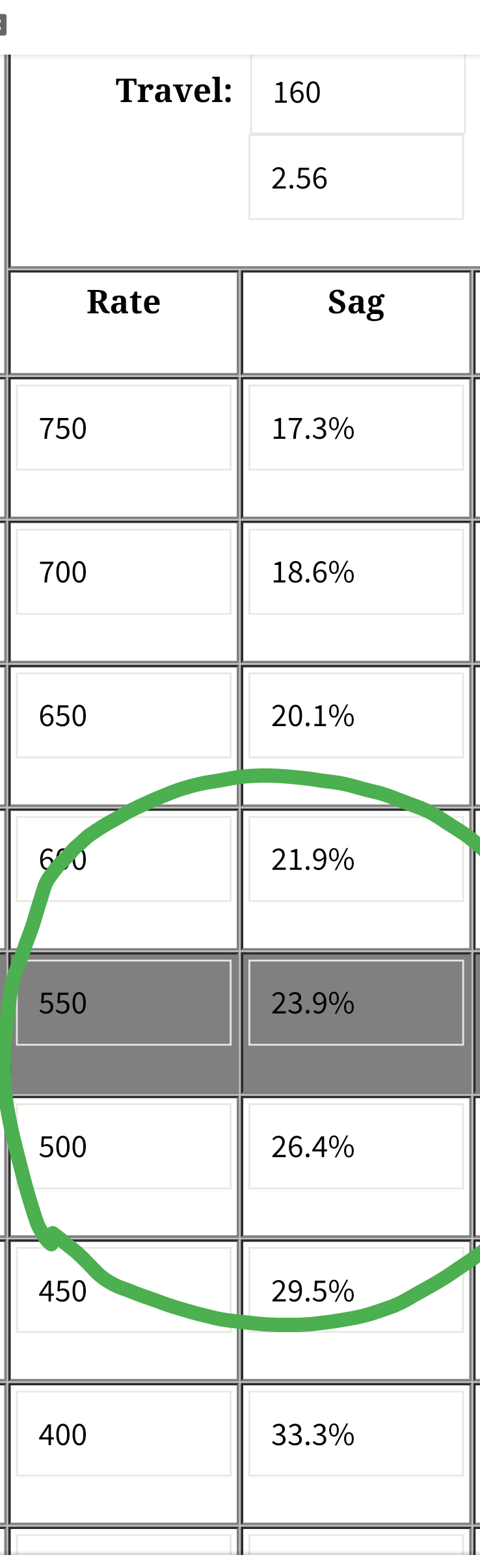

@monty1991 what is your Sag target? Did I miss this? Sag is key to estimate the appropriate spring rate.
MRP suggest 550lbs to achieve 24% sag with your settings.
RiderOnTheStorm
@monty1991 ok, so in that case, MRP would suggest ~450lbs to achieve your 30% sag objective.
When fitting my coil shock, I used the MRP calculator to get a ballpark spring weight which happened to match my sag target.
To fine tune the sag , you can play with the Preload adjustement ring e.g add one turn (but don't go over the max turns allowed).
I also "invested" in additional coils (+50lbs, -50lbs) for more flexibility when I go for longer rides (carrying heavier weight) or just want to adjust sag (at coil level) based on the terrain I'll be riding on. ;)
