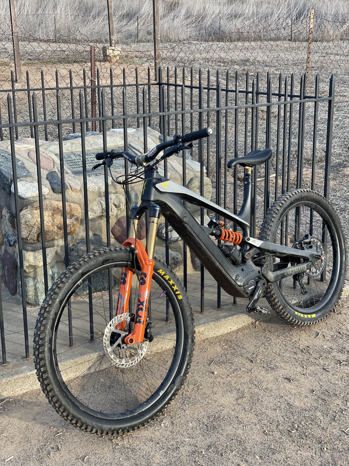

I just put a Push 11.6 on my Decoy CF Pro. Great upgrade. Now, how about that Fox 36 which I seem to have destroyed...

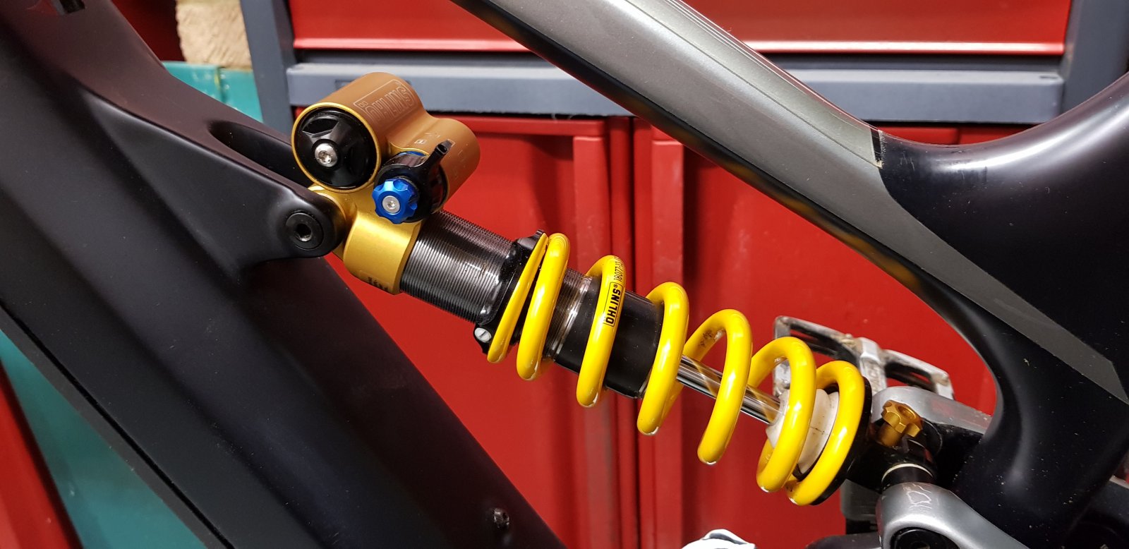

Sapientiea
Jul 12, 2019
296
192
Netherlands
Yeah the Ohlins TTX is on the bike. First (flat :( ) ride yesterday. Might be wishful thinking but I could feel much more support, like it was not sagging so much. Cannot fully explain it yet, have to ride more. Increments of the dials are very noticeable. Just one click and you feel the difference. Unlike anything I have experienced so far. So much looking forward trowing it of a mountain now :). Pic coming later

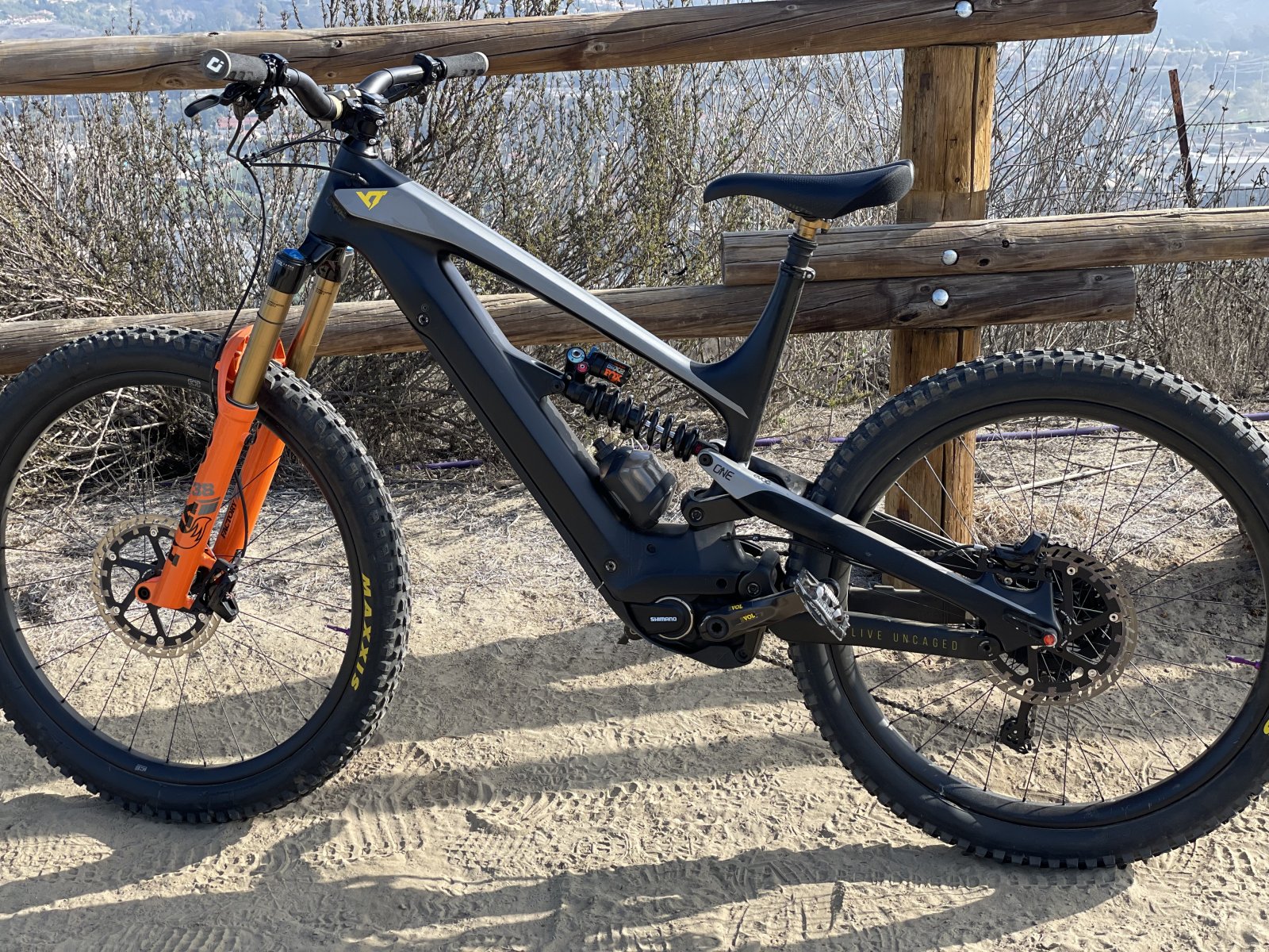

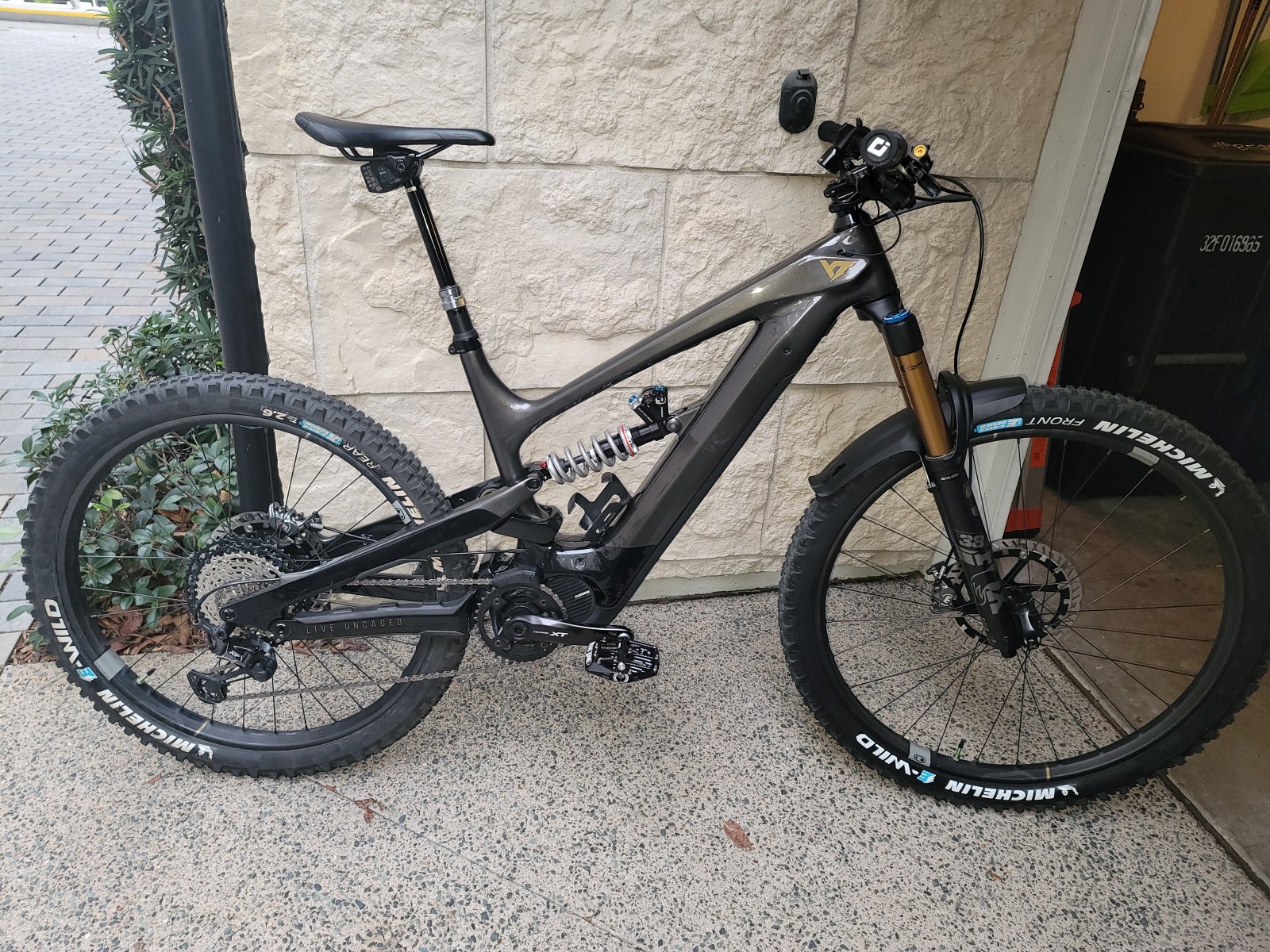

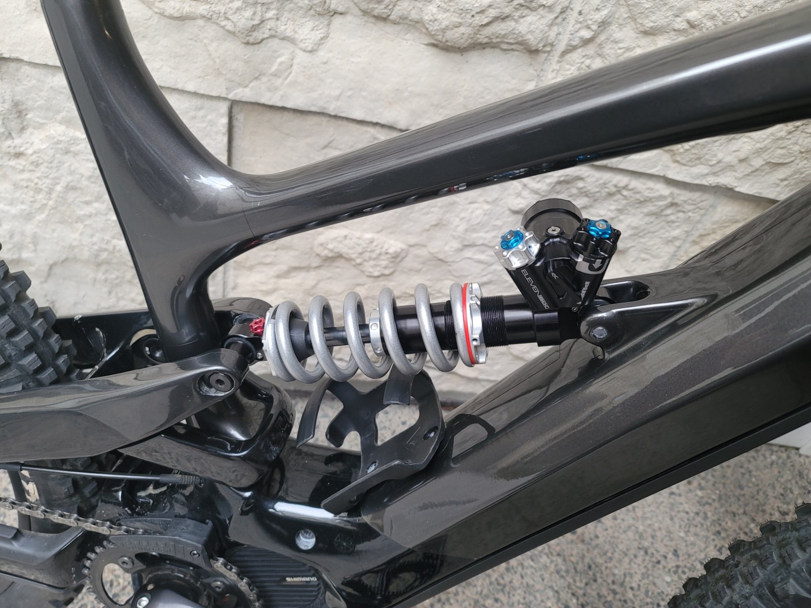

Decoy Elite, couldn't ever imagine riding it without coil anymore :love:

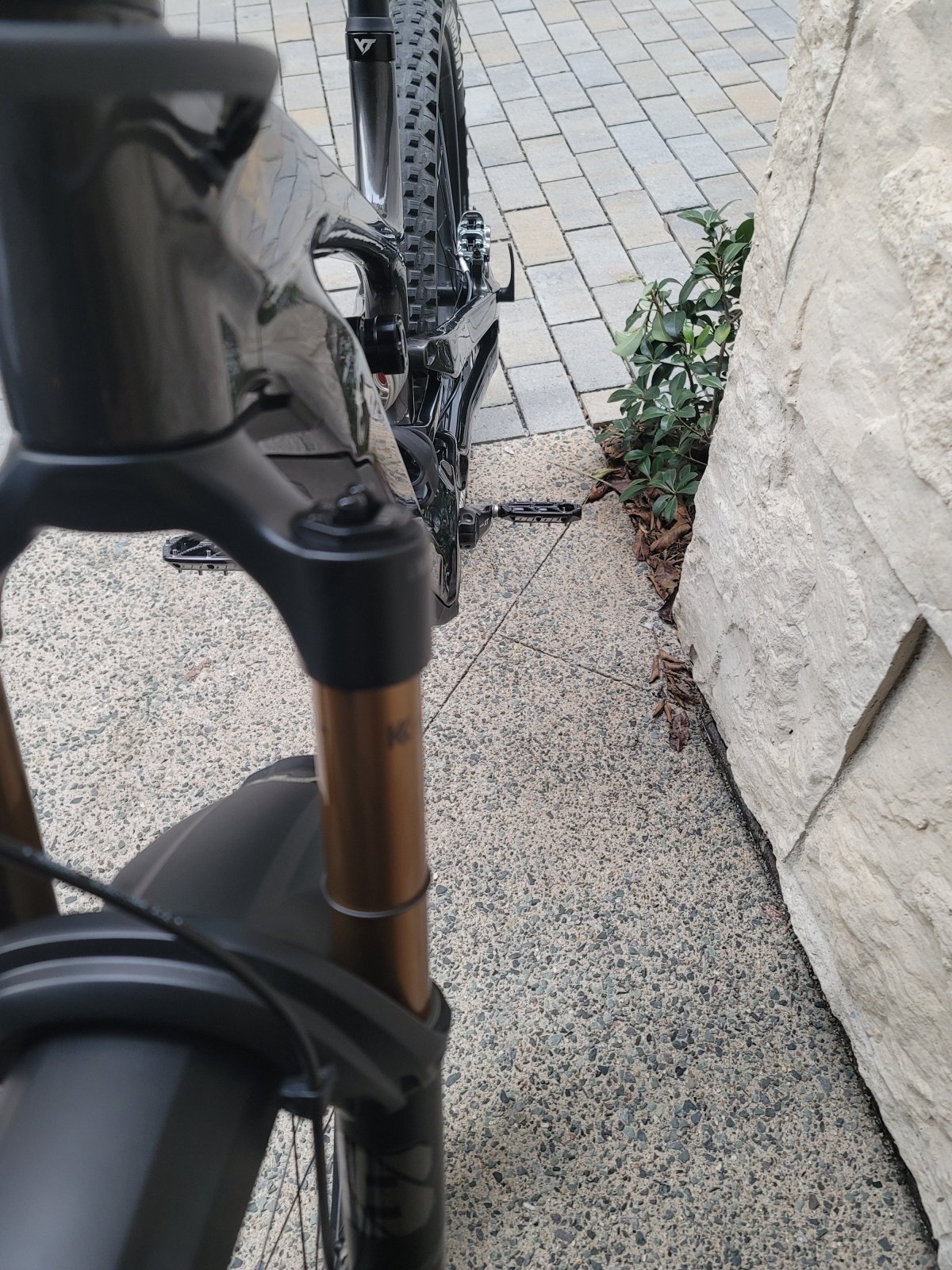

Have a Decoy Elite and want to upgrade to a coil shock as well. Thinking of going with the same model Push you are using. Not a big jumper or rock garden rider any more. How does it handle small bumps and rutted trails? Also been riding Michelin E-Wild's on my Elite which I really like. Noticed your tire combination. How do you like them? My Decoy is set up more as a dh rig so not worried about climbing characteristics. Any input would be appreciated!
GSuperstar
Feb 24, 2021
United Kingdom
The best way to describe it is like running on a mattress. I had a 2021 DHX2 prior and loved that shock, then got this and it's blown it out the water. However that could just be because it's perfectly set-up for the suspension curve etc of the Decoy.
It has 2 settings, I have one for full blown DH which I ride most, and one for trail riding. Both feel completely different but amazing on all scenarios. I rode BPW last week in the wet, mostly woods and the technicals and it just stuck to the ground, very confidence inspiring!
I never got along with the E-wilds, not sure I gave them enough time maybe as others seem to rate them high. I'm running Magic Mary upfront and Big Betty rear, definitely slower rolling than my Summer Setup (Assegai / Aggressor), but rode all of North Wales in wetttt conditions and they were awesome on everything. Grippy on climbs, and definitely good for the downs. I know some run this combo all year round so going to see how they feel when it dries up, as I really did like my Maxxis combo :)
No mine are full Shimano Saint. 220mm upfront and 200 rear :)
Thanks for the feedback! Will go with coil shock and give the Magic Mary/Big Betty combo once my E-Wilds wear out. Please share feedback on how you like them when it dries up in your area.

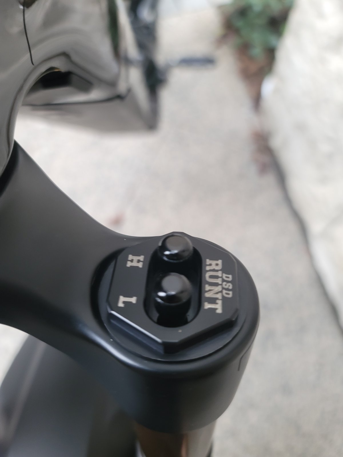

So after getting some nice technical dh rides in along with some more All-Mountain & choppy rides, VERY happy with the ride quality and feel of my Decoy. Played around with various psi settings on the DSD RUNT I installed same time as Push ELEVENSIX coil and feel totally spoiled with how well the bike performs. The Runt is legit with the High & Low air chambers and it really compliments the rear coil shock. Been really liking my new Yeti 160e, but the confidence I feel and performance of the upgraded Decoy is hard to beat. So far, left the original Push setting that were based on the input I provided to them. Think I will leave the standard factory fork/shock on the Yeti since I use it more as a trail/all-mount rig. Hoping YT provides a bigger battery option on next gen Decoy but I don't forsee my duck leaving the stable for quite sometime. Appreciate all the feedback and comments frim fellow Decoy/coil shock rider's!
