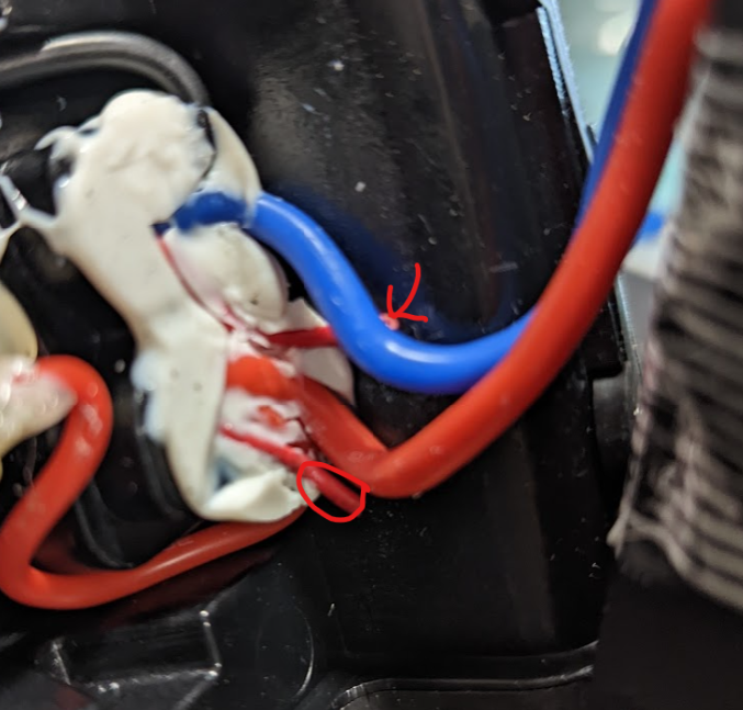

So you mean the part underneath the battery where 3 cables come out of some white rubbish like in this pic at the bottom? And do you know if the voltage shown in the Besst Tool would then be too less to bring the display back on and that this might be the problem?

The two smaller red wires were connected to the gold POGO pins, cut each wire and then take the ends from the BMS and tie them together (solder and heatshrink). The battery will be always ON, but will not suffer as much with water making the switch useless.
There are 4 screws on the outer case on the dock end of the battery, unscrew them and then you should be able to carefully pull away the plastic body with the high current connectors.
This has to be done inside the battery right? Or do you mean the part underneath the battery itself.
In the battery itself

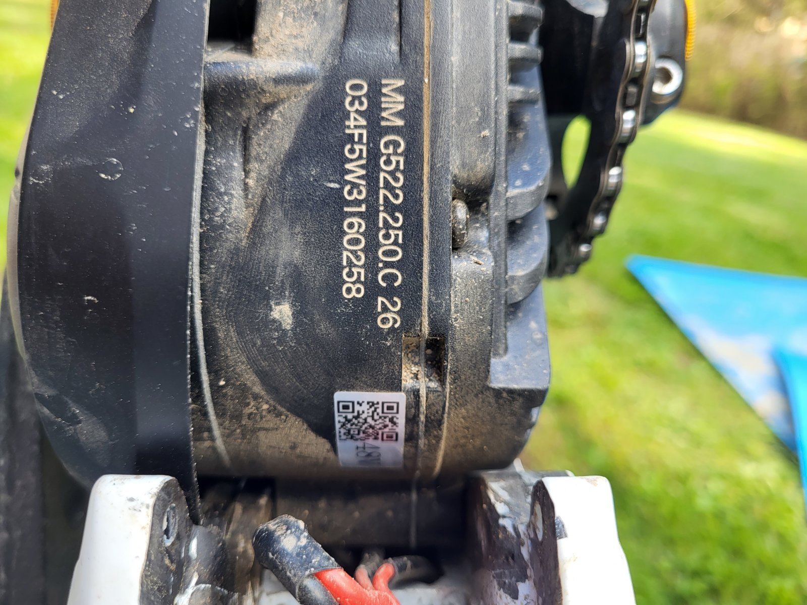

I've had my Cheeb for a few months now and loving it. However, I've got an issue that is driving me mad!
Over time, the M600 motor has developed a really annoying 'slipping' issue. If I stop pedaling, whether from stopping or coasting, when I begin to pedal, the cranks do not immediately engage and they rotate 180 (sometimes 360) before engaging the chainring to drive the rear wheel. It's rather dangerous because it has caught me out a few times when I need to apply pedal power and it simply slips making my legs exert force with no resistance - it also makes me look like a bit of a tool. I've opened the motor and had a good look around. Everything appears to be in perfect shape. No wear to the gearing, nothing wrong with the electrics from what I can see. I regreased everything and put it all back together and for a couple of rides, it was perfect. However, it has now begun to 'slip' again. I'm not sure what to do. It's almost like there is a clutch that isn't working correctly. I know they don't have clutches but there is definitely something going on that's not allowing the pedals to drive the chainring. It's very intermittent too. It can slip when hardly any pressure is applied to the pedals or it can happen when a lot of pressure is applied - it makes no difference. The bike is a lot of fun but this issue is tarnishing it somewhat. Any suggestions would be appreciated! Many thanks

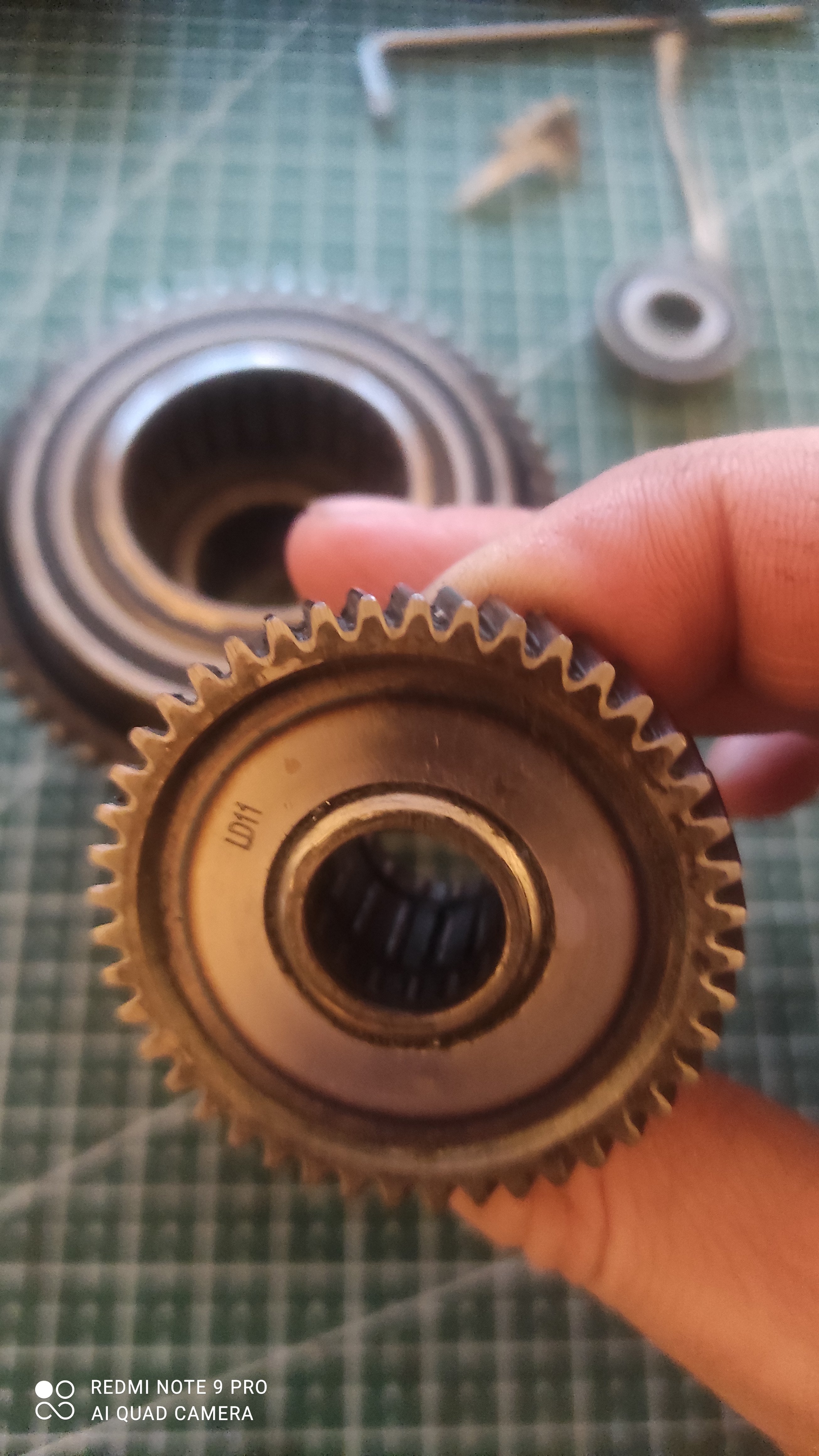

Its the one way clutch needle roller bearing inside the motor. Have had an issue with mine.
you will need a new part from bafang as no other manufacturer akes one to these dimensions to my knowledge.
its a lengthy process I had to get mine through DENGFU where the package came from.
It took 3 months to arrive and was the the wrong part so took another 3 months before I received the correct part!!!!! You get the whole unit in the second photo.
Or if your lucky i’m not my mate received a complete motor. But his failed from new, mine was nine months old.

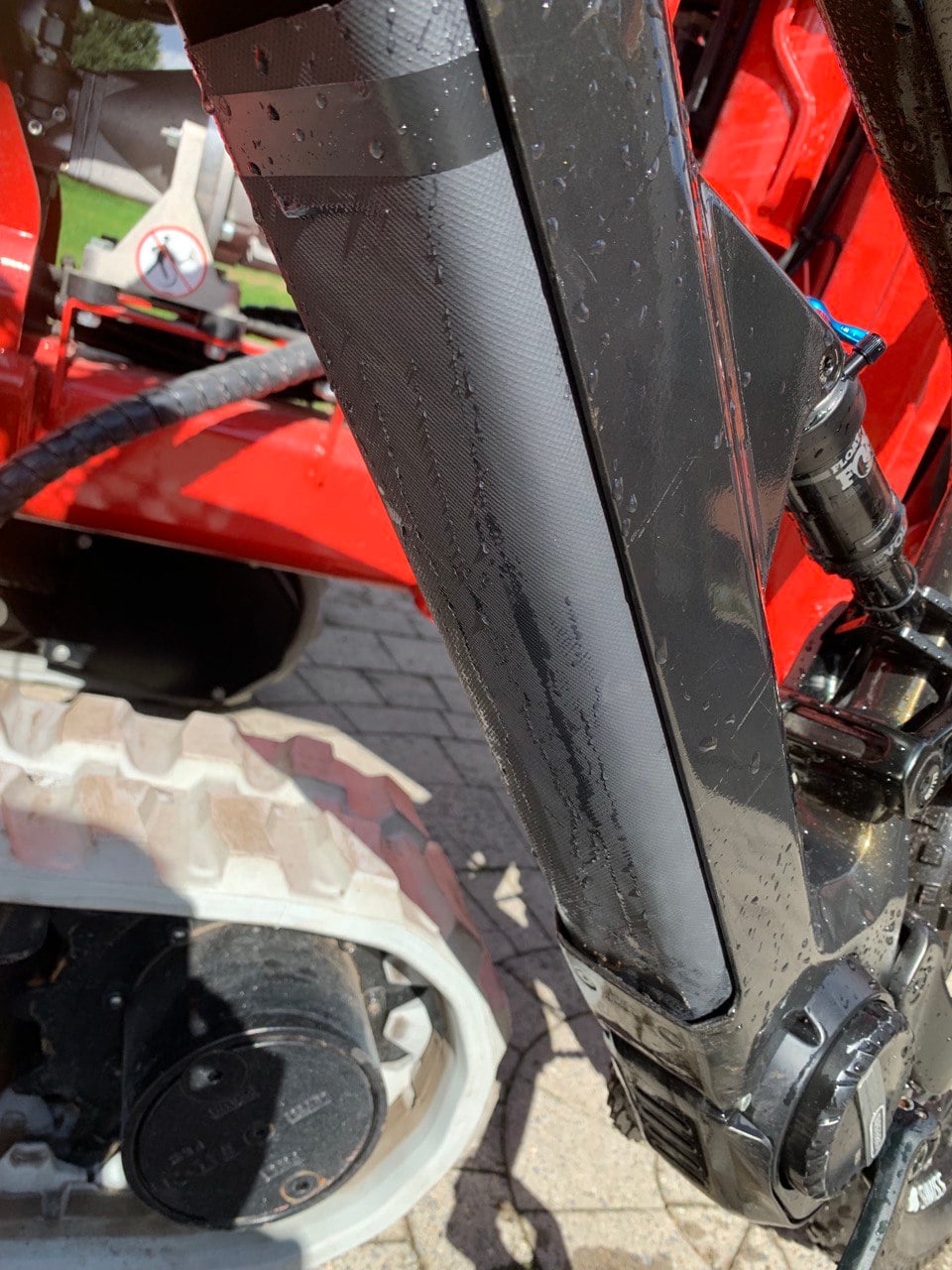

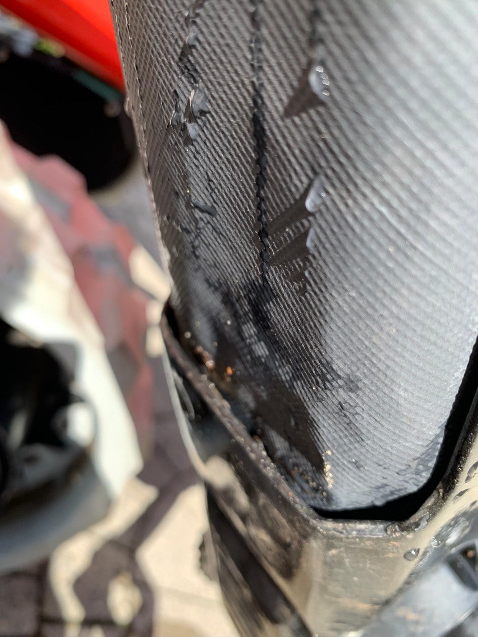

After the dry summer, I ran into problems after my 1st wet run with the Cheeb.
Water is ingressing through the battery cover and causing all kinds of weird behaviour, so decided to come up with a more permanent solution.
Got some sheet of roof foil which I fixed underneath the battery connector, screws are holding it in place.
The foil is wrapped around the battery and kept in place with a piece of tape, this way I can still remove the battery.
On the pictures you can see the results after cleaning the bike, water is now NOT getting to the connectors.
I do not remove the battery after my rides, nor do I have a on/off switch. Battery is keeping the load (100%) when not used, even after multiple days.

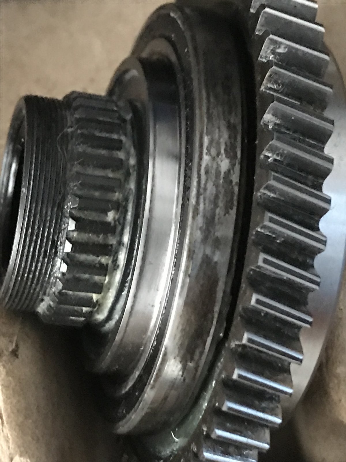

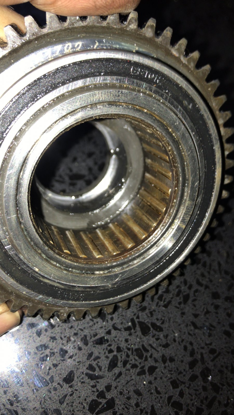

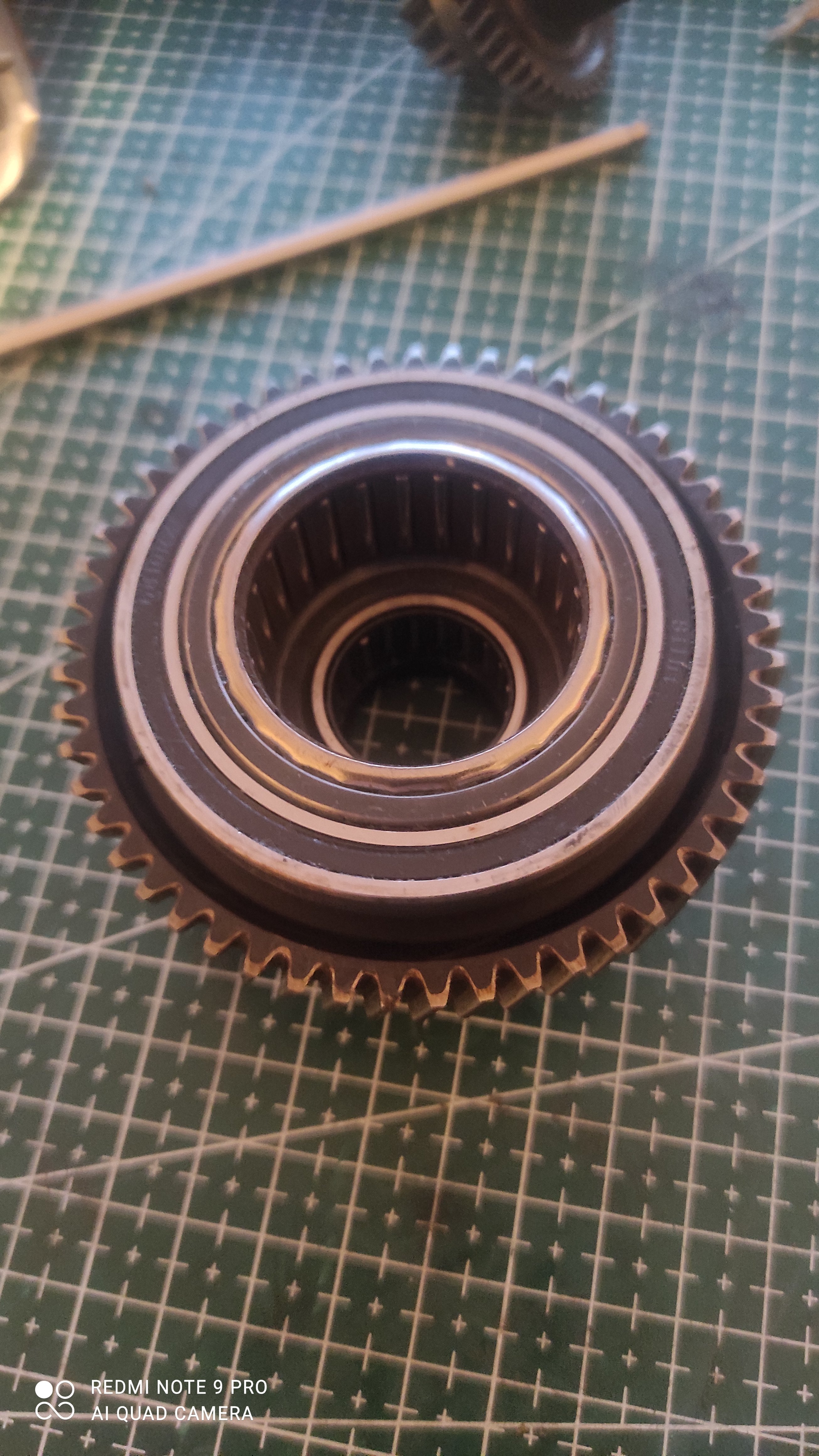

I have a mechanical issue with my m510 motor. Perhaps somebody has encountered something similar or has enough knowledge to make a good guess.
It started with the motor producing some grinding sound when you just start pedal and then you would here something click in to its place and the motor went working normally. With time it's gotten progressively worse.
And today it got even worse as it doesn't grind anymore but instead the motor just whines(see link with video) in vain on high revs and no assistance is being applied. The cranks do turn normally with the chainring though. The motor is now just stuck in that state..
Initially my main assumption was that it's the problem inside the one way bearing in the crankshaft gear. I have changed it to an identical from my old m500 but this didn't resolve the issue. In fact the motor is now broken with the replacement gear. I am now having doubts about my first assumption. if the clutch bearing would slide around the crankshaft without engaging that would also mean that it wouldn't engage when I am pushing on the cranks. In other words the cranks would turn without turning the chainring(it's attached to the main gear)
Video where you can listen to the noise :
However there's no engagement issue there. So maybe the problem lies else where? Any ideas will be appreciated.
Update and resolution:
Patdam suggested me in DM that the motor should have 2 one-way bearings And this helped me to understand the problem. In fact the main gear sprag bearing is fine and is not the cause(photo1). The culprit was the second sprag bearing located in the middle cog(photo2). If you look closely you will see the sprag bearing in the middle.
In fact I wasn't aware that it existed until I've opened the motor again today and started looking for it...
I have then replaced it using a spare part from my m500.
So the good news is that all 3 gears if m500 and 510 are identical. Hope this might be useful to someone one day.
