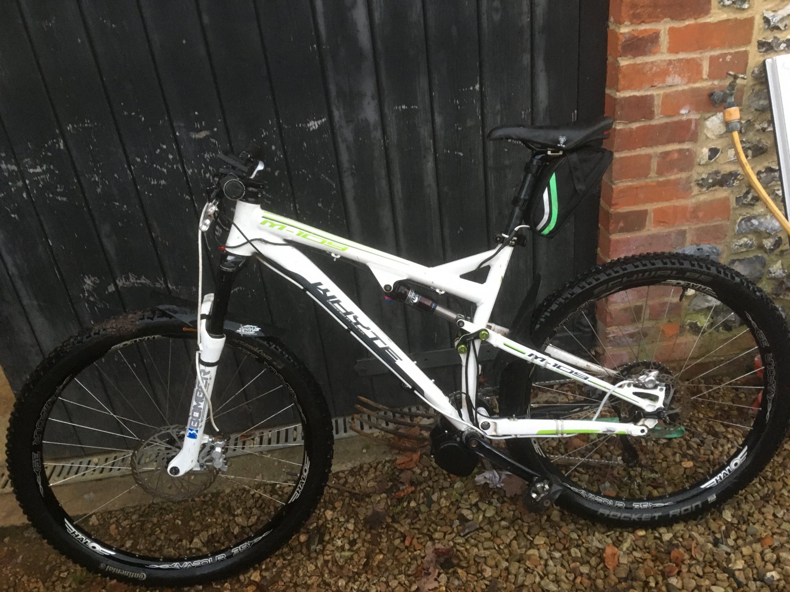

If going secondhand and low budget I'd suggest looking for a good condition 26" FS mtb for around £500 and a DIY motor for around £700.
it'll be way more reliable than any S/H Ebike for the same outlay and you'll have a warranty on the motor and battery.

Gary is right, a second hand full sus regular mountain bike plus a new e bike kit is the way forward if on a really tight budget.

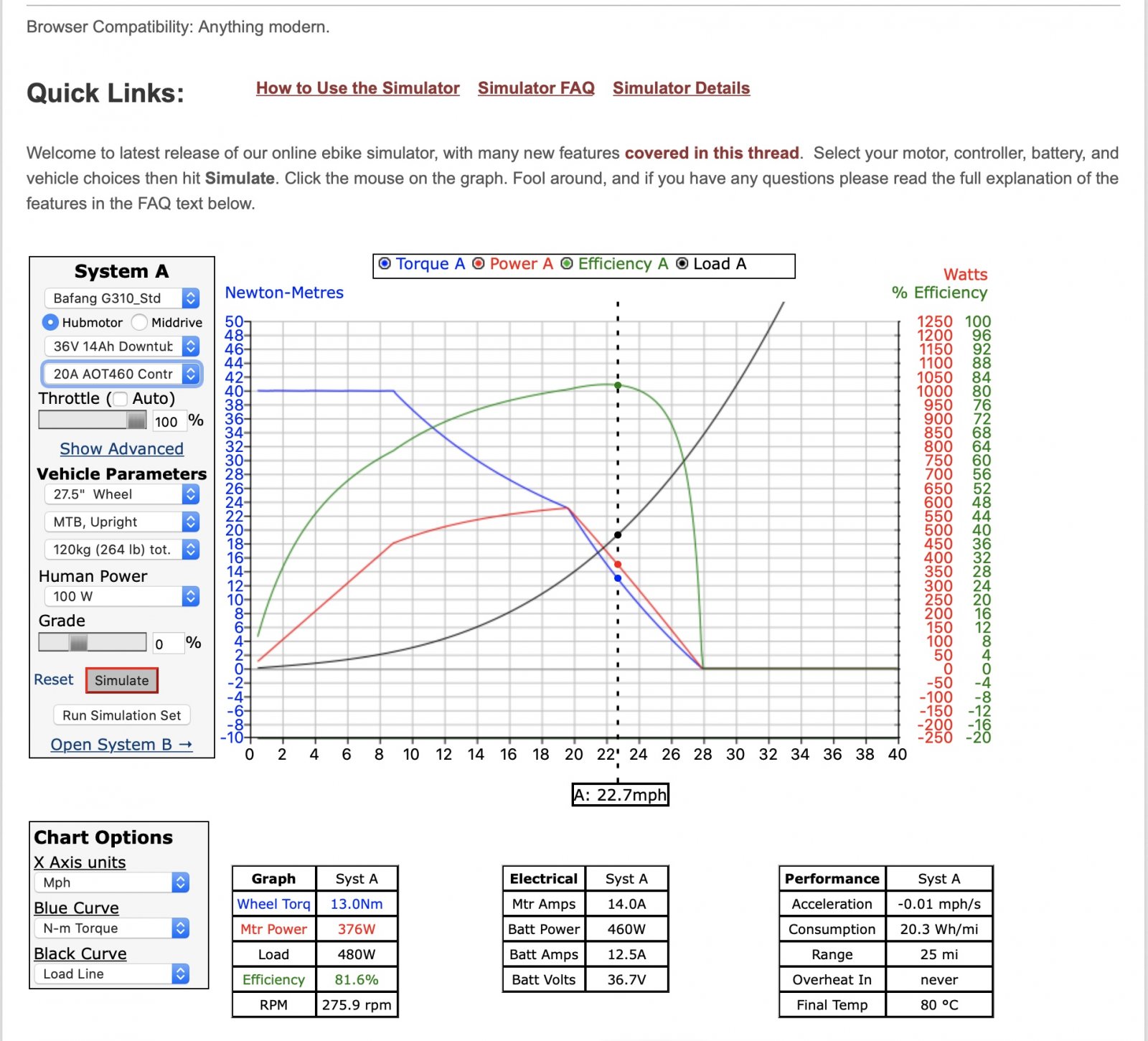

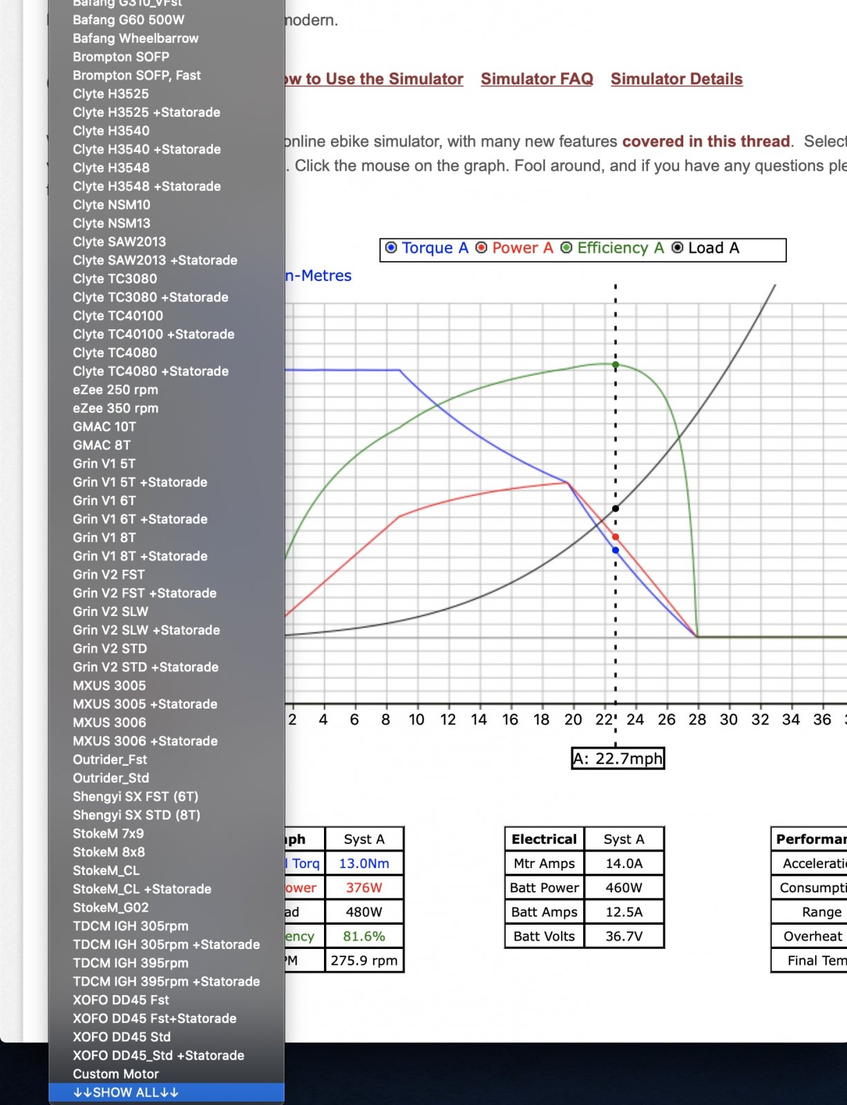

Also have a look at Grin's extra special motor, charge & trip simulators in their Tools section.
In this case have a look at their motor simulator especially the Bafang G310 & GMAC motors. Input your weight added to total weight of your bike, wheel size (maybe 27.5), MTB upright, battery voltage (maybe 36V), controller (maybe 20A) then play around with various Human power & grade (as in steepness of gradient) then hit Simulate.
It'll plot torque, power efficiency, load, speed at max efficiency, time to overheat, range & so much more. It'll help you decide what's best for you. Also in the motor drop down, scroll to the bottom & hit SHOW ALL to display a huge range of motors.
Motor Simulator - Tools
