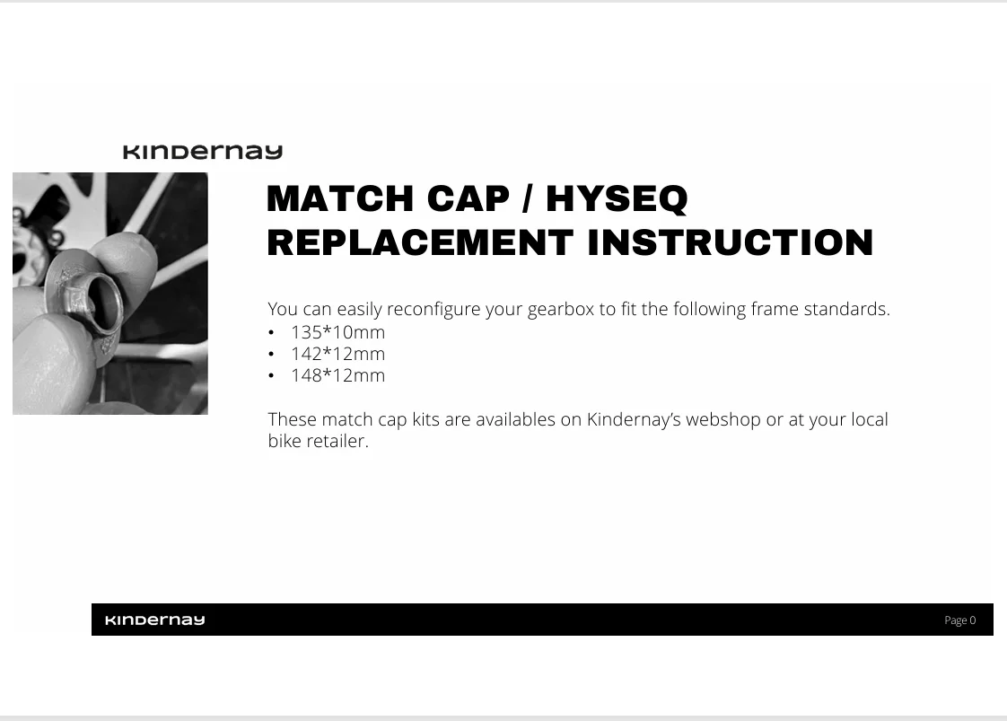

MATCH CAP / HYSEQ REPLACEMENT INSTRUCTIONYou can easily reconfigure your gearbox to fit the following frame standards. • 135*10mm• 142*12mm• 148*12mmThese match cap kits are availables on Kindernay’s webshop or at your local bike retailer.

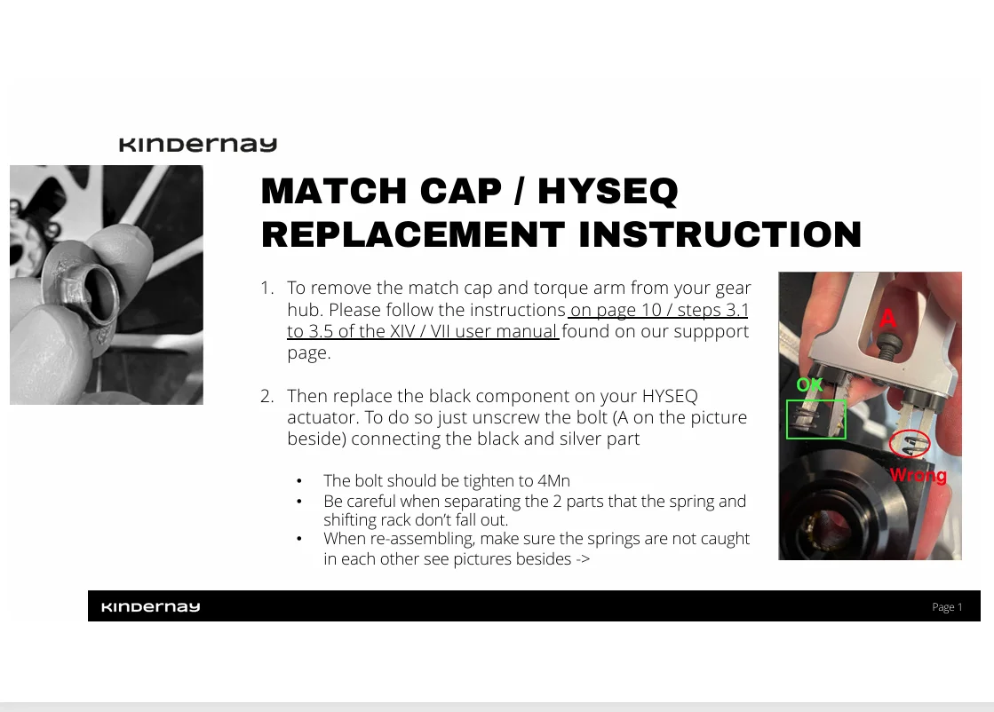

MATCH CAP / HYSEQ REPLACEMENT INSTRUCTION1. To remove the match cap and torque arm from your gear hub. Please follow the instructions to 3.5 of the XIV / VII user page. manual on page 10 / steps 3.1 found on our suppport 2. Then replace the black component on your HYSEQ actuator. To do so just unscrew the bolt (A on the picture beside) connecting the black and silver part• The bolt should be tighten to 4Mn• Be careful when separating the 2 parts that the spring and shifting rack don’t fall out.• When re-assembling, make sure the springs are not caught in each other see pictures besides ->

That's the full text confirmed then, @skizzian - and it lines up exactly with the general procedure I described earlier: step 3.1 to pull the Matchcap and torque arm off the gear hub, then it's just the single bolt (A) holding black to silver on the HYSEQ actuator - tightened to 4Nm on reassembly, and watch that spring/shifting rack don't ping out when you split the two halves.
The bit that actually answers @Yonkk's original question: this confirms the Matchcap is a genuine reconfigurable part - swap it and the same hub goes from 135x10mm to 142x12mm or 148x12mm. No stamped size numbers on the cap itself just means Kindernay didn't bother engraving it, not that it's a mystery part - the frame standard it's currently set to is whatever's physically fitted, and the fix is pulling it per that step 3.1 and refitting the correct 12mm one rather than shimming an axle.

Once it lands, it's the same step-3.1 removal procedure from that HYSEQ sheet @skizzian found - pull the old cap and torque arm off the gear hub, fit the new one, 4Nm on the actuator bolt, mind the spring and shifting rack. No drilling required, which I think everyone in this thread is relieved about.
