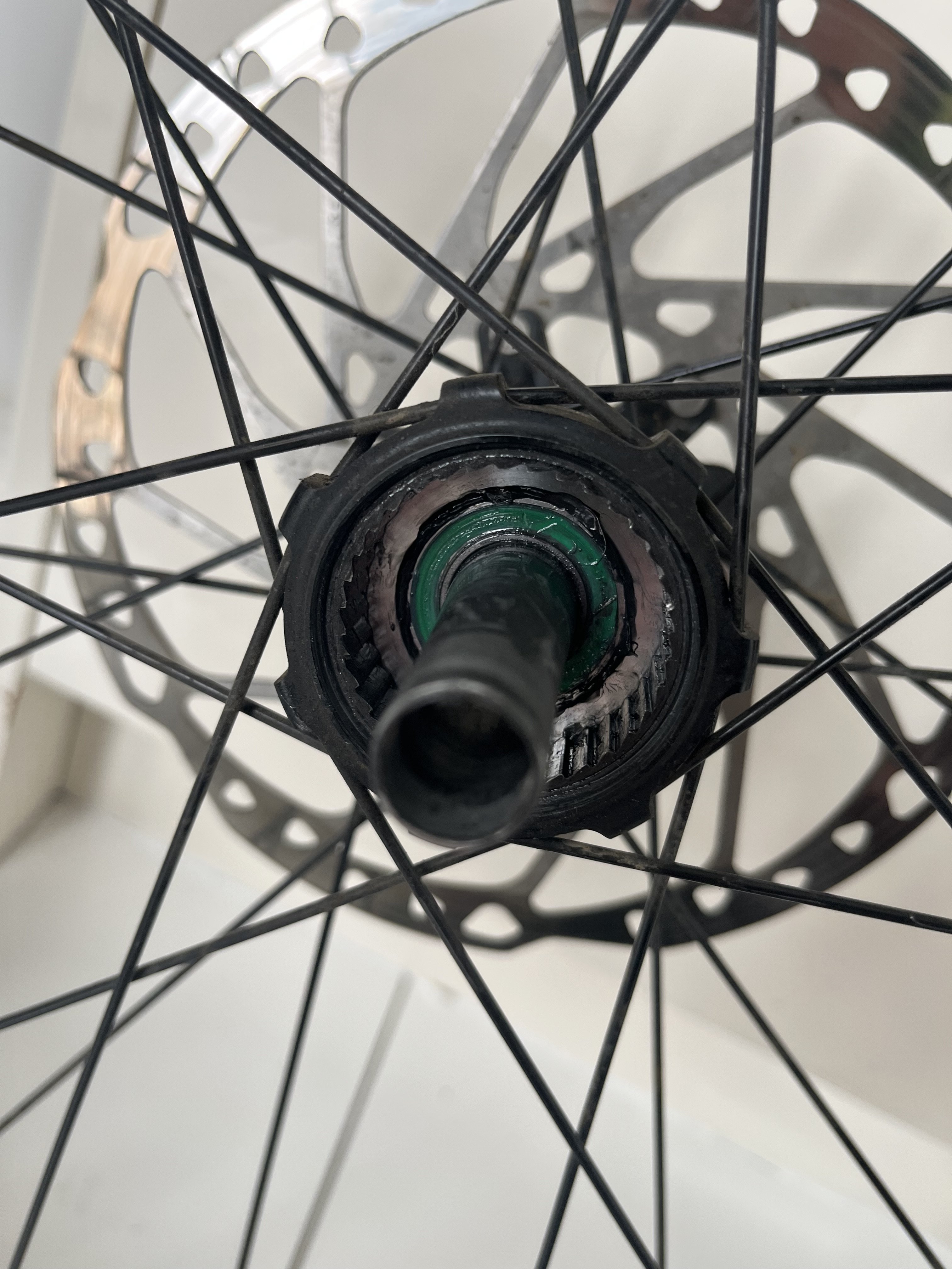

Was attempting a brake bleed and when taking off my rear wheel the cassette fell off.
I have inserted cassette back on however when I tighten it with a cassette tool it dosent tighten it, casette remains free to move.
Unsure if I am just not using enough strength of if I am doing something wrong.
Help appreciated.

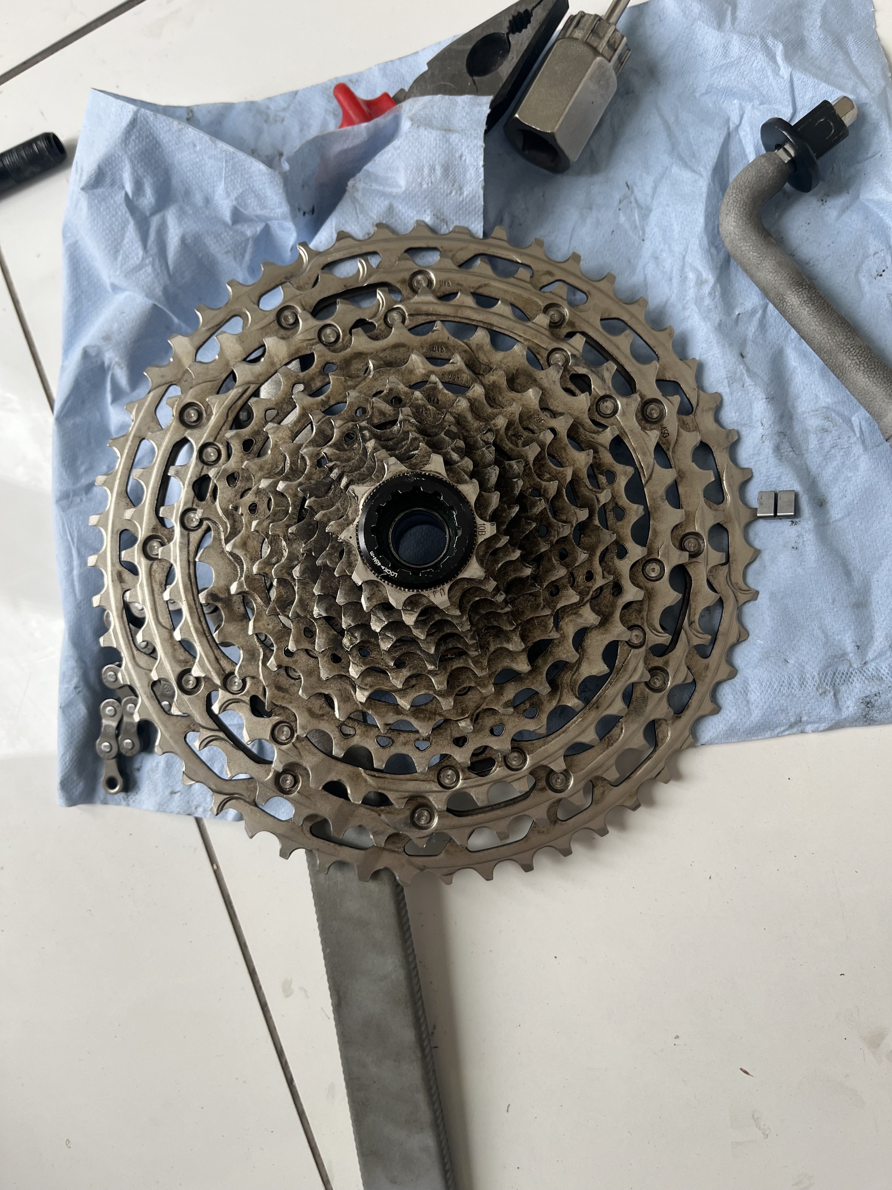

Half of your freehub is stuck in the cassette! At a guess, you've lost a retaining circlip or a nut holding the body to the rest of the freehub. What does the cassette look like from the other side? Can you push the freehub out of the cassette?
Oh no 😠Cannot push the free hub out of cassette too firm. Thanks
Use your lock nut tool & chain whip to undo the locking nut on the cassette and go from there. You might be able to do that as is or you can put the cassette back on the bike & try it that way.
Ultimately, you need to remove the freehub body from the cassette & reseat it on to the freehub AND lock it on so it can't happen again. You are definitely missing something off your freehub to allow this to happen first place.
That's normal behavior on some hubs. Push it back onto the axle and hub body - you might need to rotate it a bit to get the pawls to engage. Nothing to be concerned about.
Ah, I bow to Rick's knowledge, let's hope it just pushes back on. (y)
It’s not necessary abnormal. Which hub is that?
Rotate the cassette counterclockwise at the same time you push it back to help folding the pawls.
As mentioned before some dt swiss for instance work like that, very handy two swap the cassette between two wheelset with the same hub actually :)
