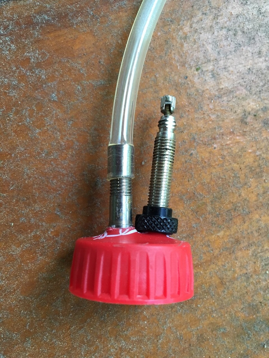

The ghetto Coke bottle thing really does work, the idea is to fill the bottle with 60 ish psi air pressure through the Presta on the right & then release it in one go via the tube on the left of the pic which has a clamp of some kind & it blows the tyre onto the bead. I've had success with it on awkward tyres. Remember all you need is to get the tyre onto the bead & then you can do the rest with any old pump.

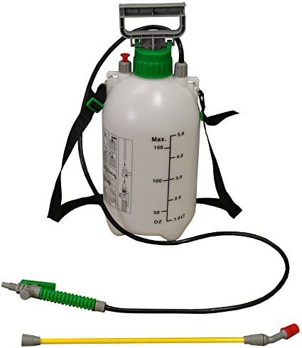

More recently, I bought a cheap weed sprayer, removed the lance & put a brake bleed clamp on the hose. This thing is completely reliable. I can pump it up to about 70psi before it starts venting through the relief valve & you don't have to keep a garage that makes you look like a crack head.
I was considering this awhile back, as I have one sitting around. But the stated pressure on mine is 2 bar (29 psi). And I feel the pressure relief valve opens quite quick when hand pumping (although unmeaured). Is there a stated maximum pressure on yours?

No idea, I can get it to 60-70psi by the track pump before the relief valve starts clucking. These things are generic products made in China, they'll all be much of a muchness but the important thing is not trying to inflate the tyre in one go, all you're after is to get it to seat on the bead. If you can release air fast enough, then you're in business.
Just went and made one there. The 2 bar (29 psi) limit on the side. The relief valve opened at 20 psi. Only a tiny bit, might be able to get it to 22ish. My one is 2l in volume. A reasonable amount of air seems to come out of it better than a floor pump thats for sure, would rather it could go up to 50 psi though. The container I have no doubt can do 50+ psi as I can stand on it and its undamaged. Putting a finger over the relief would allow a higher psi to be achieved, maybe a small bit of tape.

They are sturdy, so find a way to block up the relief valve is what I'd do.
Err, sorry to sound like Mum, but there is a safety valve for a reason.
You could keep pumping it up, each time more. You may be lucky and find a pressure you like that doesn't blow the container. But you may be unlucky and find the burst point. Having to wash your kecks may be the least of your problems.
