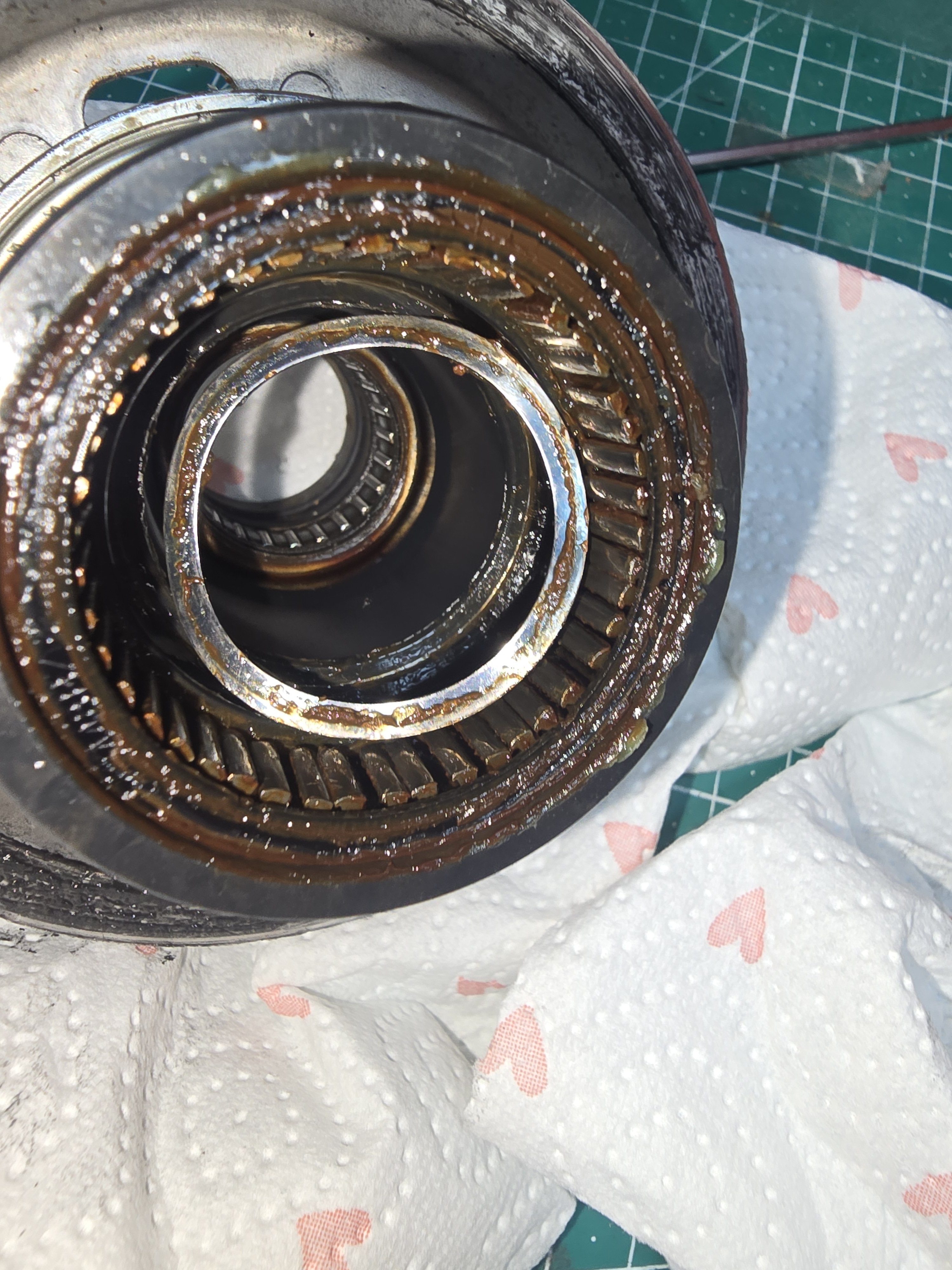

Started to hear clacking from my 2020 Comp and opened it to see situation.
Belt had two small cracks on the edge
and I decided to leave it there and keep riding while waiting for the new belt.
After two or three rides it gave up.
After opening it for second time and done some research it was clear that clacking noise is not from belt but most likely from sprag.
Some history at this point, bike has done 7000km with this motor with great care to avoid the water when possible.
It payed off, no rust inside at all, only sprags. to be replaced, all other bearings seem to past massage test.
Here is funny detail to be seen on this image, one of plates(bottom one) is in wrong direction it seems and that is before I took the bearing out!
Once out, plates started to fell out, no damage on shaft or housing.
Now waiting for Kluber grease to come. separately as they(AXEVO) sell sprag bearings without grease and you should use special grease without EP aditives for sprag to function at it's best.
Not sure about heat marks on shaft if that part of shaft was heat treated in factory or needle bearing was overheating badly?
Any idea?

No, no,... it. must be my English, I left old belt with cracks in and put motor back while planing to order new belt but in next few rides belt broke so I took it down agein to find out the sprag is gone too.
