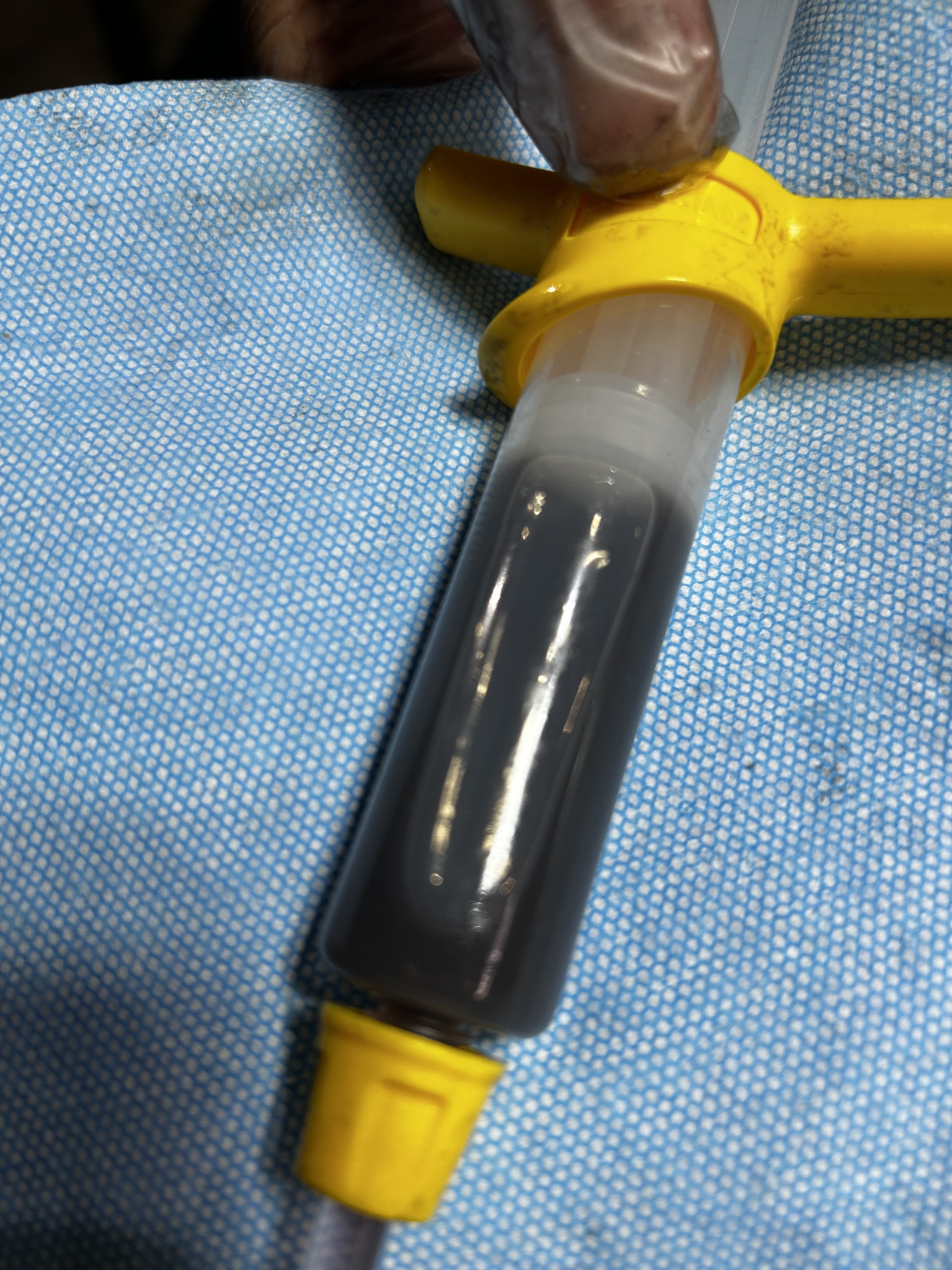

I flipped my bike upside downrecently and remove the rear wheel to clean the sprockets and chain.
I’m sure this got air in the system, but it didn’t show up until a couple weeks later. I don’t know why. One day I started a ride and the brakes went to nothing. I could pump up a little at first, but it quickly went to nothing.
In the process of bleeding the brakes at the rear, the first pull of the syringe was a huge amount of air. I was shocked. The fluid was a dirty, dark gray as well. I’m told that is due to overheating or oxygenation. I’m going with oxygenation.
The bike is two years old.
It’s been working great so far after five or six rides.
Hope that helps. Good luck.
