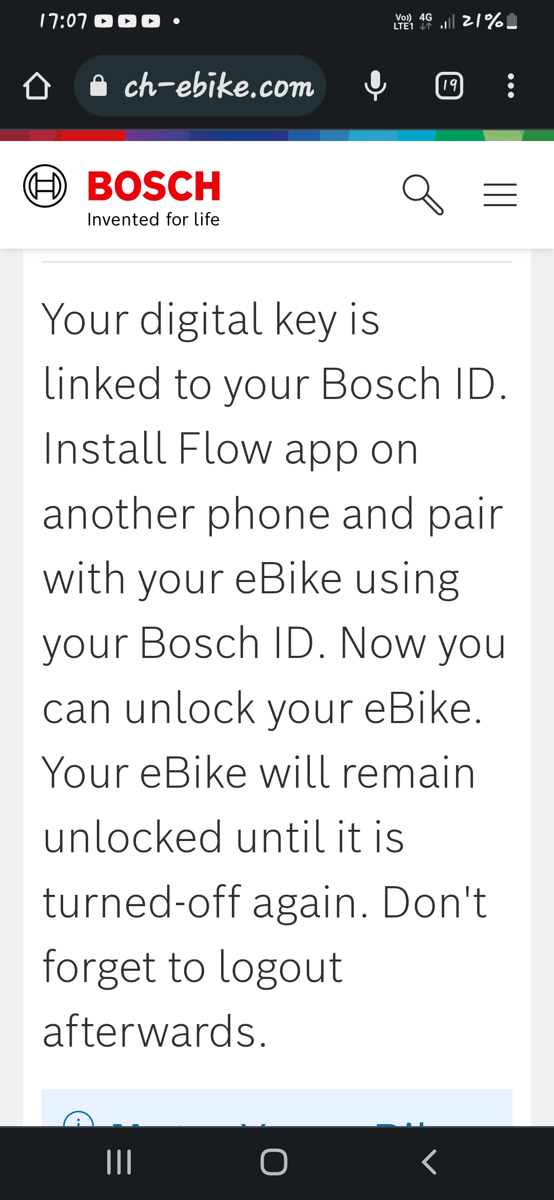

A phones ID is not its SIM card, a phones ID is its IMEI number.
Giff
Oct 14, 2019
424
116
Cheshire UK
I haven’t tried yet but on the Bosch website: Sorry Mikerb your theory did sound credible!
Can I use multiple phones at the same time when Lock is activated?​
eBike Flow app
Change product
Yes. Your digital key is linked to your Bosch ID. Hence, you can log-in with your Bosch ID on several phones and use each of those to unlock your eBike and disable eBike Alarm.

Bosch Smart blutooth access is restricted by identity rather than open to any blutooth device, and the phone is the "master" of the connection. ( that is why HRM access is restricted to Bosch approved devices only rather than any HRM.)
It seemed my experience together with the experience of the other guy I quoted in my earlier thread, was using the phone ID ( SIM) was that identifier, whereas the manual and yourself suggest it is the Bosch Account id on the Flow App which takes that role. Happy to accept that is the case but it seems strange that in my case my reloaded Flow app was complete with my Bosch Account details but blutooth still would not connect, until I deleted the previous saved pairing on the blutooth list in "settings/connections/blutooth". Similarly the other guy's experience was that nothing he did enabled him to connect with a new phone.
It will be good to hear others experience.

I think phone model and country restrictions may make this more difficult for you because of the Russian poisonings in your country if for some reason your sim is tied to your BLE connections. I’ll have to try it when I’m in the UK next with a local phone. Hmmmmm sneaky UK If so.
yes I know both blutooth will work even if no SIM in the phone but it seemed to me the Bosch System needed something to authenticate the connection...................I can see now that the personal Bosch Account is doing that.
mmmm.......that also means having to remember the Bosch Account login and password to get access via another phone!!
I think I will pass on this one:p
