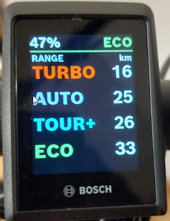

I just received my Charger 4 with the Bosch Performance Line Speed Motor (45km/h) and I had the following modes pre-installed:
- Eco
- Auto
- Sport
- Turbo
I really have no idea what the differences between Sport and Turbo is, for example. Also don’t know if I should replace either one of them with the Tour mode I keep reading on here since I don’t know what any of them mean. ;)

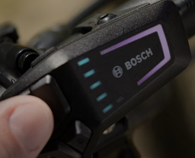

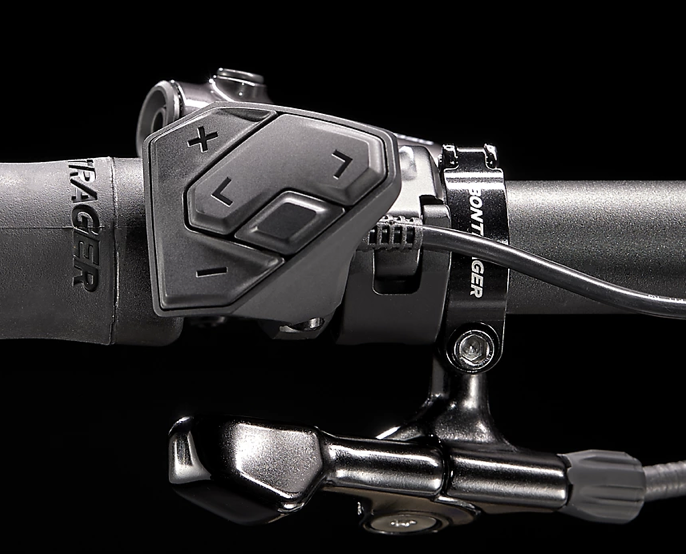

Question if my 2022 model will accept the Auto mode update? It's a 2023 Trek Powerfly FS9 equipped purchased 7/22/22 and I'm thinking the Smart system was added to the 2023 Trek Powerfly platform during a mid year change because this Bosch link quotes Smart System was being added to all 2023 models on the Powerfly platform: Trek Bicycle Launches New Powerfly eMTB Models with Bosch Smart System – ebikes Int'l
If I remember I think the system has to use the pic witht the LED colored lights rather than the black rubber button model I have.
* it does have ETMB mode which in past models was Sport mode.
* It came OEM with the Bosch Smart Phone Hub which I switched out for the Bosch Nyon control unit.
Thx
