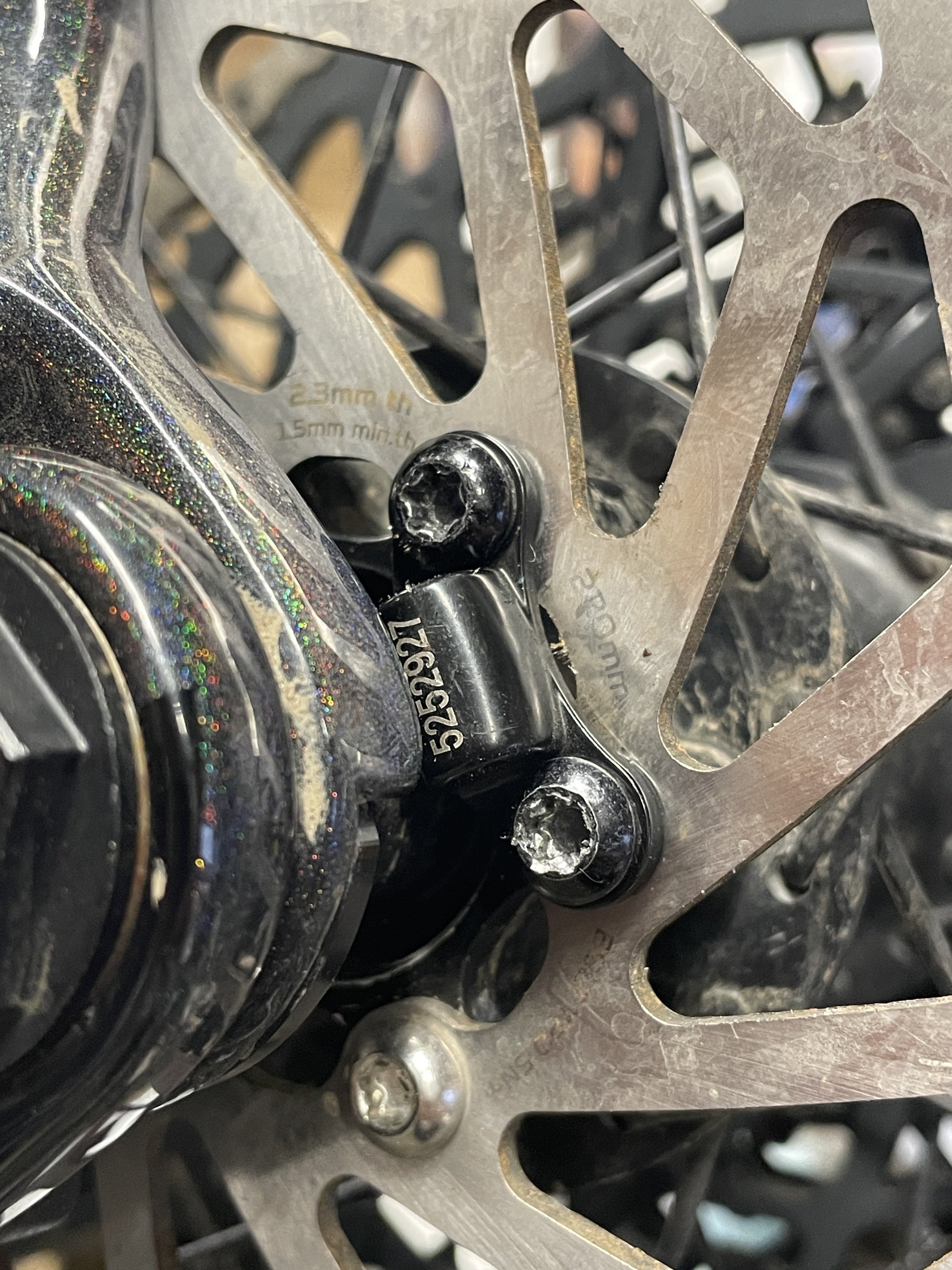

Update from me (Trek Rail 9.8 2023). I ended up going to the dealer and having them up the walk mode top speed. No difference, still crap. Haven't gone down the route of using a rim magnet yet as this requires authorisation from Trek and reprogramming etc. Why should life be simple huh?
Anyway, today on a hunch I started fiddling with the rotor mounted magnet. I've swapped it for a Hope magnet, put spacers behind it, swung it out further from the axle, all the things people have suggested elsewhere. No dice. Then for a laugh I turned it around completely, reversing the polarity of the magnet...
It works.
Well, walk mode works perfectly now, but the speed doesn't register and I get an error code. Switch it back and restart, same as before. Switch it back again and restart, now walk mode works AND the speed is registering! At the time of writing it now functions perfectly. I'll keep an eye on it.
So it seems that either some of the magnets were assembled wrong, or some of the Trek speed sensors were wired wrong, possibly both? I don't have the kit to test polarity etc, nor do I know how it's supposed to function but I do know that I now have a bike that works as it should, finally.
Hope this helps someone else, do have a poke at your magnet and see how it works out. Turns out you can remove it without having to remove the wheel every time so that's a great help in the process of experimentation.
It works.
