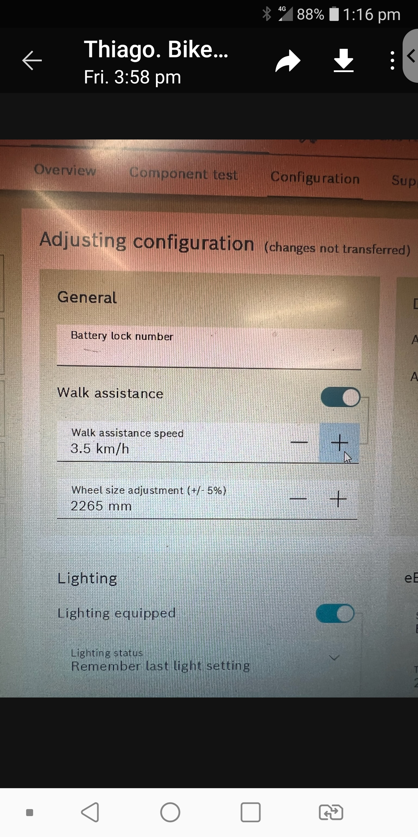

Inside the settings which are accessible by the dealer it is possible to adjust the walk assist mode. I am hoping they will be able to rectify things. Maybe... The fault isn't with the speed but the starting and stopping.

I just updated My system and put the walk assist speed to max (can’t remember what speed that is), and today on a steep snowy trail tried it for the first time. In 3rd gear it worked perfectly, just like my 2021 rail. It was almost dragging me along, not the other way around
Where do you change the walk assist speed? In the flow app or??
