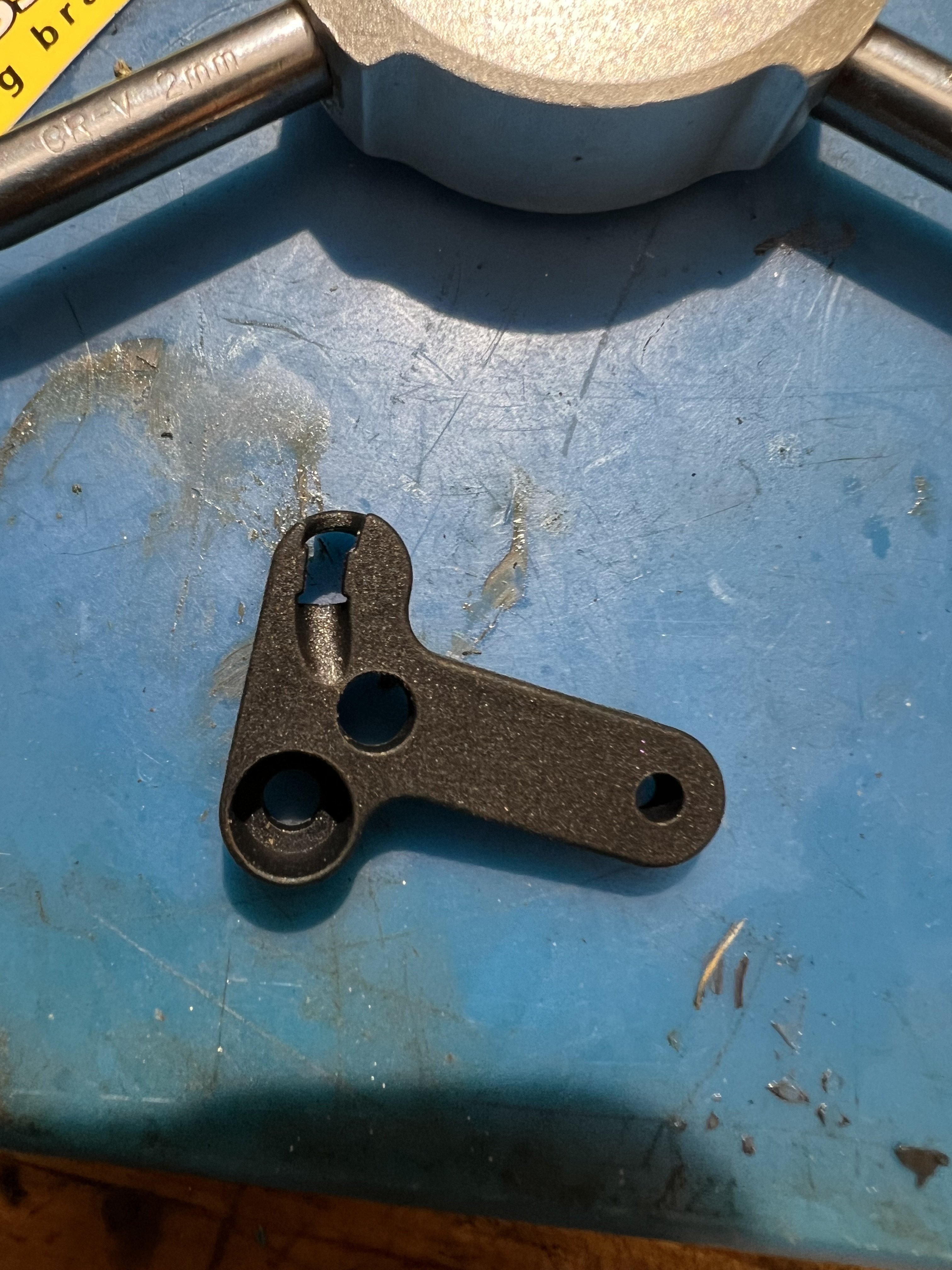

Trek has designed for the RAIL and POWERFLY a piece that modifies the position of the sensor with respect to the brake disc magnet, the little that I have tried finally works!!!

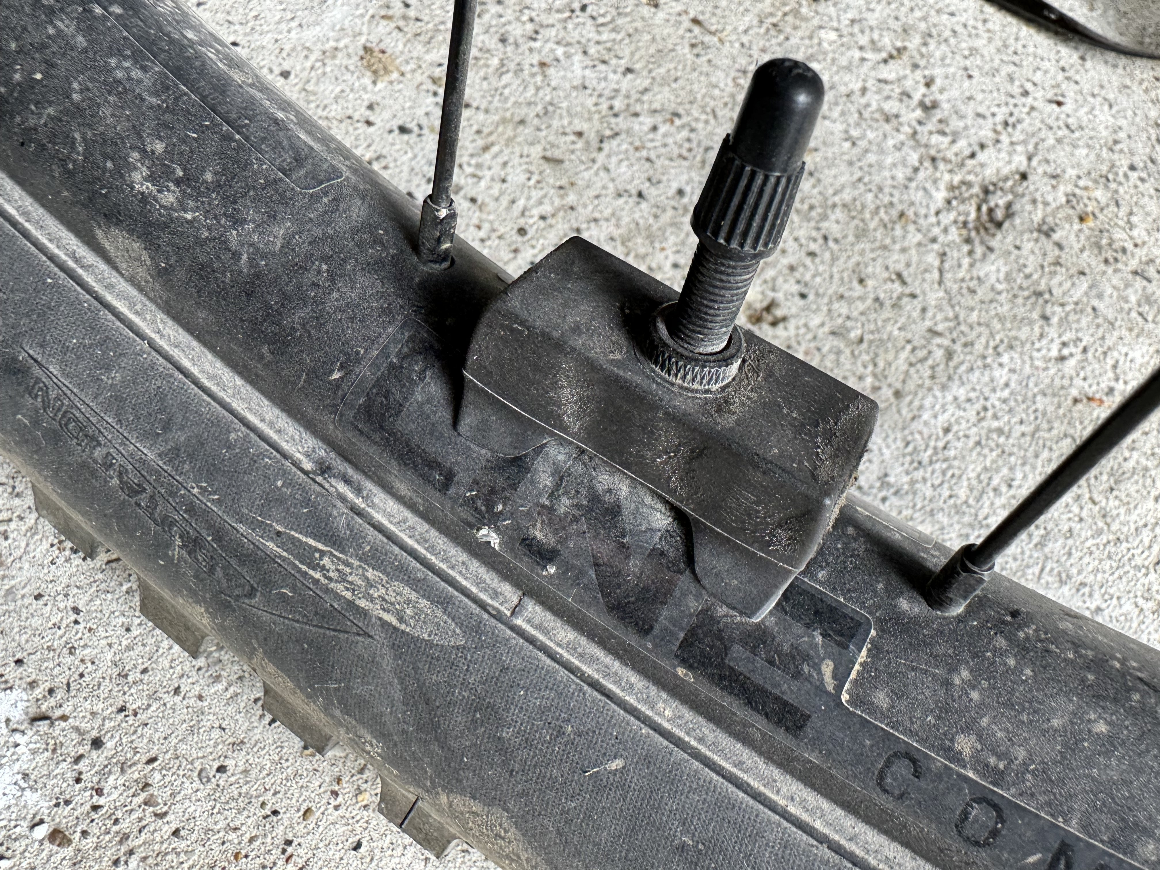

Finally, the walk assist problem with my Trek 9.8 2022 has been solved. It was a back-and-forth between my dealer, Bosch, and Trek, and as usual, neither Bosch nor Trek wanted to acknowledge that such a problem exists. The motor was checked by Bosch with the result: everything is okay. Bosch advised my dealer to discuss the case with Trek again. Eventually, it became clear that the motor had been programmed by Trek for a rim magnet (fitted over the valve) and not the original brake disk magnet. The impulse of the valve magnet is detected as it passes close by the motor. So now, I have a magnet over the valve with the original brake disk detector removed. I simply don’t understand why the motor could not be reprogrammed to brake disk detector, and why, apart from the walk assist, the speed and distance measurements were correct with the brake disk detector.

That was an interesting result Tuan. Something so simple that took them so long to figure out.

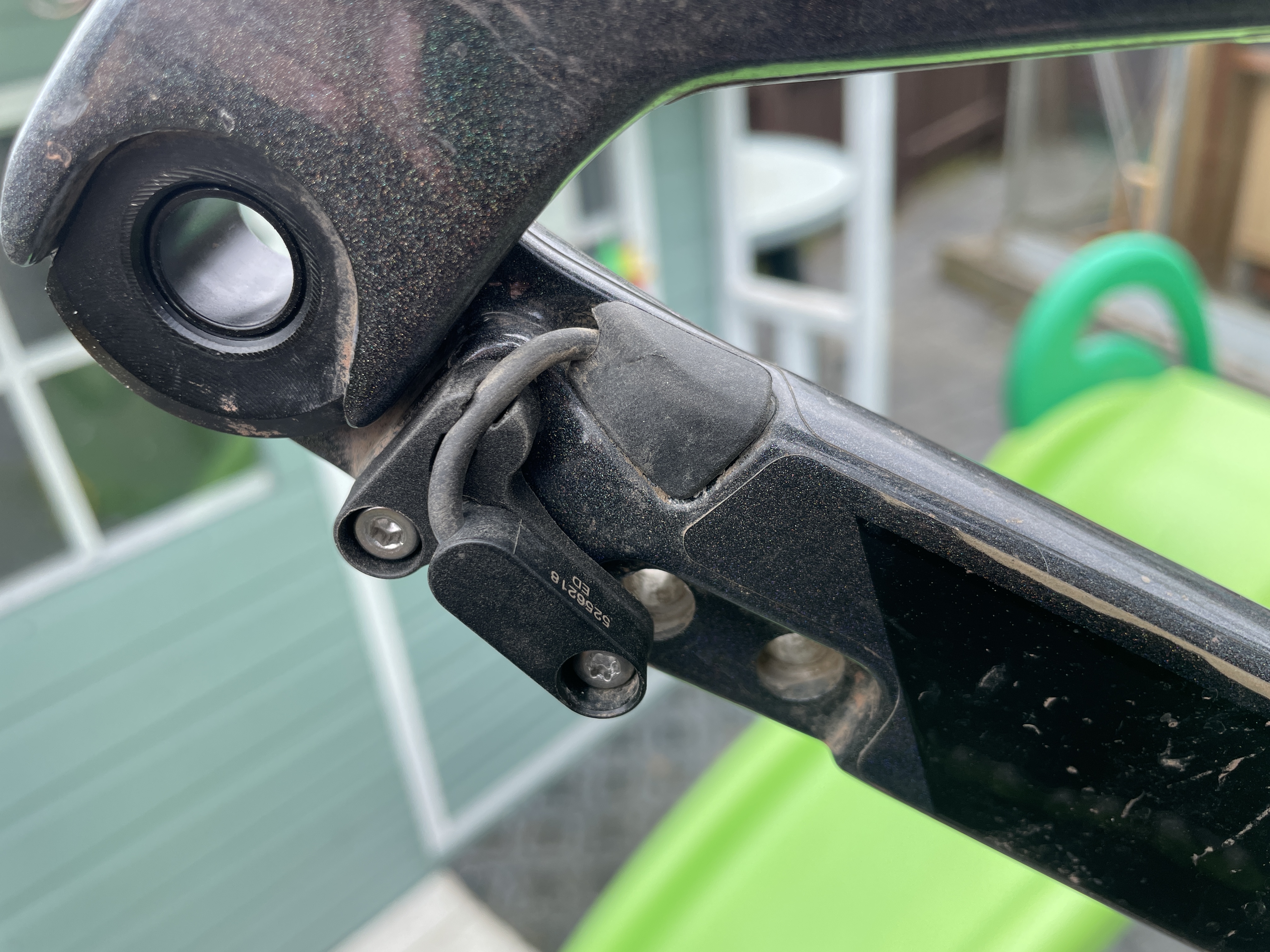

Just following up on jaumebtt's post earlier. I've also got hold of an adaptor and it definitely seems to work properly now. At least, it works in the repair stand so time will tell in the long run. Fingers crossed this is the solution for those of us afflicted by the issue. Image attached to show how it works in situ with the existing sensor. Took me a few minutes to figure out how it was supposed to be oriented!

Nice, Ive got the same model, will await further testing from you and see if it works well in all areas. I don't really used the walk mode much though.
I have tried it a little more and the conclusion is that it improves a lot but not 100%, the speed is still not constant but I repeat that at least it is usable, not like before when it was useless.

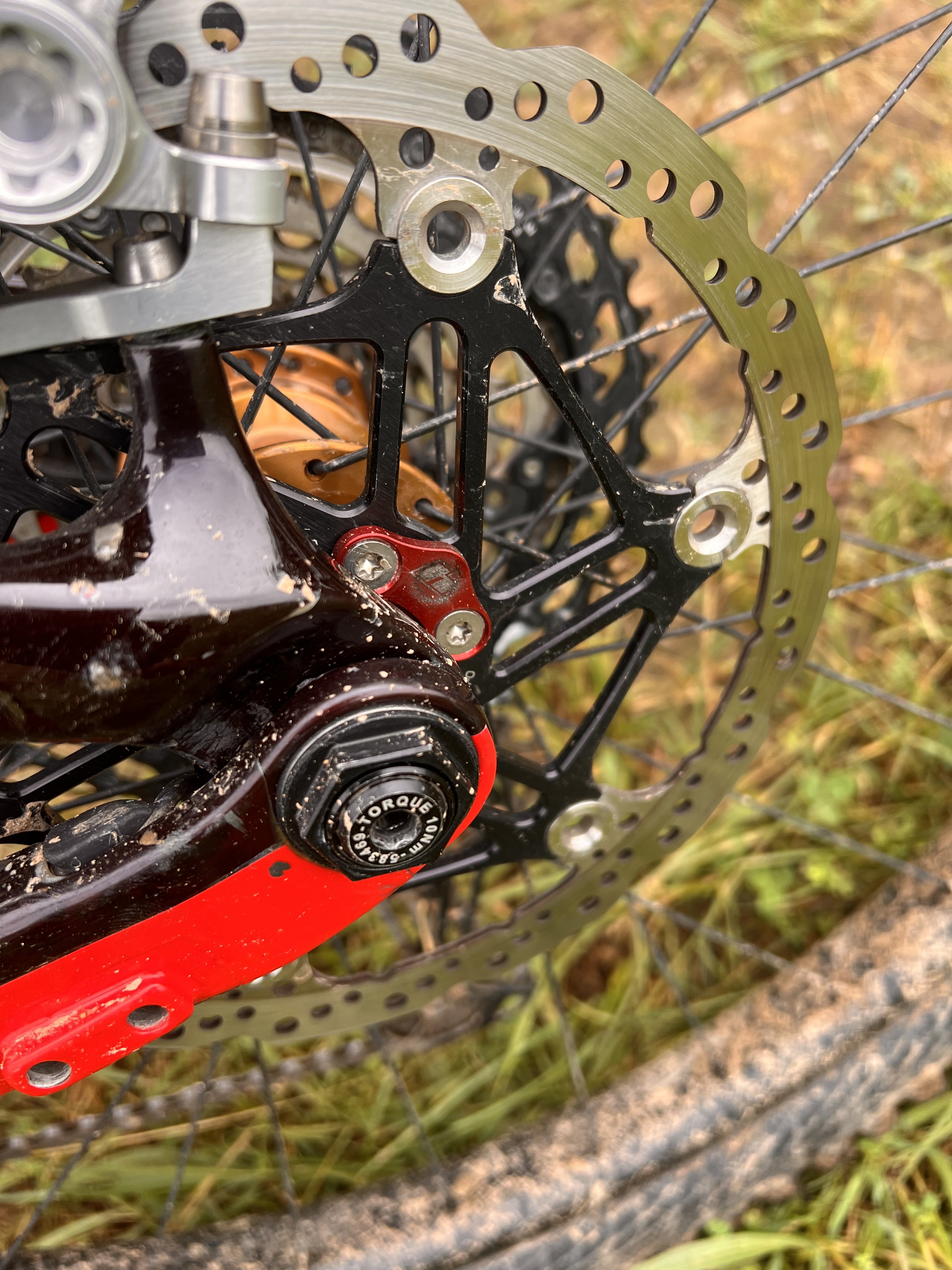

attention!!! I have installed the HOPE magnet and it works perfectly, along with the Trek piece that I mentioned previously.
satisfactory result with the combination of the trek piece in combination with the hope R24mm magnet
