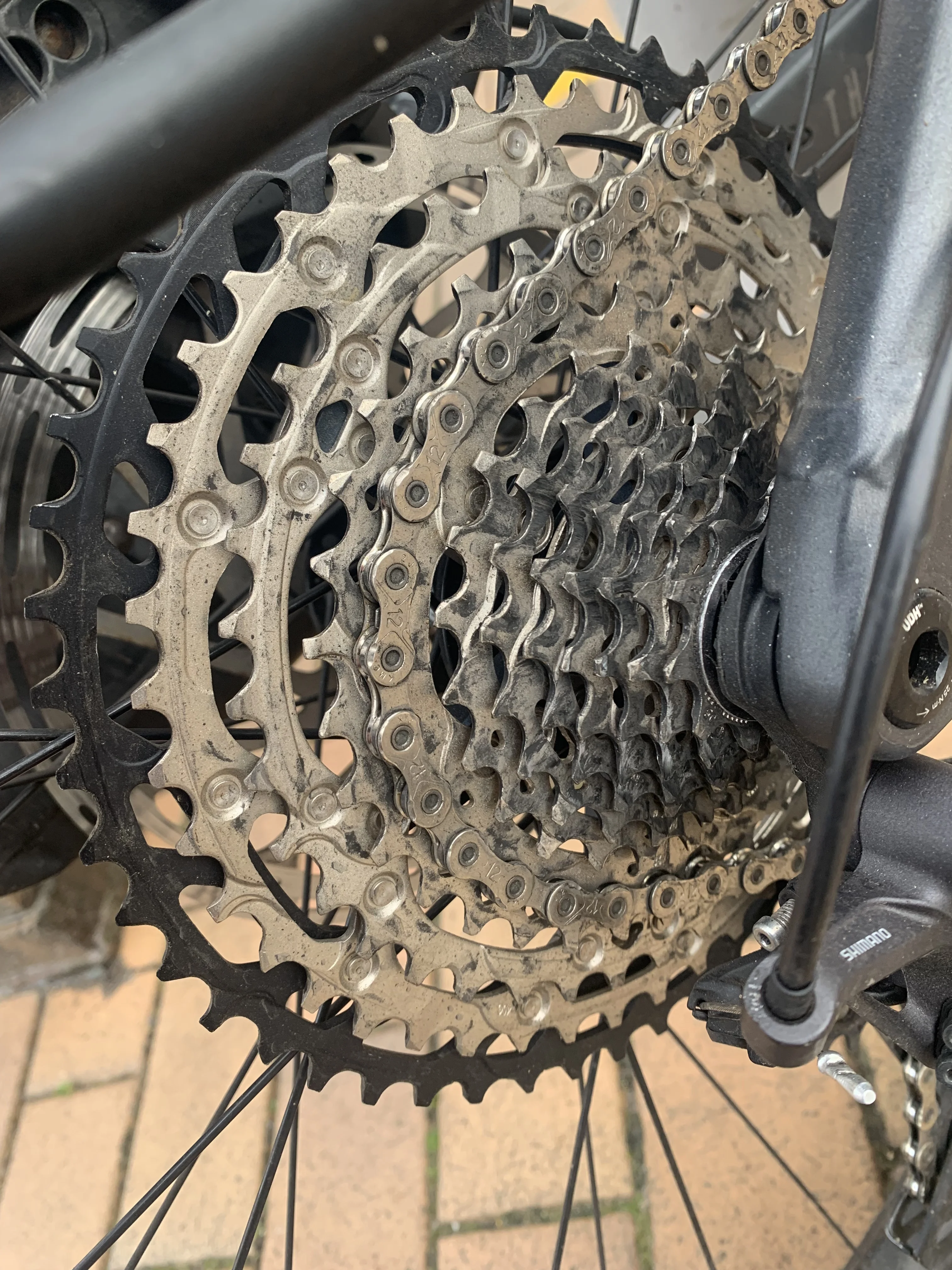

  • Rear Derailleur: Shimano Deore M6100, 12-speed
  • Cassette: Shimano CS-M6100, 10-51T (10-12-14-16-18-21-24-28-33-39-45-51T)
  • Chain: Shimano CN-M6100
  • Crankset: Samox, 165 mm (e-MTB)
  • Chainring: Samox 36T
  • Freehub Body: Shimano HG spline [1, 2, 3, 4, 5]

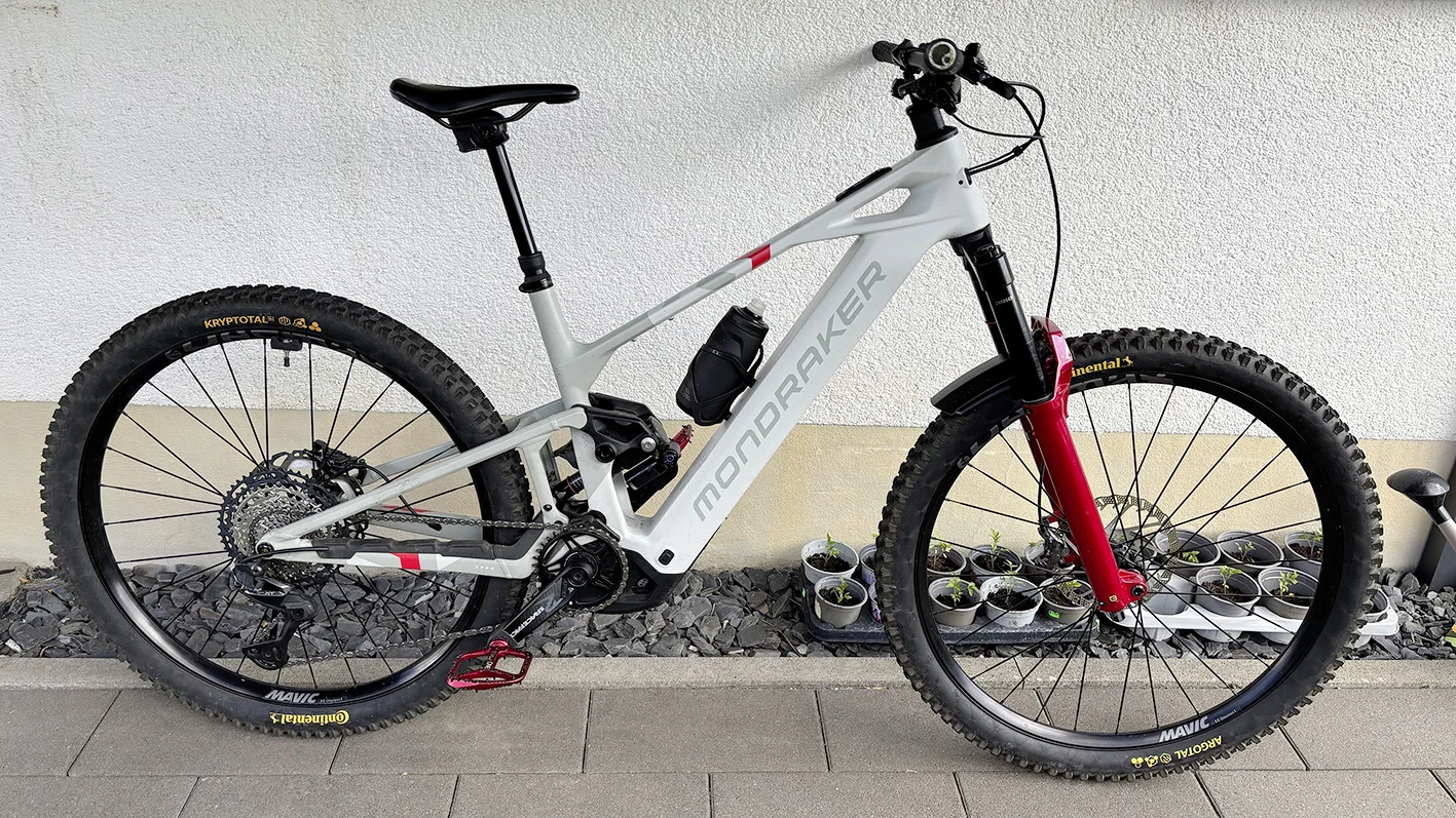

Changed XT Cassette (now M8200, former M8100) and XT Chain at 2100 km. Derailleur changed from XT mechanical to XT Di2 approx. 400 km earlier.
Mondraker Crafty R, 120 Nm now, 100Nm since Update release date before.
