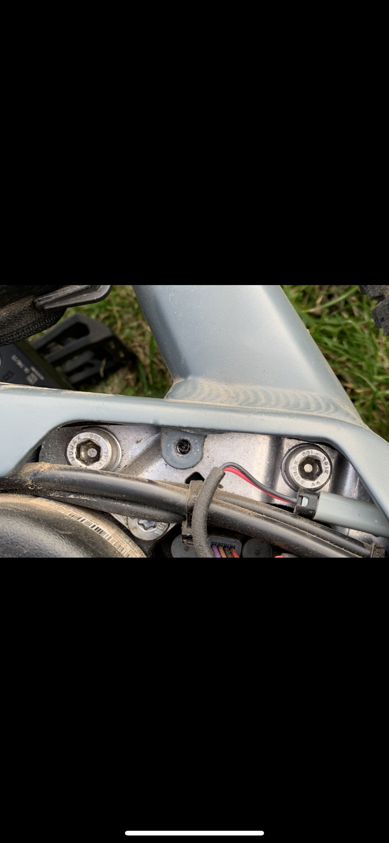

After years of no creaking after tightening up the motor bolts (gen 2 Bosch) the dreaded creak returned the other day. The two large bolts shown here were loose. Tightened these two back up to 24nm (the limit of my torque wrench). I’m guessing over time the aluminium compresses and these need tightening up eventually.
How tight did you do yours back up to?
I emailed a website that rebuilds/reconditions these units sending him the diagram highlighting the bolts and the reply was 20nm 🤯 personally I'm not seeing that size bolt take 20
Nooooo! Never more than 12 on a carbon frame..never!
