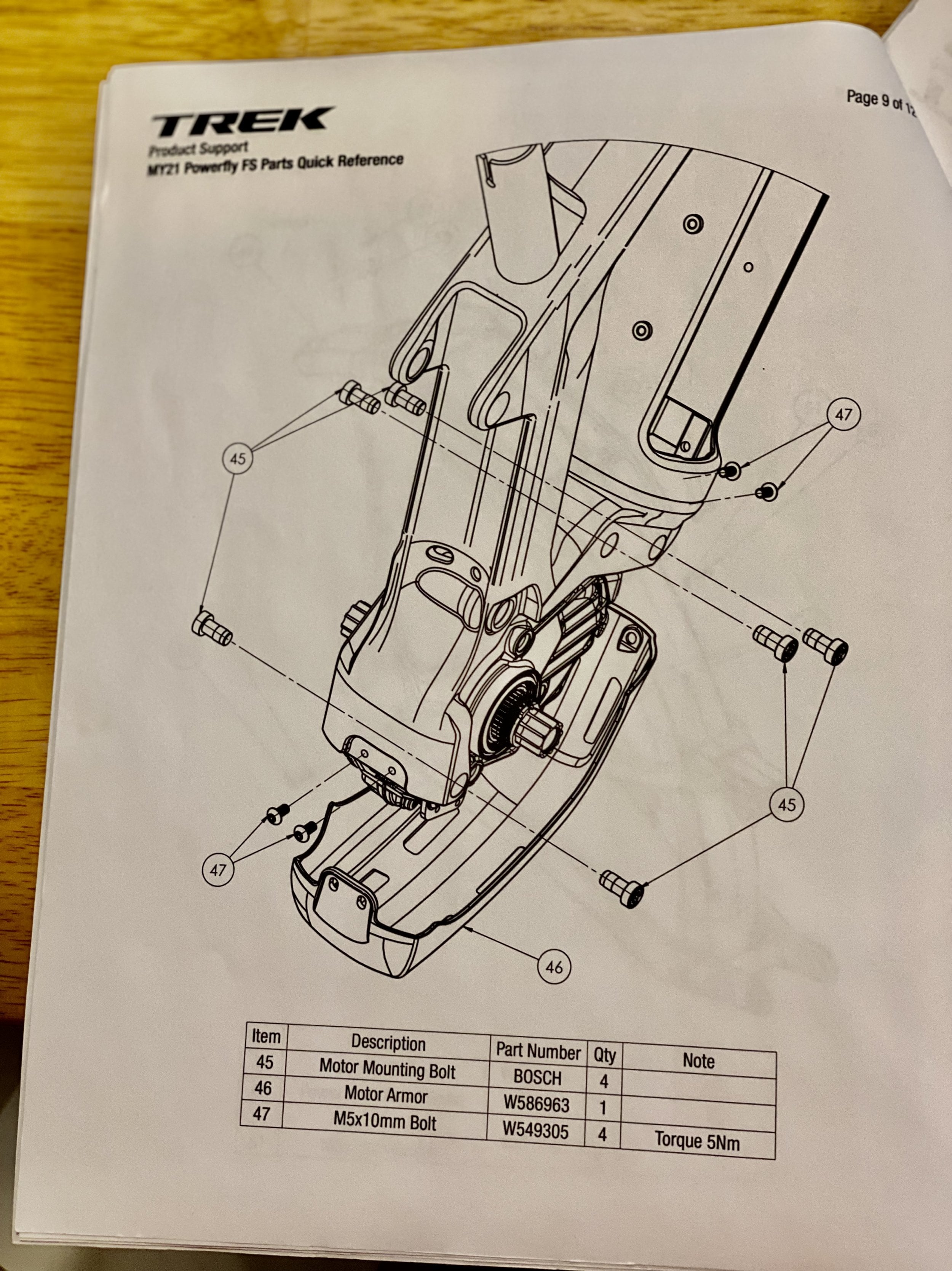

I emailed a website that rebuilds/reconditions these units sending him the diagram highlighting the bolts and the reply was 20nm 🤯 personally I'm not seeing that size bolt take 20
20Nm is for the big bolts that go through the frame into the plates (No54 in the above pic) and that is for aluminium frames.
The smaller bolts should be 6Nm and all bolts loctited.
(coming from the Cube area and a carbon frame 11Nm for big frame bolts, 6Nm for plates to motor)
