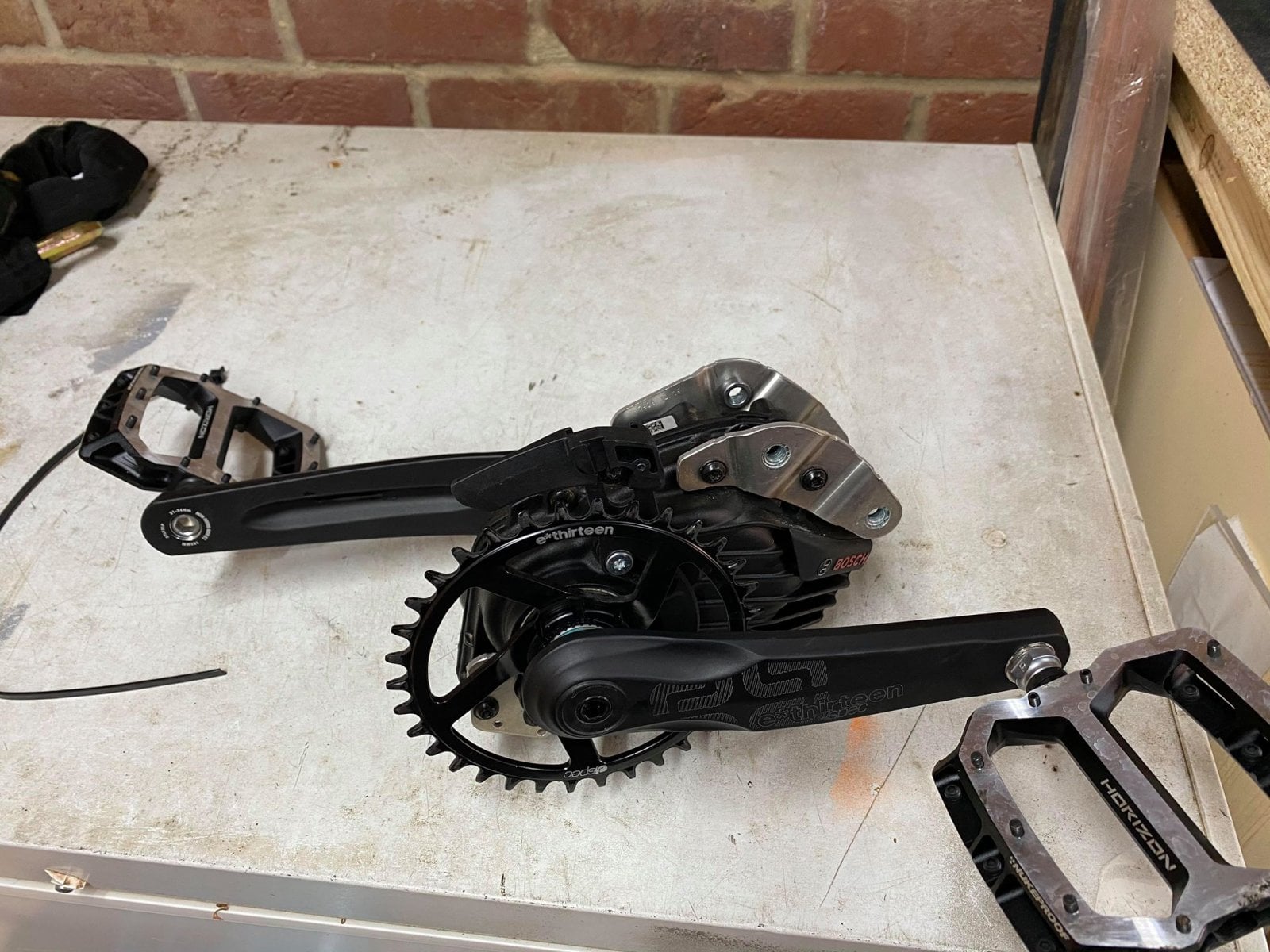

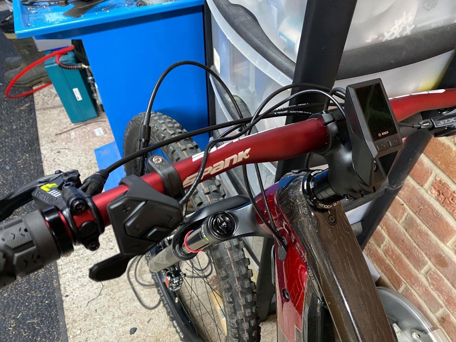

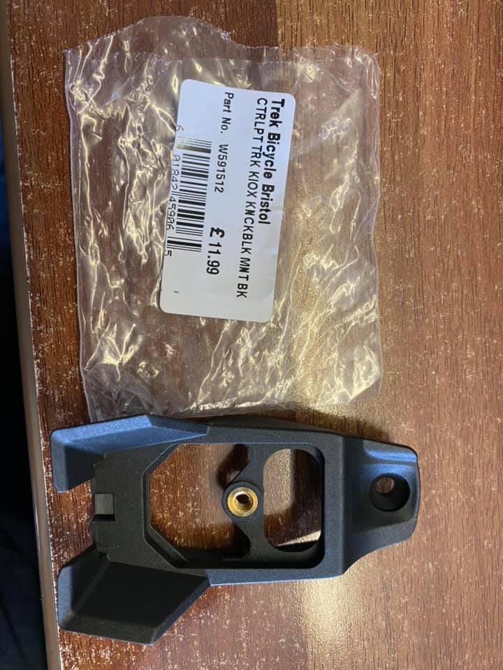

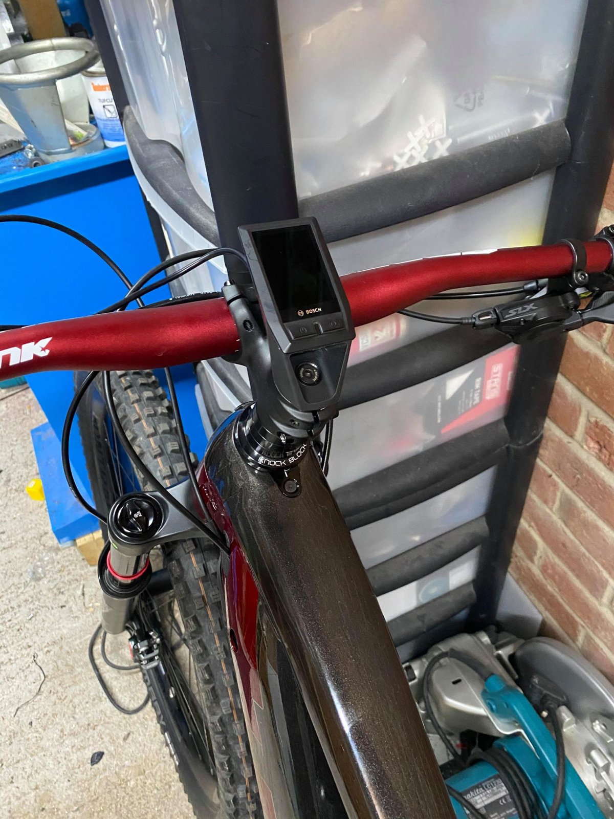

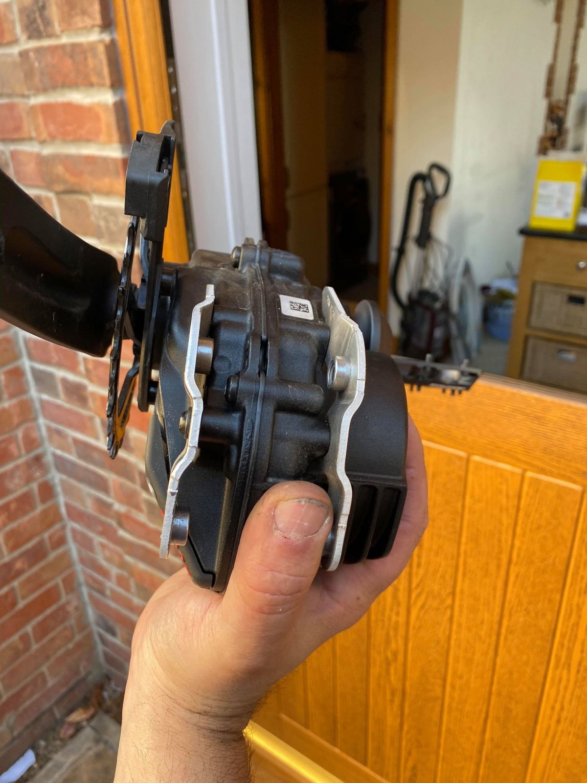

So fitted the Kiox on my Rail 7 today and also decided to fit the MT7 brakes I had for sale. Might as swell as I had to drop the motor!
Overall it was an easy couple of hours work. The motor is 6 bolts and is out. Very easy. Taken longer to mess with the battery mounts than actually doing the whole job lol.
Pretty pleased with the change. The Kiox seems allot better than the Purion in my opinion. But the main reason to change is the Lock security option.
Here some pictures
OneEyedHito
Apr 29, 2020
The Ohio River Valley
Nice work, any trick to getting the battery mount lined back up properly?
Here some pictures
View attachment 29618 View attachment 29619 View attachment 29620 View attachment 29621
