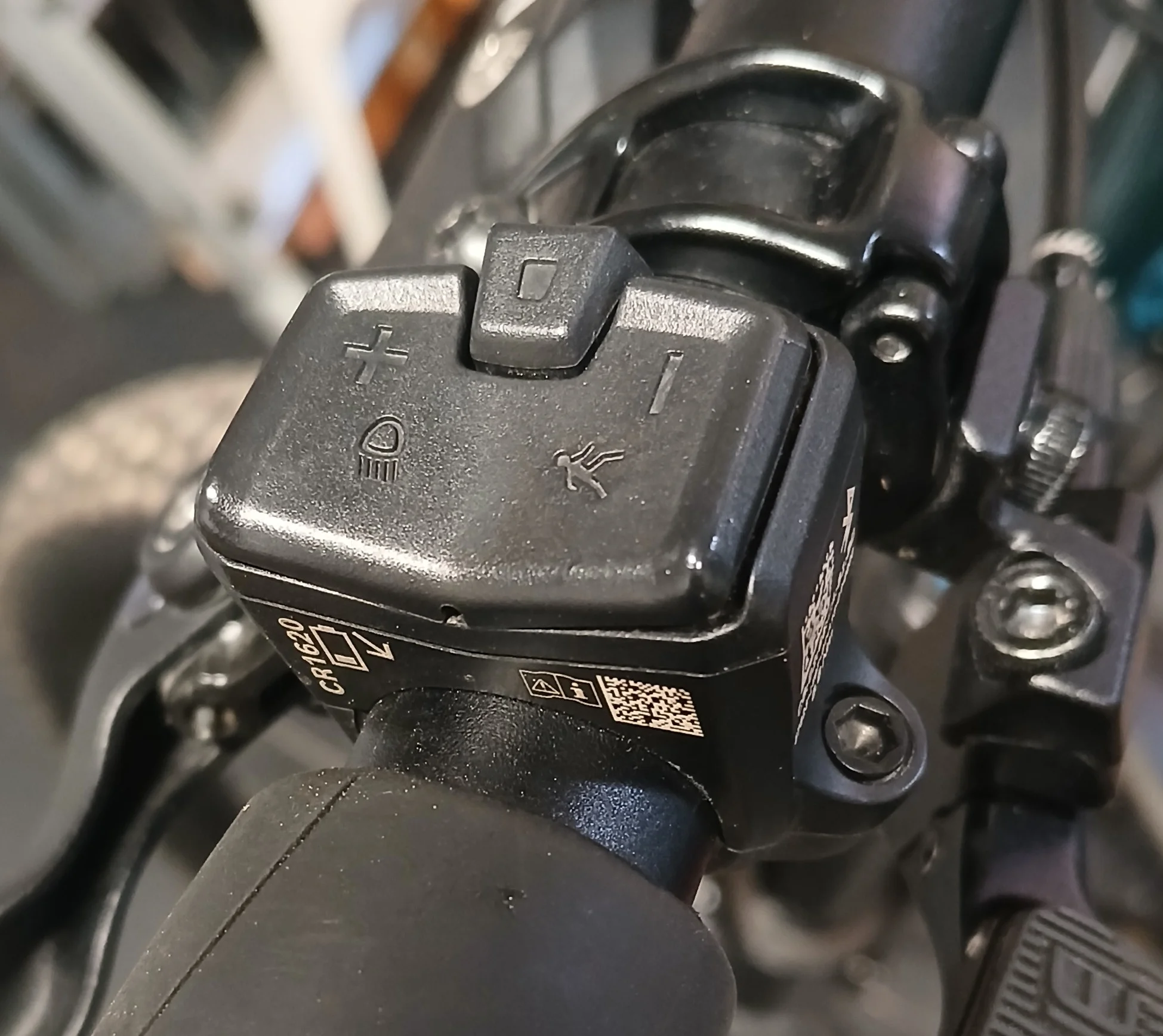

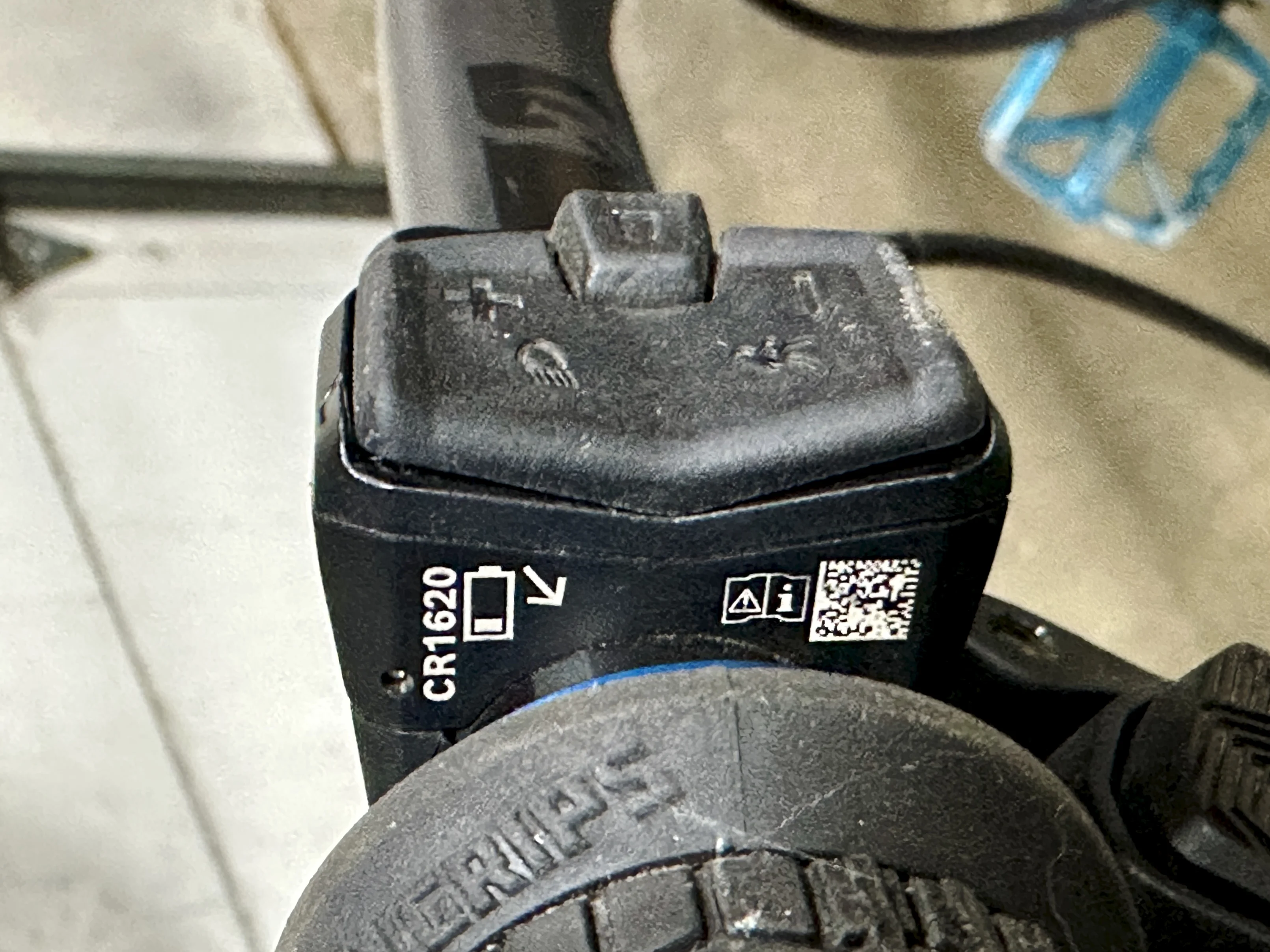

1. The clamp is made from the eggshells of undernourished hens. Tighten it 0.1 Nm beyond the 0.6 Nm recommendation and you'll be ordering another.
2. Get a little heavy handed with rubber cap covering the switches, and it will assume the shape of a potato chip.
3. The switches are sensitive to the point that you can't be sure what's going on without checking the display.
The motor is made for hardcore shredders slamming it off rocks, but the switch is more suited to endodontists delicately loafing along the paved bunny trails.
Yup. That's the most likely cause of the OP's observed symptoms. As much as I enjoy the Bosch motor, the Wifi Remote is şħíț on a biscuit.
1. Thanks for the warning!
2. What rubber cap?
3. Maybe the rubber cap was to reduce the touch sensitivity? (And yes, I do have to check the display).
I agree about it being suitable for delicate loafers on paved bunny trails.
2. What rubber cap?
It's the soft rubber rectangular thing that you push with your thumb. You can pull up on it a little with your fingernail to see how it is, but don't pull too much or you'll break it. I goofed up the one on my 2024 bike within two months, and neither Pivot nor Bosch could get me one for several months. I ended up having to order one from Italy. During that time, I ran across the Pivot demo guy. One of his bikes had the same goofed up remote.
Luckily, you can get by without the remote by using the display.
