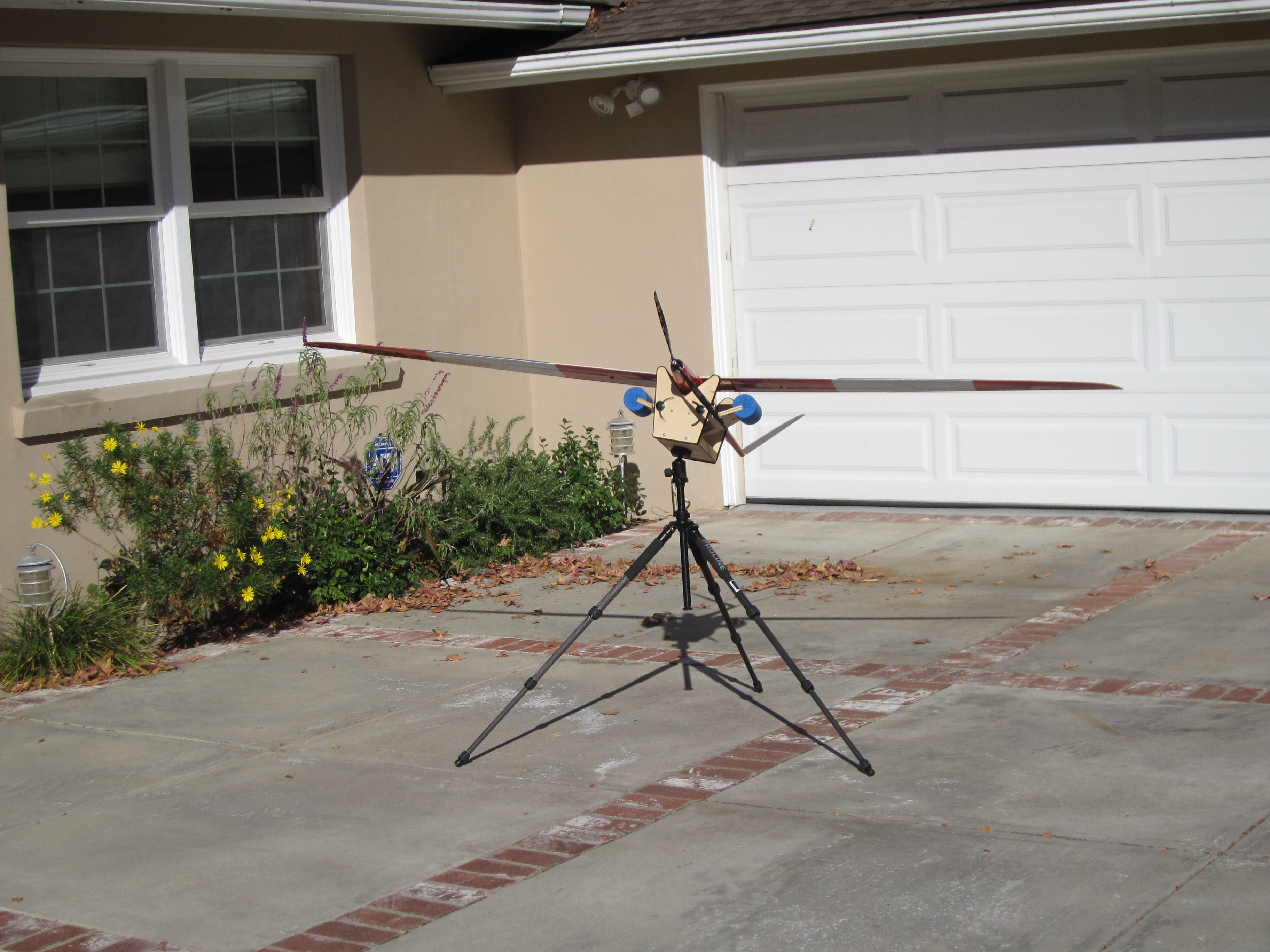

I built race motors and did some pro motorsports competition in my past. Torque is twisting force, horsepower is work done. Torque X RPM/5252= horsepower. Anytime you see a car magazine with a torque and HP graph and the two are not equal at 5252 RPM their graph is BS. Amazing how many writers at car mags don't know that and their graphs are made up.
The RC carbon fiber plane in this photo makes 6,800 watts, does 0-180 mph in 3-4 seconds, weighs 5.5 lbs. I use a 6.7:1 gear box, it allows me to spin a larger diameter prop to create higher thrust, like torque. The gearbox is torque multiplication. In theory 746 watts = 1 HP, some is lost as heat. I sometimes run lower ratios like 5.2:1 or direct drive spin a smaller diameter prop, less acceleration and higher top speed. Just like the gears on our MTB's.
What I was proposing for the industry in a nutshell is screw the wattage limit, the bikes are limited to 20 mph, motor starts dropping off around 19 mph, that's a given. But why cant I burst 500% or 600% or 700% if I am going 11 mph up a hill and I hit the pedals hard and want to unweight the front tire a bit to clear a bump. And that is what DJI has done. They deal with the same motors/gearboxes/props on their drones as my plane in the photo. They have their 120 nm torque and their argument is the same as mine, don't cap watts or torque if that make the ride better as long as we are under the 20 mph limit and it is "reasonable". Yeah 300 nm it will probably just do burnouts and wheelies and not really an E-MTB.
