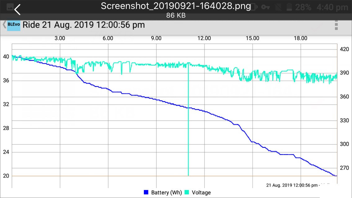

Maybe you could graph a ride in Eco from 100% charged all the way to LVC - low voltage cutout - then use BLEvo to graph the ride using battery on the left / battery wh on the right - then explore by individually adding & removing (so as not to overpopulate the graph) - voltage, instant current, motor power & battery temperature - especially going up steep slopes - so you can see what’s going on under load. The interesting part will be the lower right side of the graph as the battery nears LVC
Read the Blevo instructions last night and learnt a lot .. but didn't know you could do that !!! I will have a play . Thanks .. Even just from comparing it with the previous bike and then looking at yours and Stumpys results, it seems like its way way way off what it should be. Yes, I can go 40km's on it .. but I need to ride it like an analogue bike for that and still possible ride with a flat battery for some of it, crosses the line of why it's an e-bike !!! My Legs are still throbbing from my 38k ride on eco and motor off 1300m and the final 5km climb back home with a flat battery.... :)

Yes if I had to guess, I'd say it's the signature of a fried cell or 2. I think that could be indicated by steeper voltage drops on the graph though not necessarily by the reported Battery Wh according to what I understand from comments by the BLEvo developer
I'd agree, but the weird thing is that It shows the full 41v or there abouts when it's charged and I get the full 20 amps motor draw .. So it points at a faulty BMS ? If it was something else I'd guess it was shorting out and sucking it that way.
As far as I can guess & yes I know - assumption is the mother of all fooqoops - the charger does not have access to individual cell data even though the RoPD plug is EnergyBus capable, the BMS is possibly not sufficiently advanced to detect a fritzed cell and so the charger continues to charge to 42V but to fewer cells due to the fried one. The result - overcharged cells & lower capacity likely resulting in both lower range & expected cycle life.

So it points at a faulty BMS ? .
Yes you're absolutely right...it could be the absolute best BMS - just on the blink. Another possibility - firmware related? Whatever it is I am absolutely certain Spesh are onto it

- 4.94 mile / 2384ft climb, all uphill on tarmac roads - done in Eco with very occasional Trail / Turbo bursts
BLEvo v3.5.3 Android
- Battery consumed: 45% (224Wh)
OK, good example .. that did suck the power ! 700+ meters climbed over 8km's. It's these instances that make me question my results ..
- 6.52 mile / 303ft commute - again done in Eco with very occasional Trail / Turbo bursts
BLEvo v3.5.5 Android
- Battery consumed: 11% (53Wh)
But then for this, which was similar to yesterdays test .. I used 20% battery.

Just tested the Blevo Smart assist.
Left it in Smart assist Basic and selected the default Blevo SMART options on the configuration page.
Left it in Eco for the ride - makes for an easy time - was flying along !
14km's 400m
- Battery consumed: 30% (150Wh)
- Average consumption per KM: 15.02 Wh/km
- Percentage of average assistance: 37.0%
- Wh ride: 218.8Wh
- Biker: 31.4% (68.8Wh)
- Battery: 68.6% (150Wh)
So using that I'd get a theoretical max of 46km's and 1300m climbing. So way better than it did the other day using a combination of Eco 20/20 and power off. Go figure !
