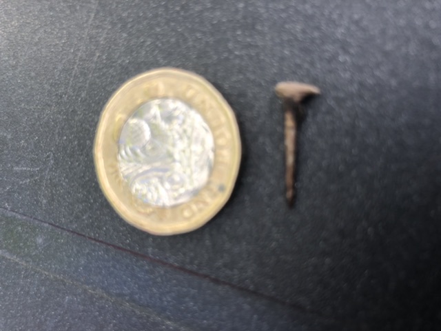

Pulled a bugger of a thorn from my front tyre yesterday, it sealed in seconds. Tubeless is the only way to go.
