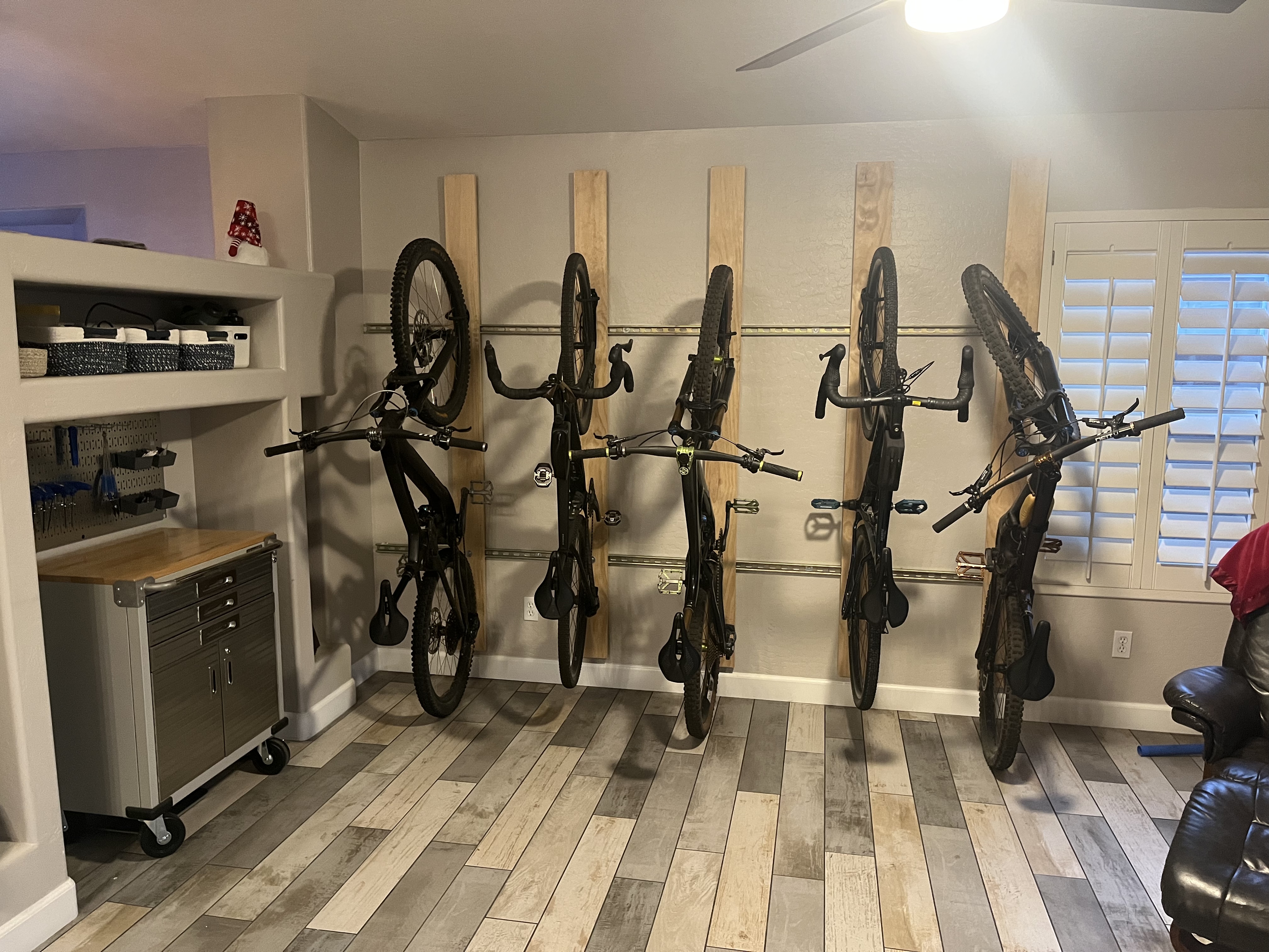

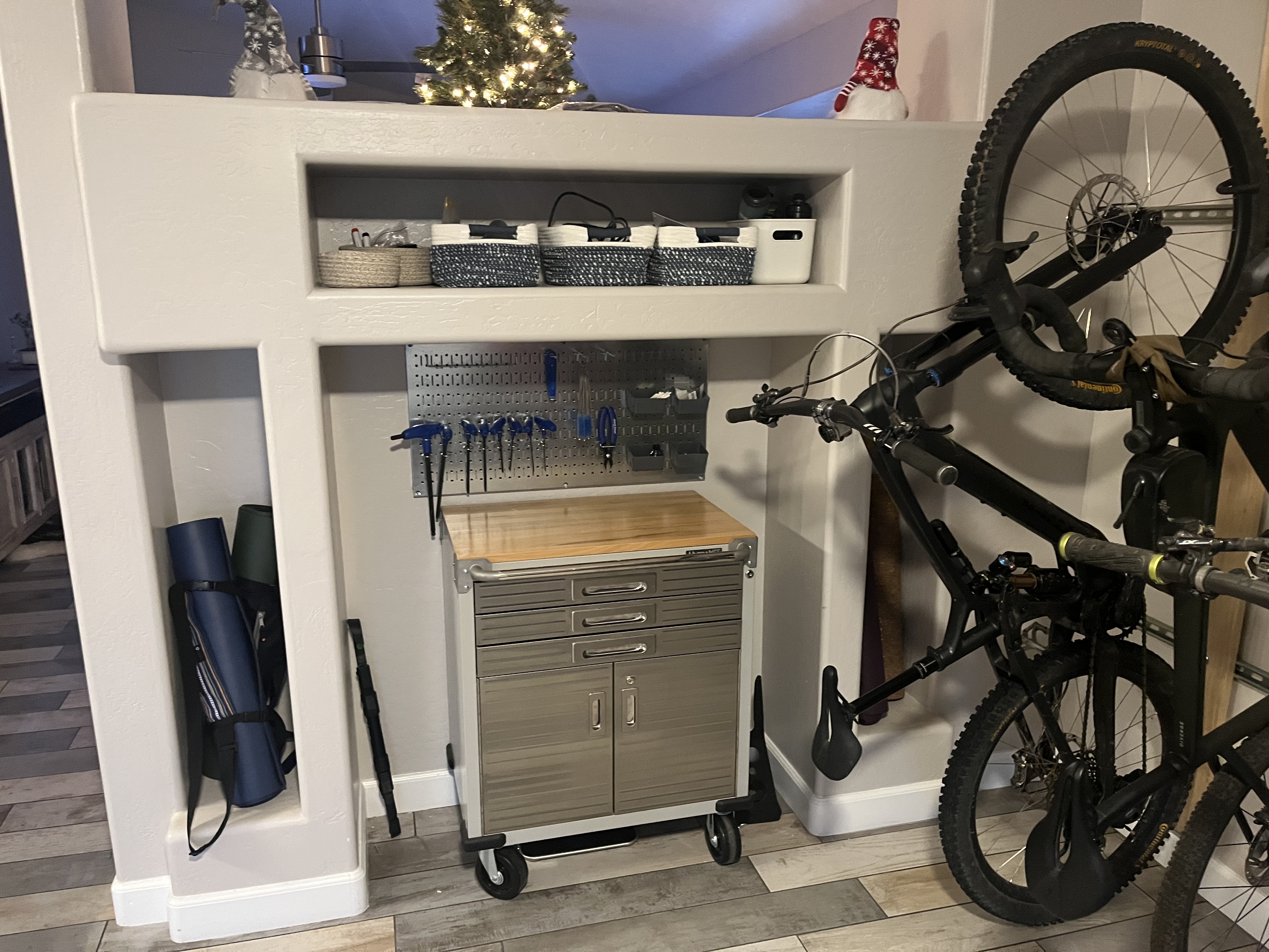

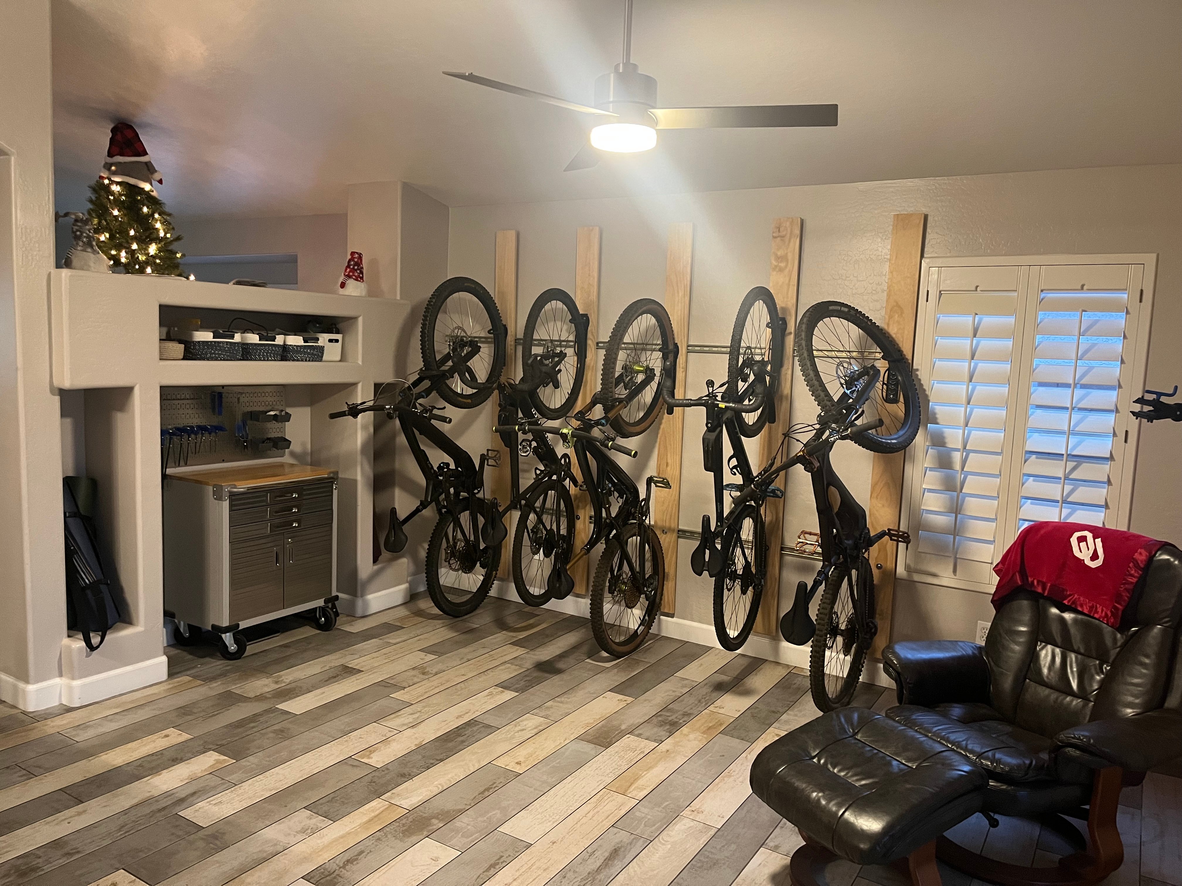

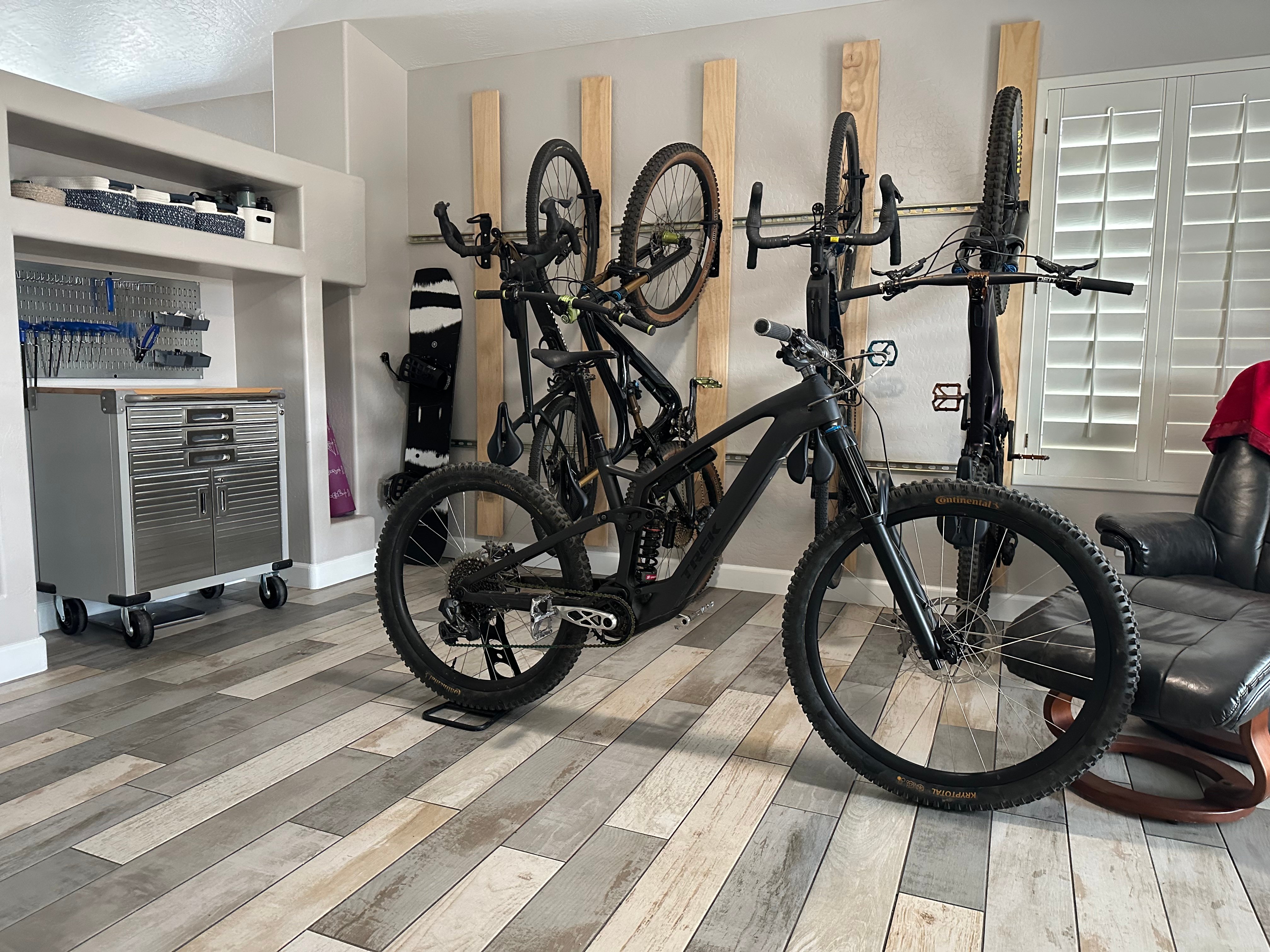

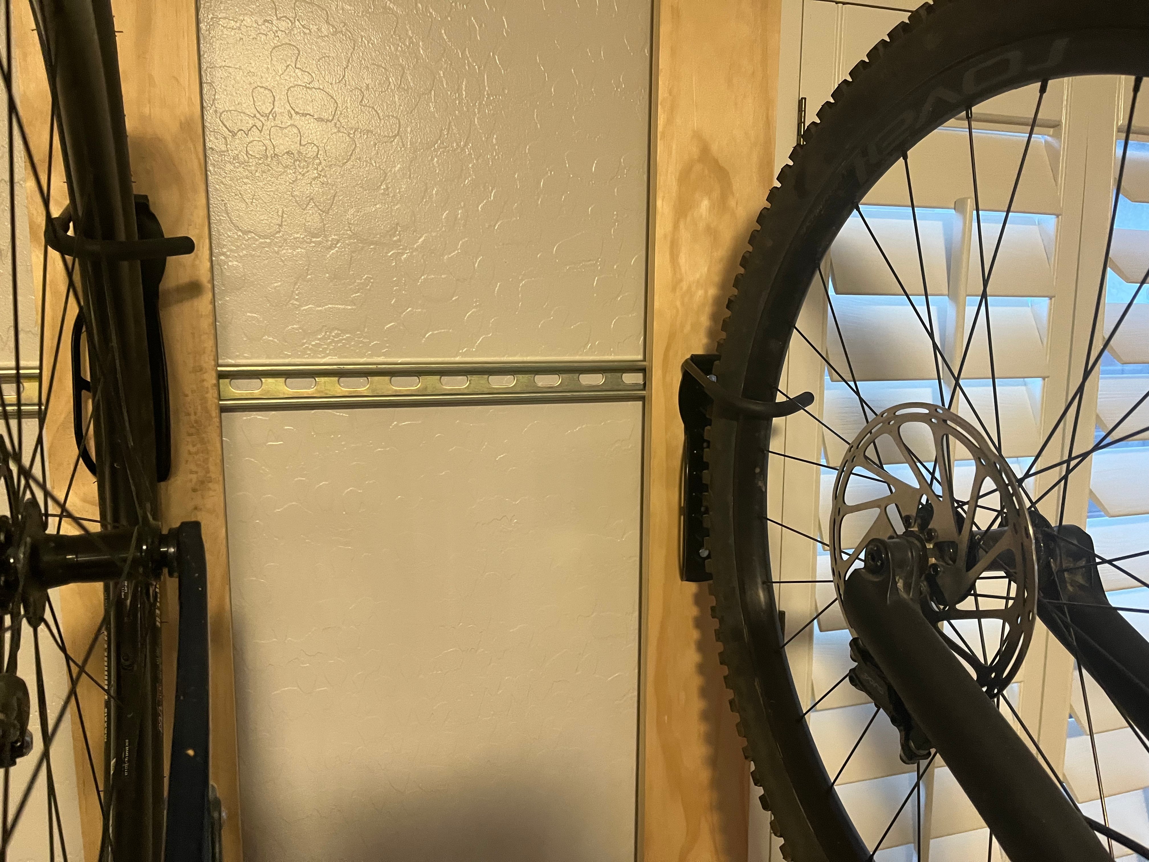

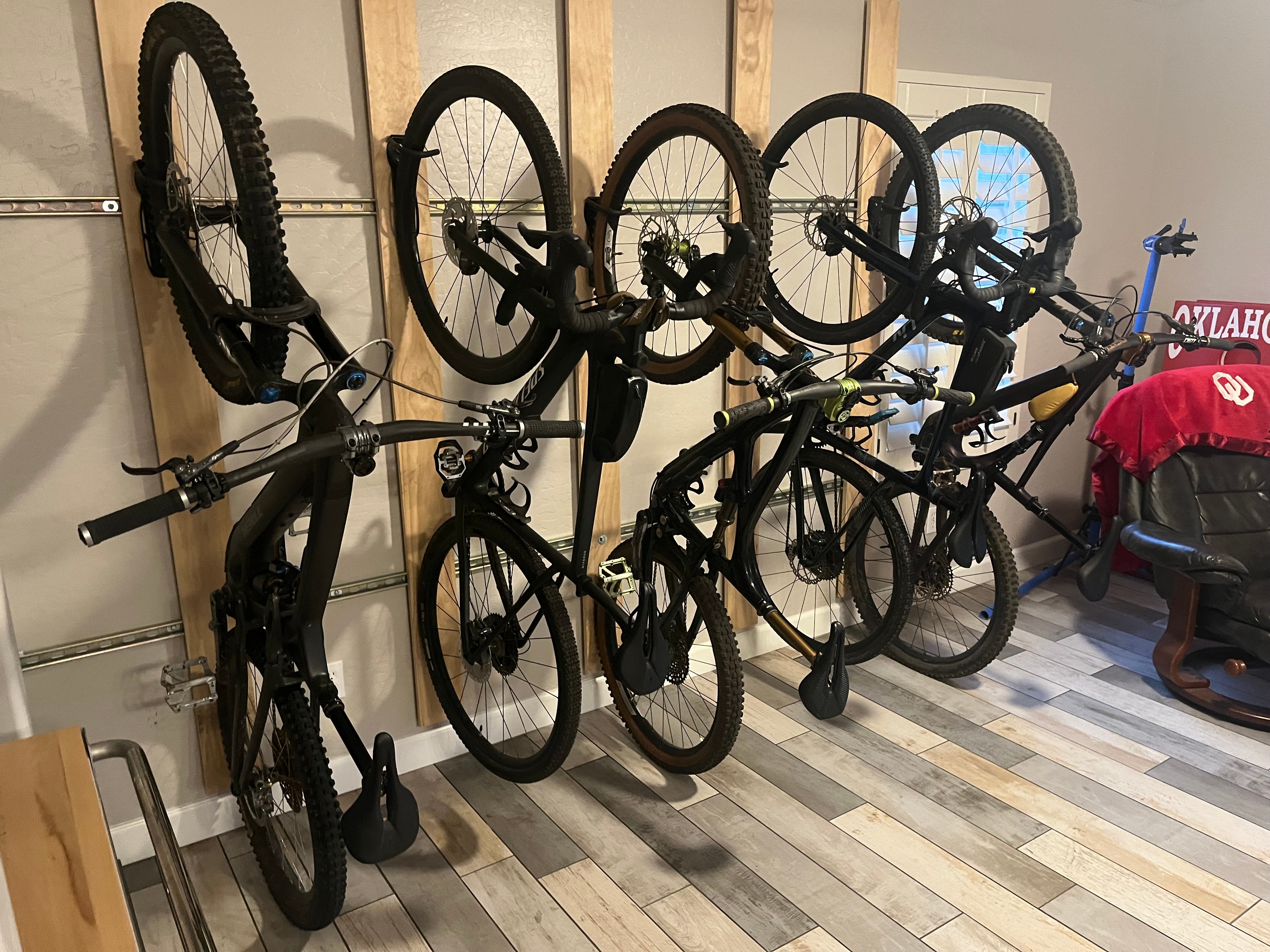

I had a request on another thread to post photos of my bike storage rack. The rack was very simple. Here is a basic material list:
- Unistrut (2 pieces)
- 1” x 6” pine planks (equal quantity to the number of bikes)
- Lag Bolts (1.25“ length is good)
- Unistrut hardware (nut inserts and bolts)
- front bike wheel mounts
Lag bolt the unistrut to the wall using lags. Find studs. Bolt the 1 x 6 to the Unistrut nut inserts and bolts. Lag bolt the front wheel mount to the 1 x 6.
Here are some photos:
![5FFBCE92-CD1A-42E0-B914-5F87E3736994.jpeg 5FFBCE92-CD1A-42E0-B914-5F87E3736994.jpeg](https://www.emtbforums.com/data/attachments/102/102522-991e5990281f54beea52d8c1556facf1.jpg)

![F83A8FC4-1A2C-4152-AABB-DD0A20053085.jpeg F83A8FC4-1A2C-4152-AABB-DD0A20053085.jpeg](https://www.emtbforums.com/data/attachments/102/102518-79e88e423a4ddd0033b567a50028609f.jpg)
![54DF7DED-81E1-405B-A62A-E15C65F2054C.jpeg 54DF7DED-81E1-405B-A62A-E15C65F2054C.jpeg](https://www.emtbforums.com/data/attachments/102/102519-629ed4eb46d51bb290ee0c7f2ccf4552.jpg)
![4233F8CA-6EE7-4EDF-86A1-8B8B9F365639.jpeg 4233F8CA-6EE7-4EDF-86A1-8B8B9F365639.jpeg](https://www.emtbforums.com/data/attachments/102/102520-c5ece7f2c2b8f7313fa0895890473543.jpg)
![EF993D2F-0C4D-4975-B5F4-A4F39292CFB2.jpeg EF993D2F-0C4D-4975-B5F4-A4F39292CFB2.jpeg](https://www.emtbforums.com/data/attachments/102/102521-a178d1437c75bcc6e32015faf390d2e0.jpg)
