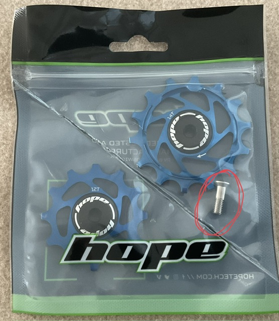

After a year of riding covering 600 miles virtually all offroad, and riding right through the wettest mudiest UK winter I can remember the jockey wheels on my SRAM GX mech had lots of sideplay. They also attract crap for a pastime.....SO upgraded to some HOPE replacements. Unbelievable improvement in shifting as a result.

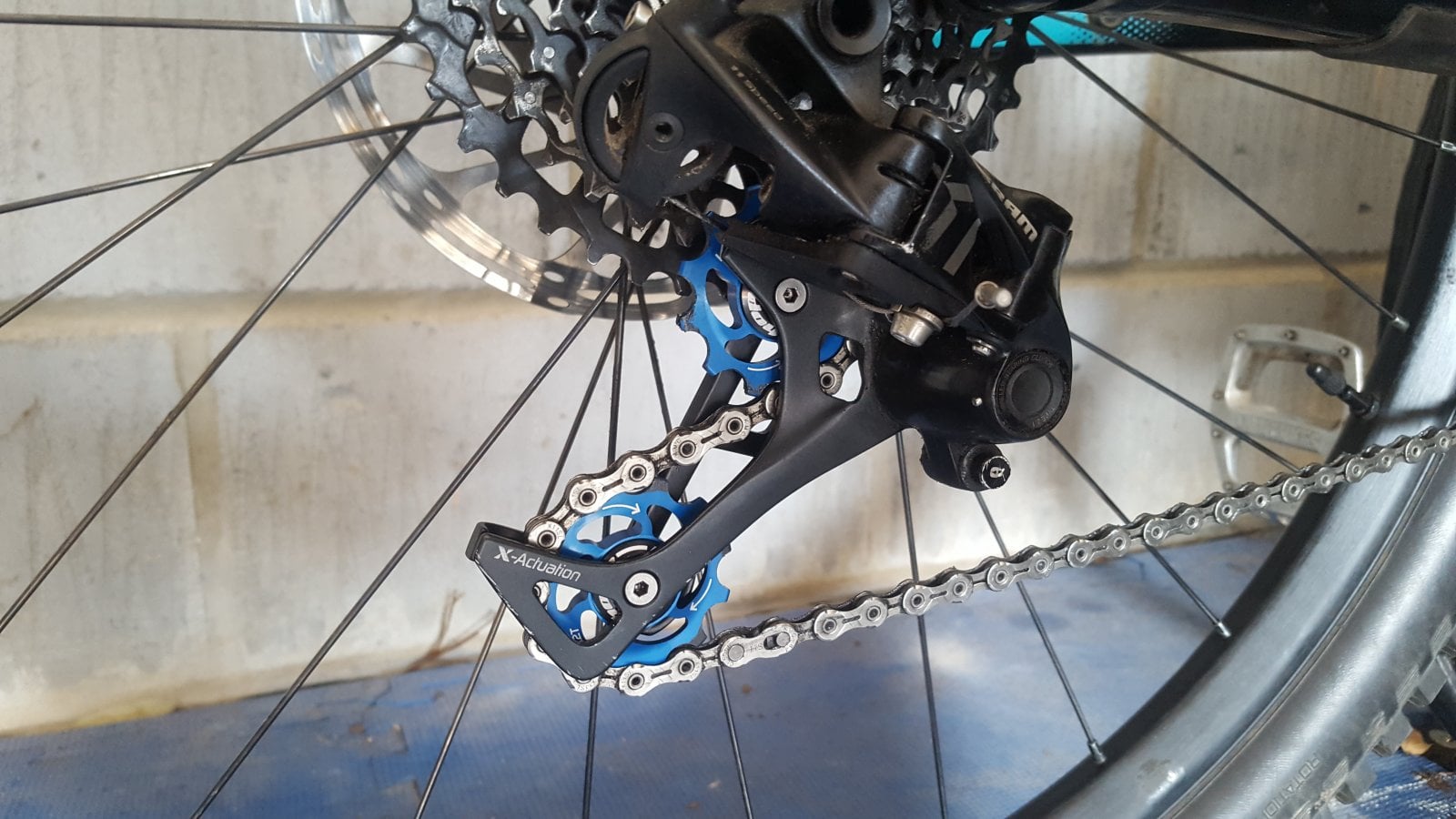

So, like you, I decided to replace with non-SRAM alloy jockey wheels with quality bearings, even though I'd be forgoing the X-Sync benefits. I've got an earlier version of these : Uberbike 12/14T SRAM Eagle 12 Speed Jockey Wheels - Made In Sheffield UK
As they're SRAM Eagle specific it would have been nice if they'd had the X-Sync pattern too. In this latest version they've added a "retaining lip" for the 14 tooth pulley, they say "to solve any derailment issues that may arise due to setup issues". Why they didn't just make it X-Sync pattern instead I can't imagine. But nonetheless mine doesn't even have the retaining lip and in 1,900kms the chain has never come off anyway (btw my bike has no chain guide and is a hardtail so the back end rattles a lot!). And after these 1,900kms, having plenty of time due to coronavirus lockdown, I rebuilt my entire derailleur. I prised the seals on the jockey wheels so I could clean them out and re-grease but I don't think I should have bothered as once I'd done that I could see that there was still plenty of grease in them and no dirt had got in at all - now that's the sort of quality I was looking for! So probably better to have left these extremely tight and efficient seals in place because after prising them out, however carefully, they may not be quite as good as before, who knows.

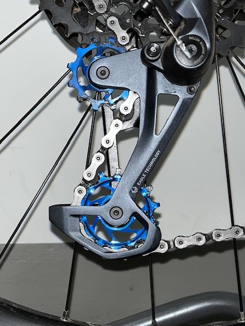

Have attached a pic from which you can get an idea of the current state of the jockey wheels. Yes the anodisation has come off a little, but essentially they're still the same shape after 1,900kms and the bearings feel the same as new and the shifting is still as good as a derailleur with brand new standard SRAM NX Eagle jockey wheels (I've got 4 of them, and two sets of Uberbike jockey wheels,
so in a reasonable position to judge).

Hello,
Thank you for the topic and info about the Hope jockeys. Having serviced my SRAM 12x GX nylon jockeys these days I looked for upgrading and ended with the 12/14 jockeys by Hope.
BUT in general the Hopes for SRAM are hard to find on stock at German online stores., I finally found and ordered today. Is there any reason? Does Hope have probs in delivery or changing to revised version?

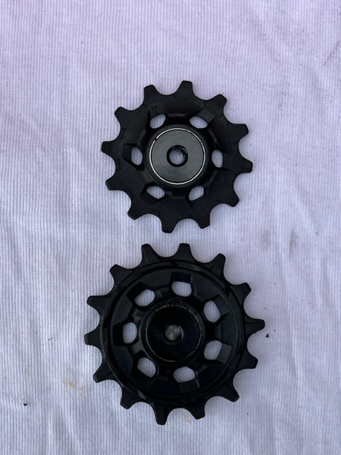

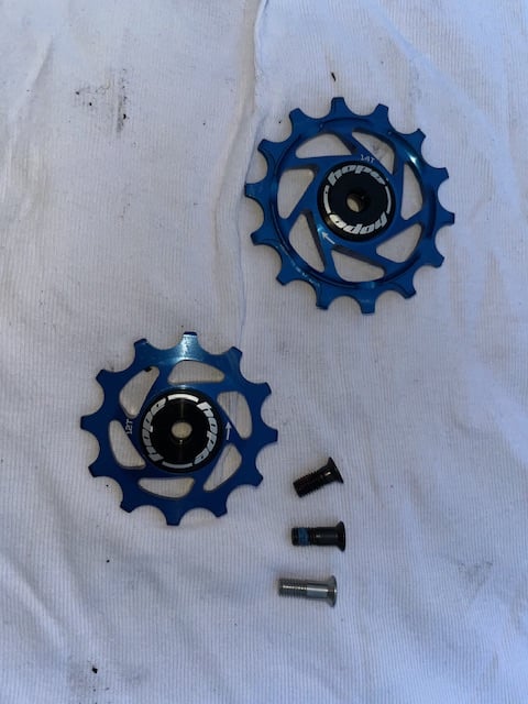

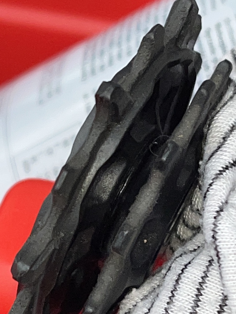

I changed the jockey wheels as the original SRAM GX 2022 started soon to show wear on the nylon wheels. In addition, as mentioned by the TO, these had been real grease collectors.
During the first tour I did not notice a change in the shifting performance that was crisp from the beginning. But when changing gear upwards I feel like it is a louder „clack“ than with the „nylons“.
After first tour quite clean but I found having installed the upper wheel with wrong running direction 🫣

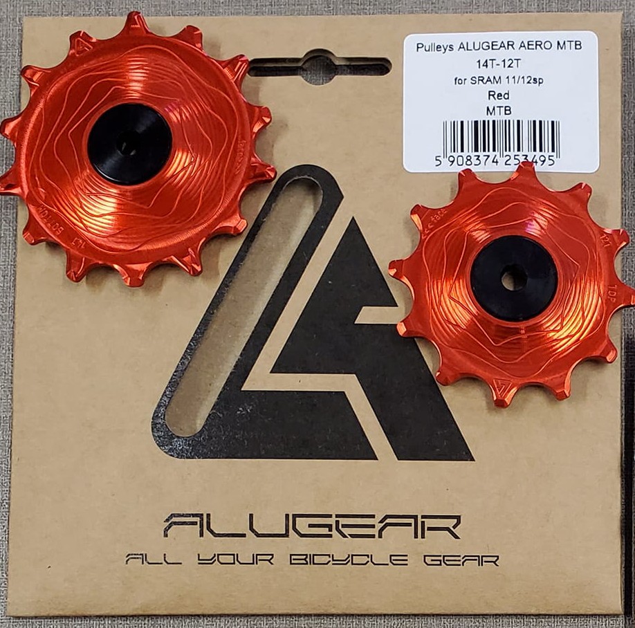

I recently replaced the basic jockey wheels on my SRAM GX derailleur with the Polish AluGear Aero pulleys. Very pleased. CNC machined aluminum, narrow/wide cogs, sealed ball bearings. They are quiet and have a nice, functional design (no openings that would catch branches and sticks, and cause a mess...)
