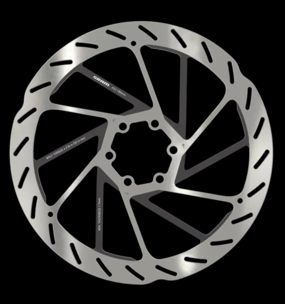

lumpy
🚁 CHOPPER 🚁
Nov 26, 2018
468
441
SF Bay Area
these?
That's what I use. There's other sintered pads. I get better braking power, less fading on long descents. Only negative is you have to drag them a bit to heat them up
