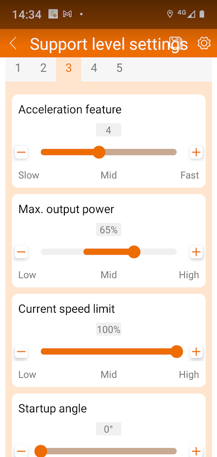

Then you are able to change Level Settings for ECO, TRAIL, SPORT, SPORT+, BOOST (Though it just has 1-5)
Level Settings available:
Acceleration Feature
Max. Output Power
Current Speed Limit
Startup Angle
Startup angle and acceleration apply to all the modes.

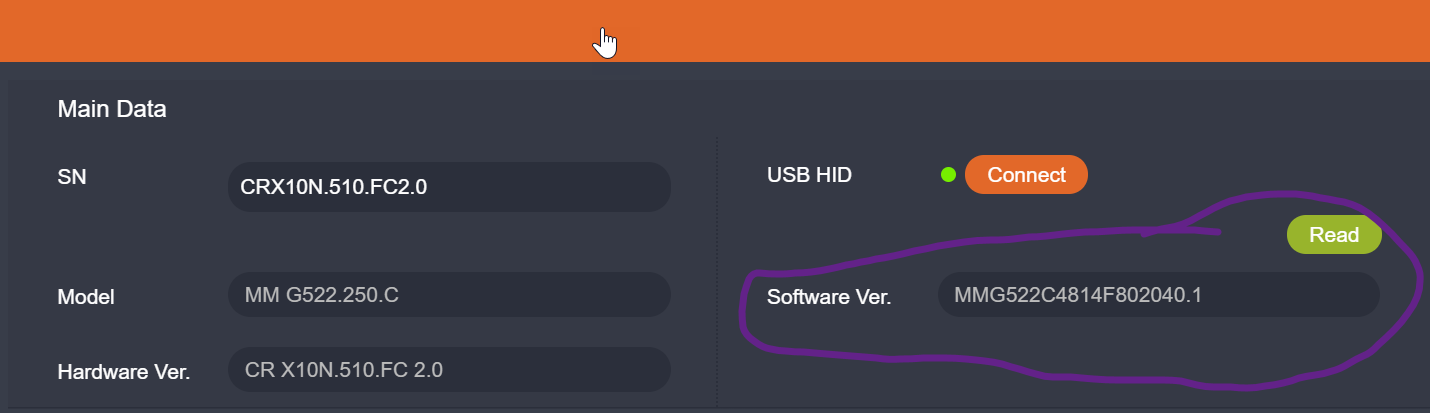

I have the DPC245 v2 on my bike. This is Bluetooth 5.0. V3 has the 5.1.
I tried it with GO+. It connects, but when you try to use it, it says not compatible.
Tried it with GO. I'm guessing this has been re-worked lately as it didn't look too bad. Connection was easy and straight forwards and there are even pages to enable firmware updates over the air and locally (from a file).

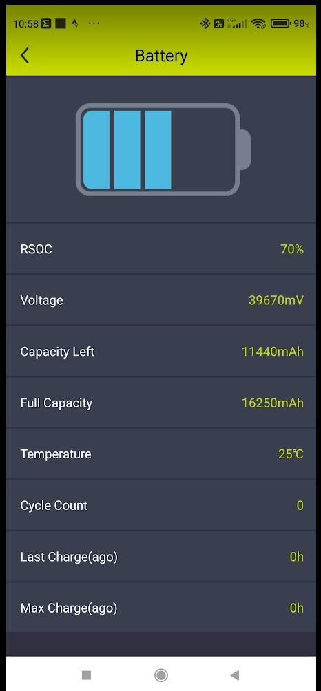

Battery information was correct and updating as the bike was charging. The bafang charging cycles doesn't show actual 100% charge cycles - it just shows how many times the battery has been connected to a charger.

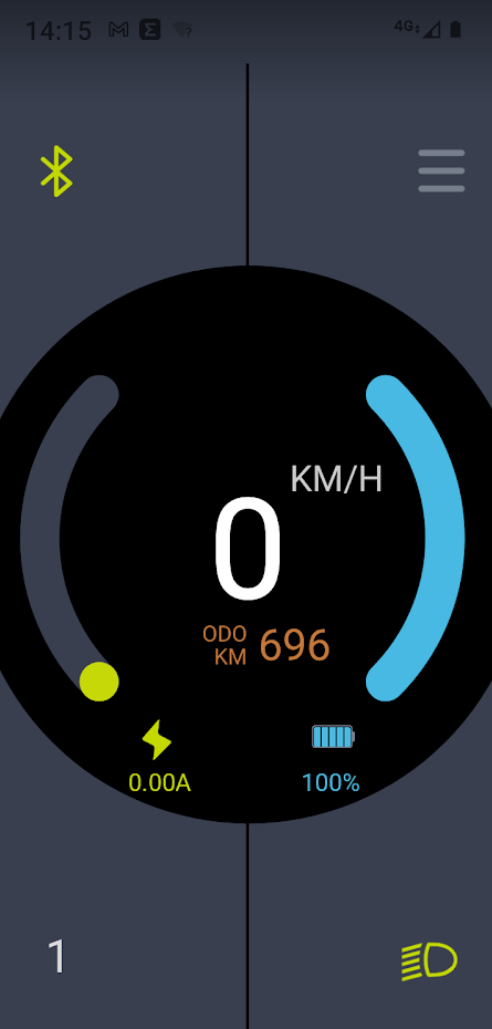

The basic heads up display is clear and simple and gives you various bits of relevant information, including Amps, which you don't get on the DPC245. It also shows which assistance mode you're in (1-5) and you can turn the lights on and off/change the display brightness manually.

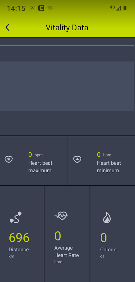

Theoretically you can also match in heart rate monitoring, but I'm not sure which ones its compatible with.

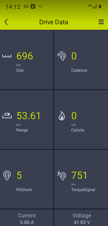

There's various screens which let you see the battery in detail and other things like drive data - where you can see the live torque signal reading, amps and voltage. The PASnum doesn't appear to show which mode you're in, but how many you have available. You can select upto 9 or limit it - maybe if you were lending the bike out you could limit it to only three modes so boost and race aren't available (on a vitus).

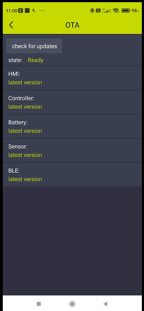

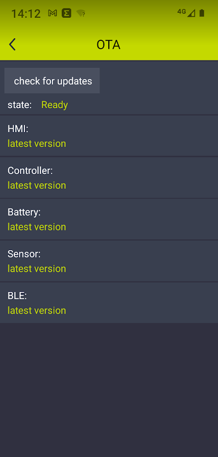

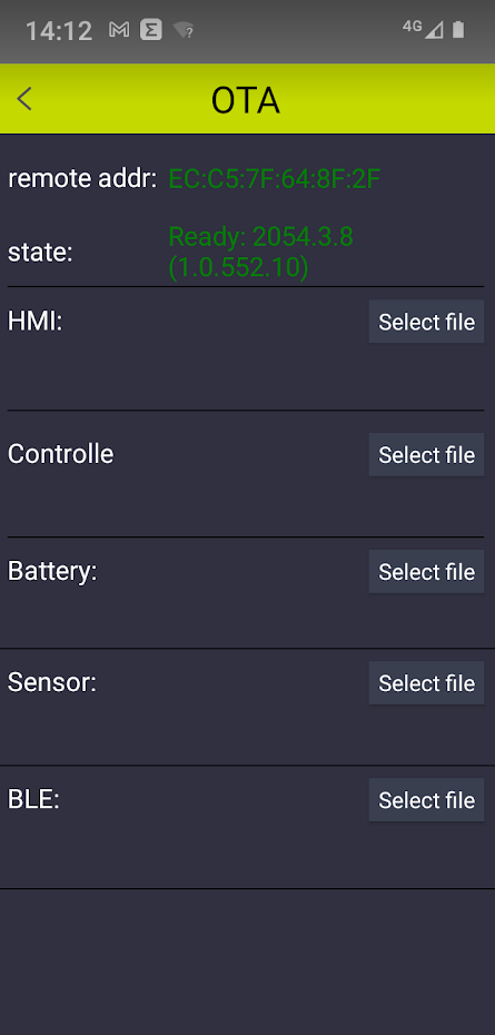

It has two firmware upgrade screens, one for Over the air and one from a local file.
The one thing you can't do is adjust the power settings for the modes, the acceleration or the startup angle.

With "Go", you have to manually press the bluetooth button each time you run the app to connect. With Go+, once you connected once, it automatically connects each time.

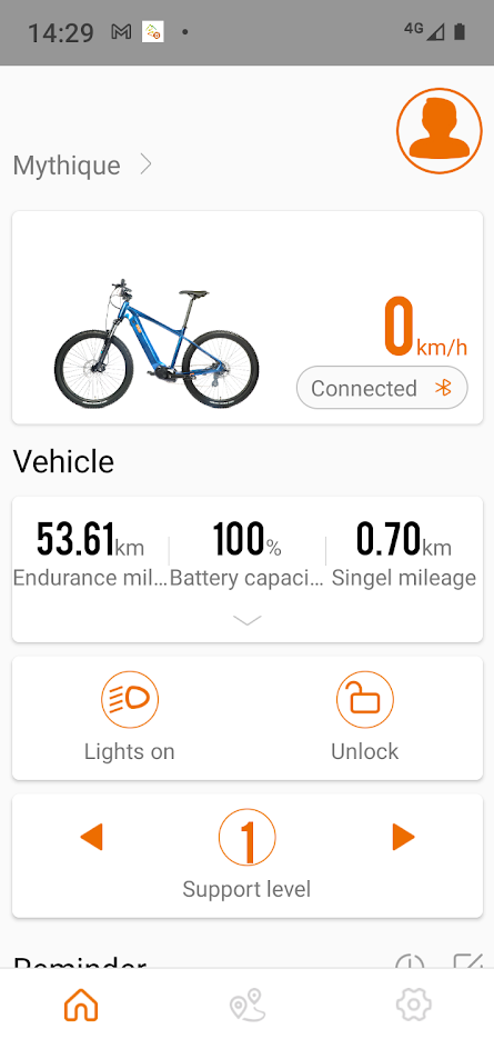

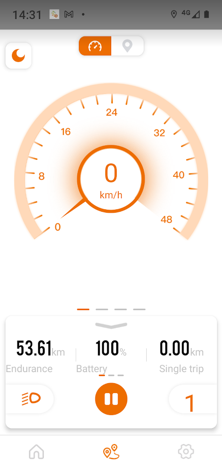

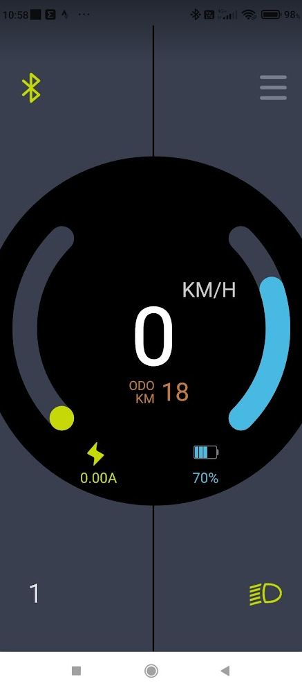

On the home screen you have the basics about the bike, can turn the lights on and off, change the support mode and also lock the bike. Go's pretty buggy and has lots of spelling errors and functions like "unlock" and "lock" are the wrong way round.

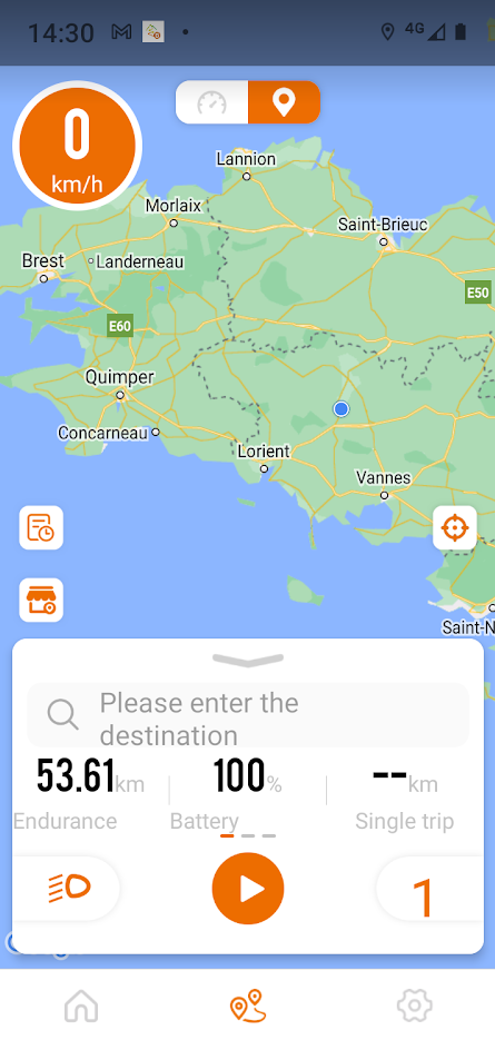

On the navigation/riding screen you have a live map, range, battery, mode. The light option isn't a switch so you can't turn the lights on and off there, you'd have to goto the home page. From the riding screen you can also switch to the speedo display. There isn't any extra information like power/amps like you have in Go.
If you select a destination for navigation, it just runs up google maps instead.

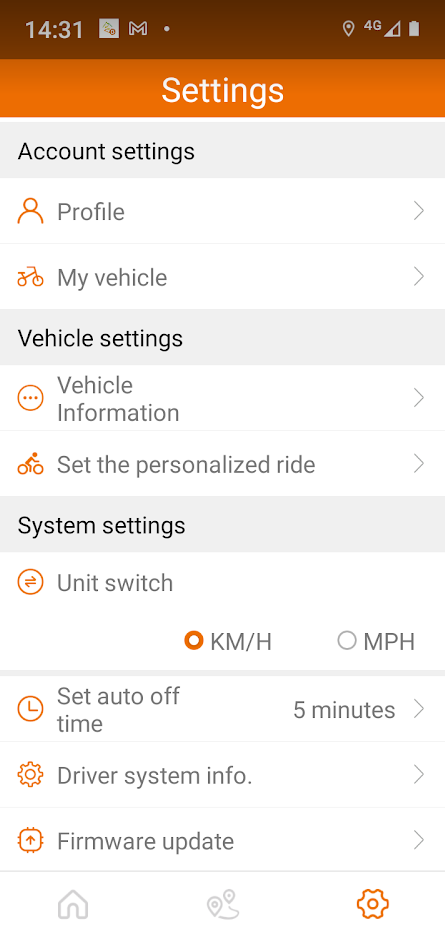

The third section is "Settings" . Where, like "GO", you can change the display timeout, kmh/mph and find out your firmware numbers. There isn't any extra sensor information like "torque sensor" like you have in Go.
Firmware update only seems to show what firmware you have. Possibly this would be different if newer firmware was available, but for me, there isn't so I don't know.

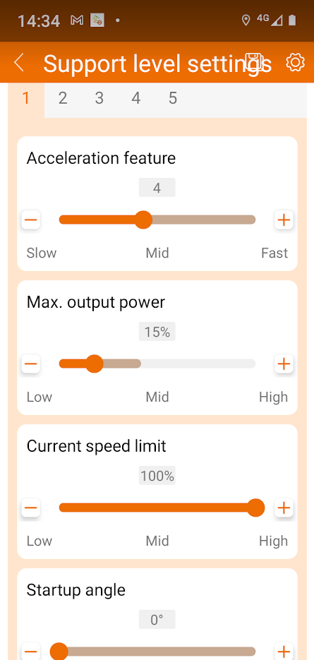

If you click on "Set the personalised Ride", you can change some of the performance parameters for each mode - within certain limitations. Output power has set limits for each mode for example.
There is also a little "disk" icon, where you can save your configurations and have several for different ride profiles.
For some reason, this section didn't work too well for me. When I ran it up, it reset everything on the bike to zero so I had no assistance (walk mode still worked and when connecting the V2 display and GO, the torque sensor still worked, so all seemed good) I'm still working my way through trying to set things back how they were before (Using Go+ as I don't have Besst), though it feels/seems/appears from watching the watts, that it's configured settings which you can't adjust with the app to some bafang defaults. So unless you have a copy of your original firmware to flash back if things get screwed up, I'd advise using the app with caution.
"Acceleration" doesn't really work as you'd expect if you're used to a Spesh setup. Rather than determining the speed that the motor accelerates upto full power, it seems to just work as a delay. Set it to 1 for example and you get about 5-10% assistance for 5 crank rotations, then the power finally comes in as normal.

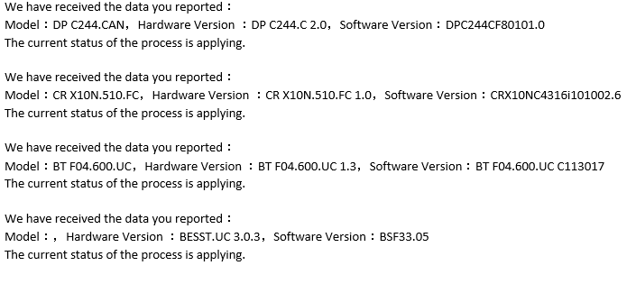

Hi, I would like to use Besst pro tu update my firmware and the update doesn't work. I decided to install python and follow the process below
Python script tutorial​
  • Install python3. Python website.
  • Open the script's Github page.
  • Open the dist folder and download the BESST installer. Install it. This should work for both BESST and BESST Pro.
  • Edit your system hostfile (C:\windows\system32\drivers\etc\hosts).
    • Open notepad as administrator. (Right click > Open as Administrator).
    • File > Open
    • Select "All Files" on the dropdown on the bottom right corner.
    • Select C:\windows\system32\drivers\etc\hosts.
    • After opening the file, add the following text to the bottom of the file:
      • 127.0.0.1 api.besst.bafang-service.com
        127.0.0.1 eu-central-1.api.besst.bafang-service.com
        127.0.0.1 bafang-besst.oss-cn-shanghai.aliyuncs.com
        127.0.0.1 test.api.besst.bafang-service.com
    • Save it.
  • Download loginbypass.py and run it.
  • With the script running, open BESST and insert any credentials. It should login successfully.
it doesn't work too, I don't have access to change parameter or to update firmware.
on my mail box I receive this
what do you think about this?
