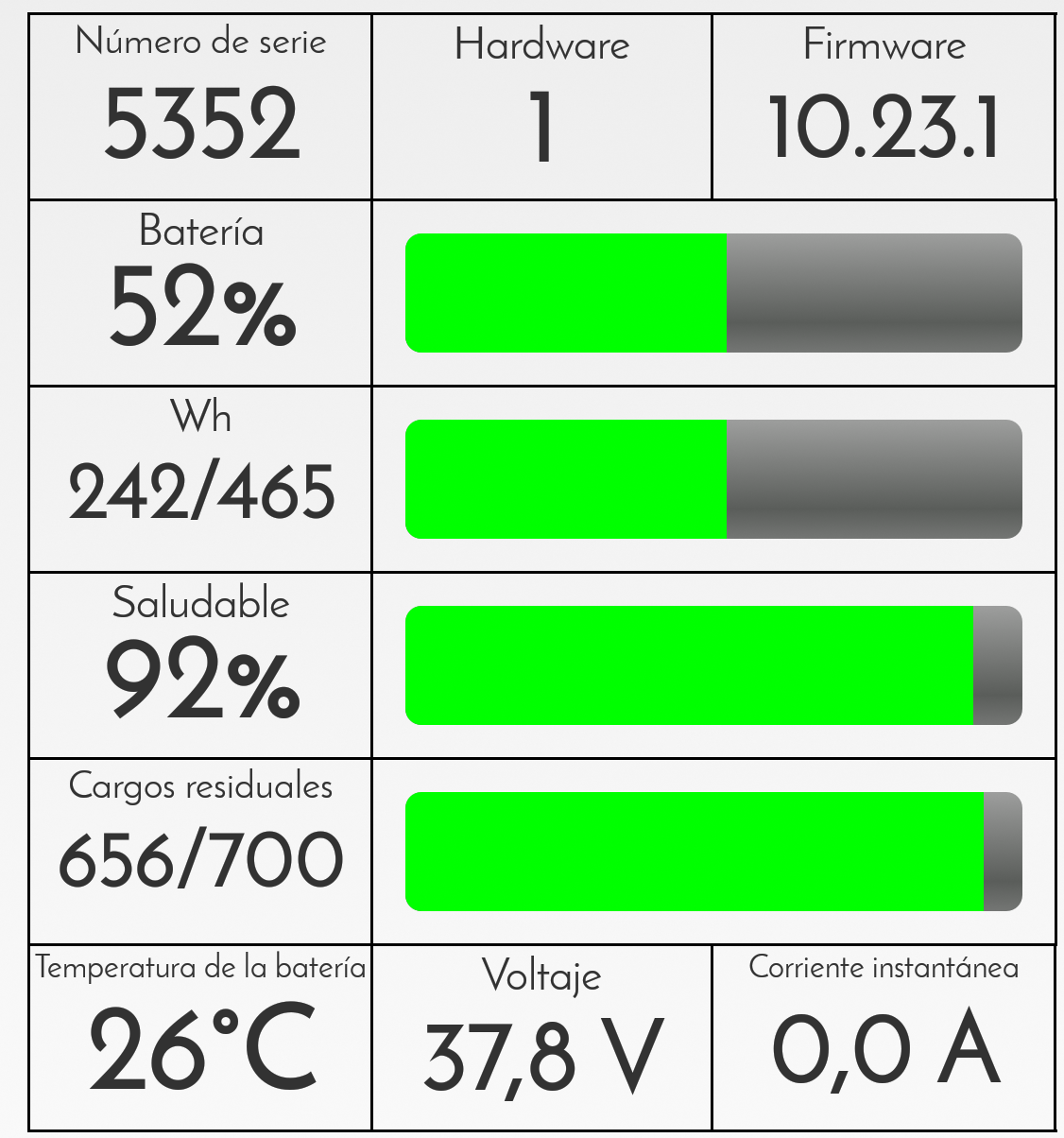

My suggestion is you to Use blevo to double-check.. see pic.

I’ve just downloaded Blevo which is stating my battery is 390wh @100% charge. Being the 2017 it’s the 460wa battery.....
That's 84%. we have to accept that batteries have a lifecycle; that's it. And are expensive :( .

I’m on my 19th cycle and I’ve just dropped to 95%... (or 477Wh!) - personally I’m not happy about that. Bike going into LBS next week for warranty replacement on the command post and code brakes so they can sort the battery out too while it’s there!
UPDATE: with a happy ending...
So to cut a very long story short, as part of testing power outputs of different 1.3 motors, my LBS loaded 10.22.x on my battery and then upgraded it back to 10.23.x (which is where it was originally at).
Now my battery health is reporting it is back to 100% and holding 504Wh’s!

I've used my Kenevo twice, accumulating less than 40km albeit on steep climbs. Battery health now at 90%. I've read somewhere here that this may be inaccurate if < 3 charges and discharges so will use again this weekend and take another sample but it's worrying me at the moment. Nothing that, to my knowledge after some research and advice, the battery / motor has been through should have caused this so very anxious to see how this will develop!
