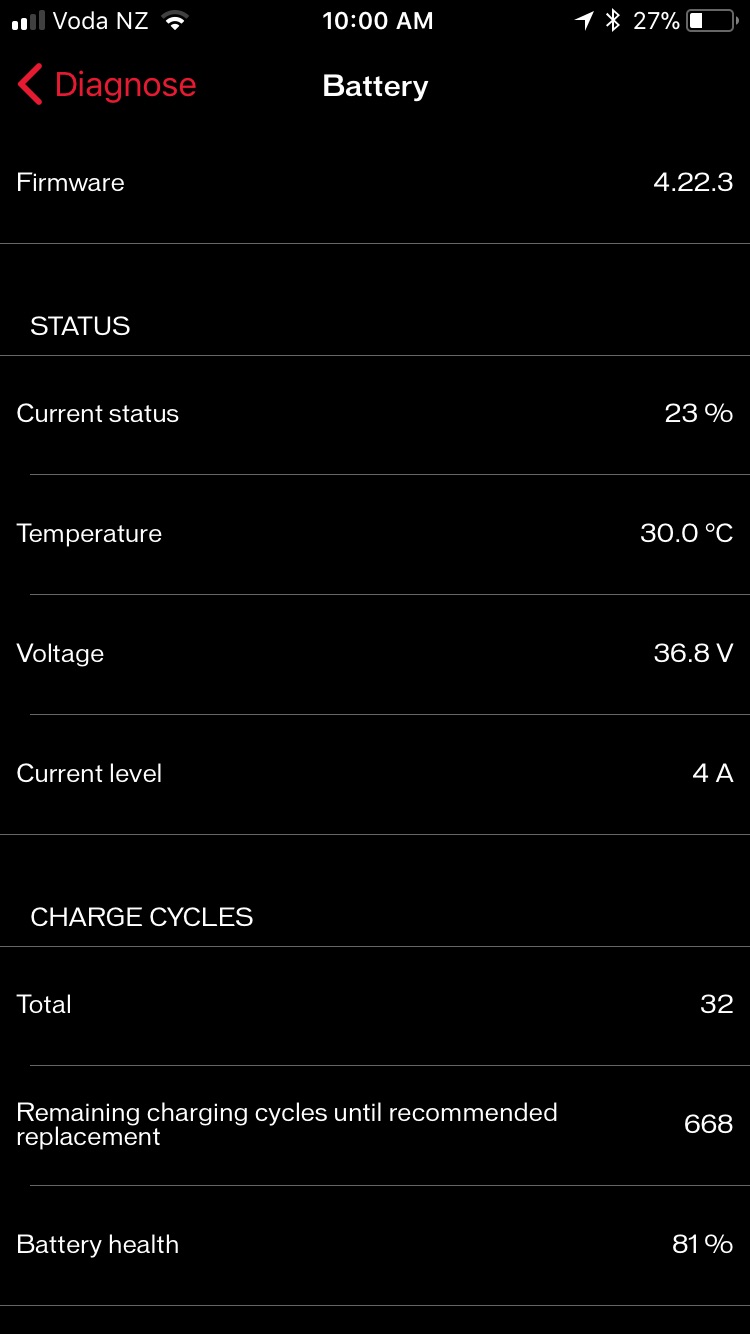

I've done 1123.8km (698.29miles) and the battery has registered only 31 charge cycles. BUT......my battery health has dropped from 95% down to 81% in the last week.
I have done nothing different in the way of charging etc, but concerned that the health has dropped this quickely over a short time.

Unfortunitely cannot be due to the Cold as it is mid summer here in New Zealand, (temps ranging from 27degC to 32degC)

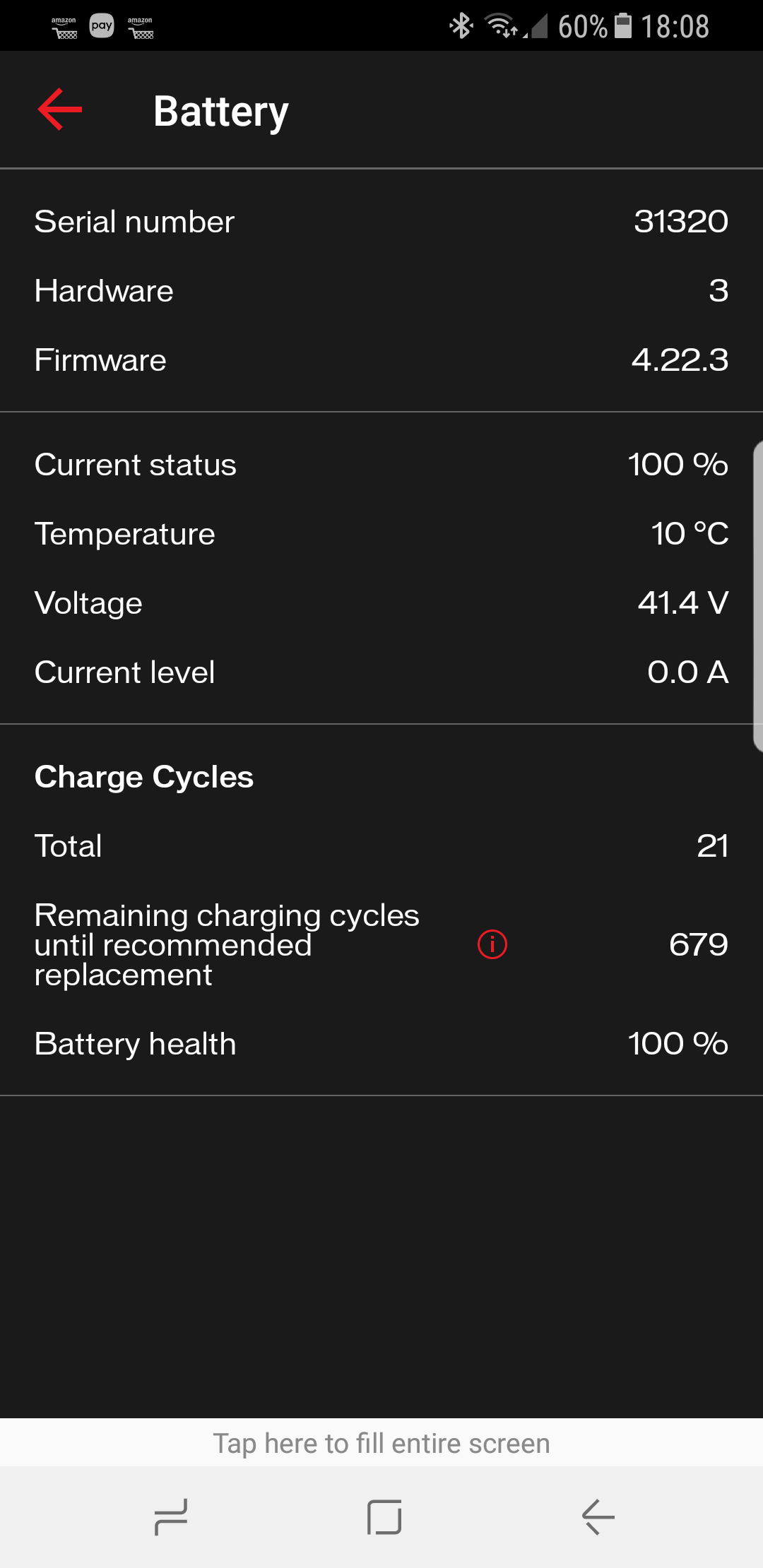

Also I have took a screen grab of the battery health, it is now at 100% :unsure:
I have had a recent FW update on both the motor and battery, I am surprised to see at 100%
ccrdave
Jan 16, 2018
1,405
1,105
uk
I think its got something to do with the firmware thinking its a new battery, mine did the same

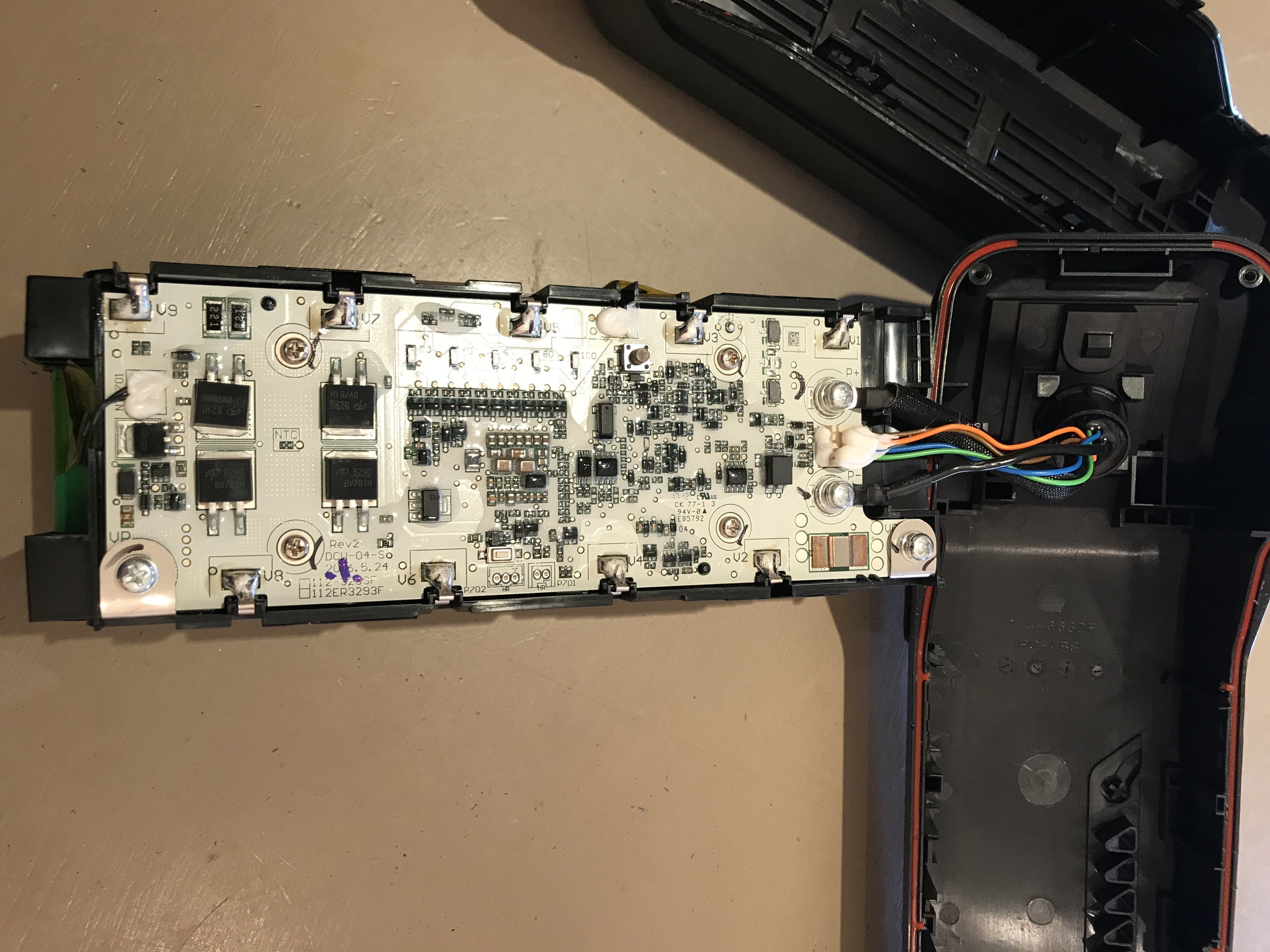

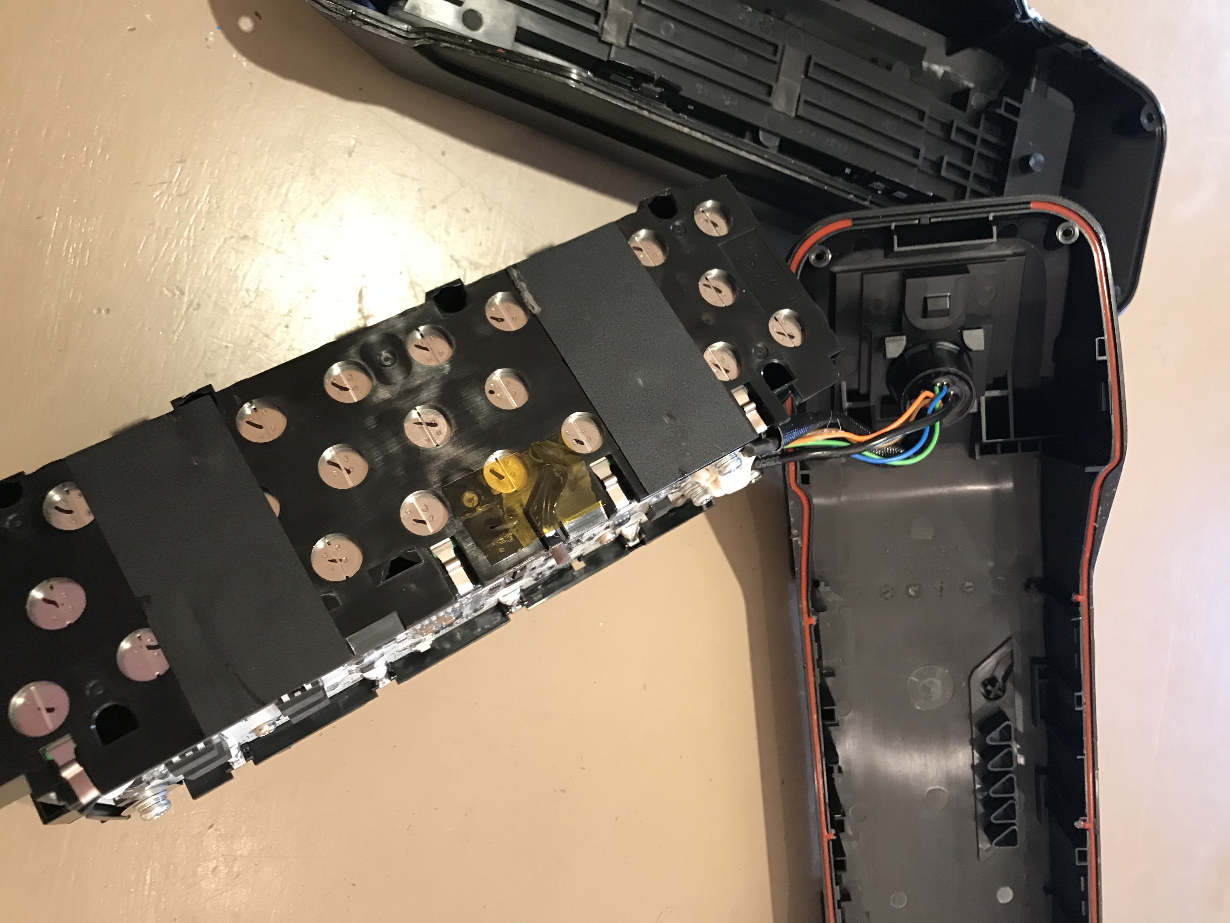

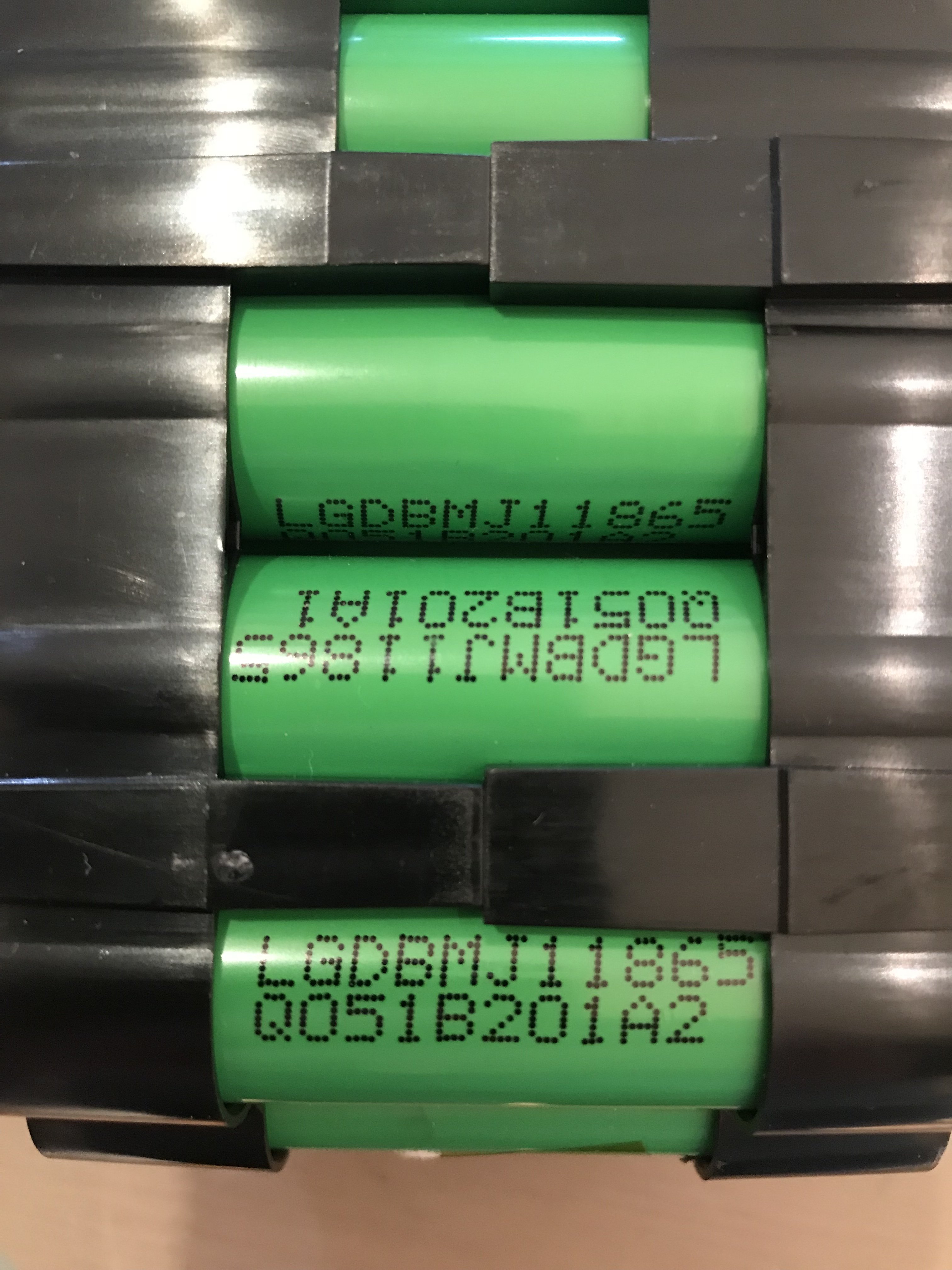

Bit of a correction needed about my bike battery. The apparent low cell capacity based on the packs amp hour rating had me wondering if I could re-cell to higher capacity ones so I took my piggy back pack apart for a look.
It is configured 10s 3p with LG MJ1 cells. These have a rated capacity of 3500mah. They are however a higher discharge, 10A continuous so 30A total from the pack. So plenty for a 250w ebike.
All very nice the pack having fancy cells but no opportunity for increasing range at this stage in cell evolution.

Thanks again for this. I wonder which cells Specialized use? They have different sized packs, do they manage this with the number of cells or changing the type of cells used....
