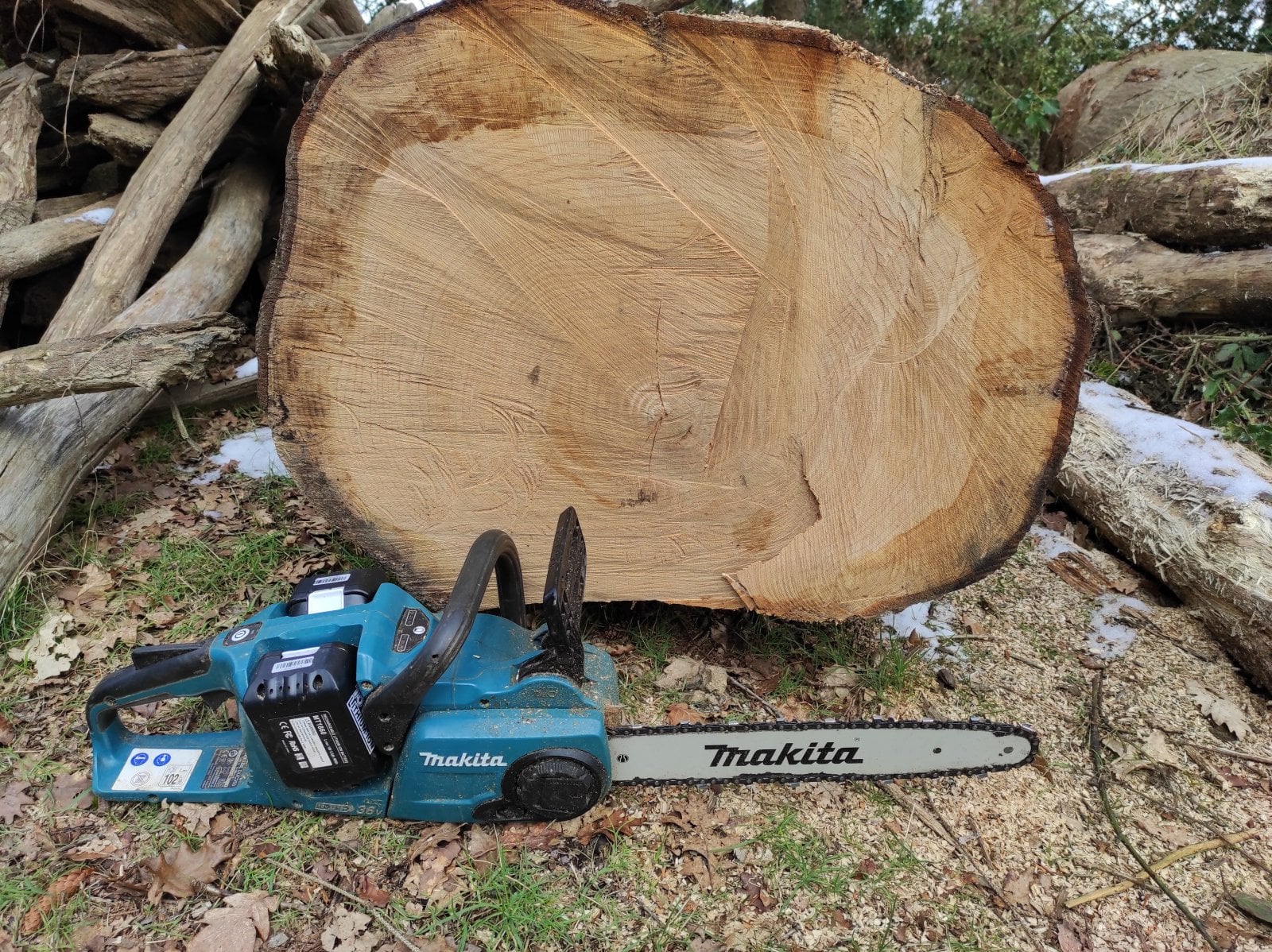

I absolutely detest all my petrol power tools and will always use the battery version whenever possible .. There are exceptions when it's not realistic I'll admit and sometimes you have to admit defeat :

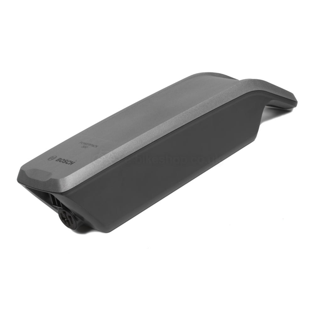

I really think the Bosch powerpack looks like something from the late 70s or early 80s
It reminds me of those early mobile phones. Even the carry handle looks like a silly antenna.

The 625wh battery weighs over 4kg
Wrong. The Bosch Powertube weights 3.5kg. The eBike battery: long range, low weight, easy to charge

Many bikes with the Bosch Gen4 setup are configured like this. Plastic spacer with the 500wh battery, or without with the 630wh battery.

The Bosch 625wh Power Tube from my bike weighs 4.024Kg.........I just weighed it on a very accurate digital scale. I understand that there are lighter bikes with lower powered batteries around but they are outside of my budget mainly so I was simply posing the question - is there a place in the market for for a battery option that would save a bit of weight and hopefully a bit of money. Option being the operative word. I don't want a swap for a 500wh battery that gives none of the advantages I proposed. I wasn't suggesting that Al batteries were just around the corner for ebikes. It's just another battery related point that I thought might be interesting. If Al batteries do become the next big thing in batteries it will probably be Tesla or Panasonic that crack it. You seem to be determined to misunderstand or take exception to everything I've written Hamina...that's a shame. :)
