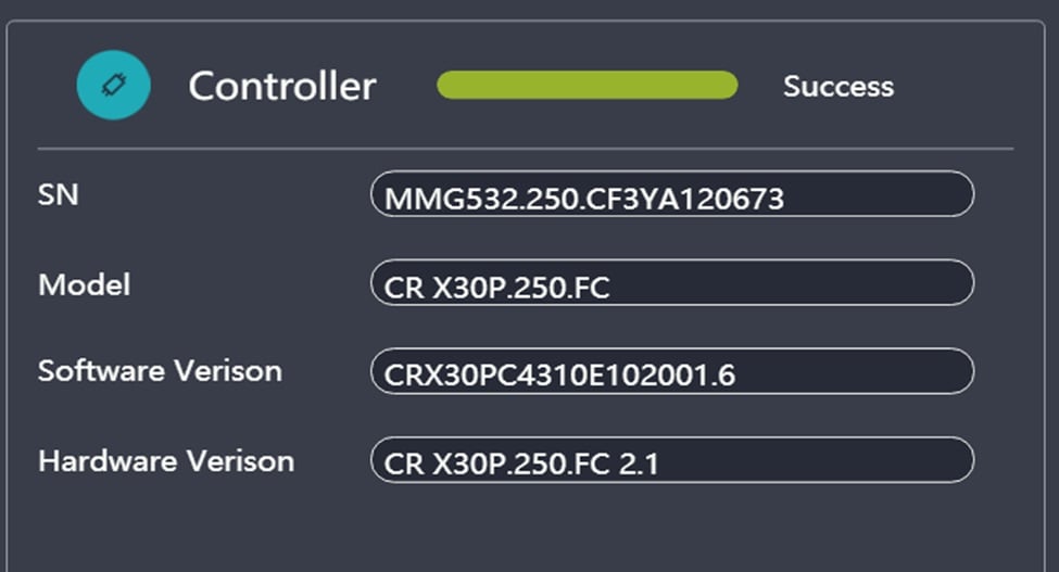

Hi guys!
I just received my M820 to use on my LCE930 with Bafang 43V battery
Current firmware is CRX30PC4310E102001.6 (see attached picture)
Reading the 4 pages here it seams I have a 10A firmware for Road... Is it really the case?
Before updating to CRX30PC4313E102001 3_eMTB_230317 found on this thread, I want to know if the "2001.6" means it's a newer firmware than "2001.3".
Is there a way to backup my current firmware? I don't want to push an older version and not be able to put the one originally there.
Another question: when trying to cloud update with BESST Pro I get an error message saying my serial number should start with CR..
I do have a BESST Tool.
thanks!

Hi guys!
thanks!

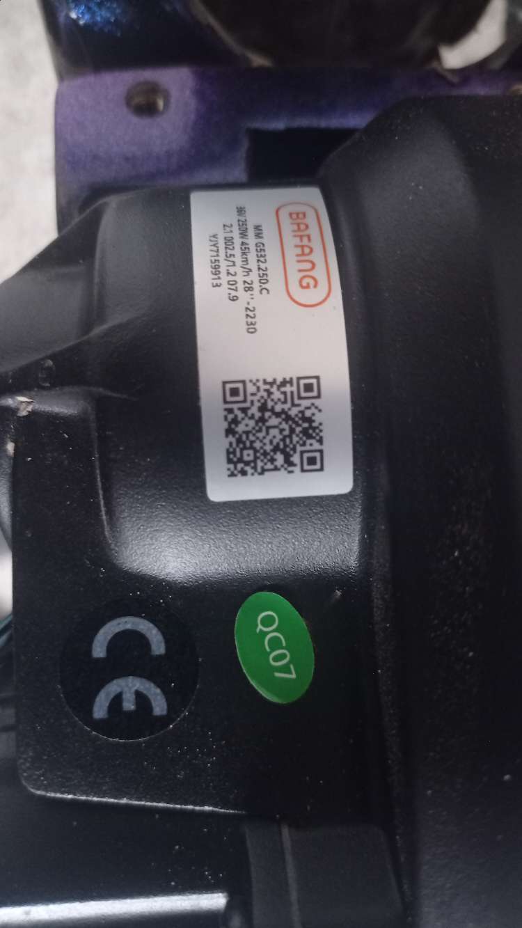

Hi I have a Cef-50
arrived in mid-December with the engine with the characteristics you see in the photo. In the engine you can only find the sticker you can see, no stamped number as in the previous engines. Someone recently received an engine with the same characteristics ❓
I contacted Jean from SZZT to get some information on the speed and firmware since it's an e-road. She tells me that I can't change the firmware because my engine is a 48V and if I do it with Bafang Go+ it stops. I don't see any sticker or punch in the engine that says 48v, do you have any suggestions for me🤔
It can be assumed that if the manufacturer provides FW for 36V, 43V and 48V batteries and does not say that there are 3 versions of the engine, it means that every M820 will support the above software. Therefore, you must have BESST TOOL + FW that you want to upload and that's it (GO+ you will not change the engine FW).
