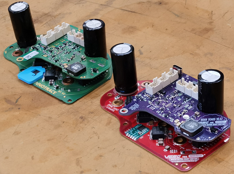

Are there any custom controllers, that focus on a smooth(-er) ride experience, over raw power? Since the Demise of Innotrace, I haven't seen anything in that regard, but maybe I am wrong?
Have there ever been Chinese clones, of that Innotrace controller?

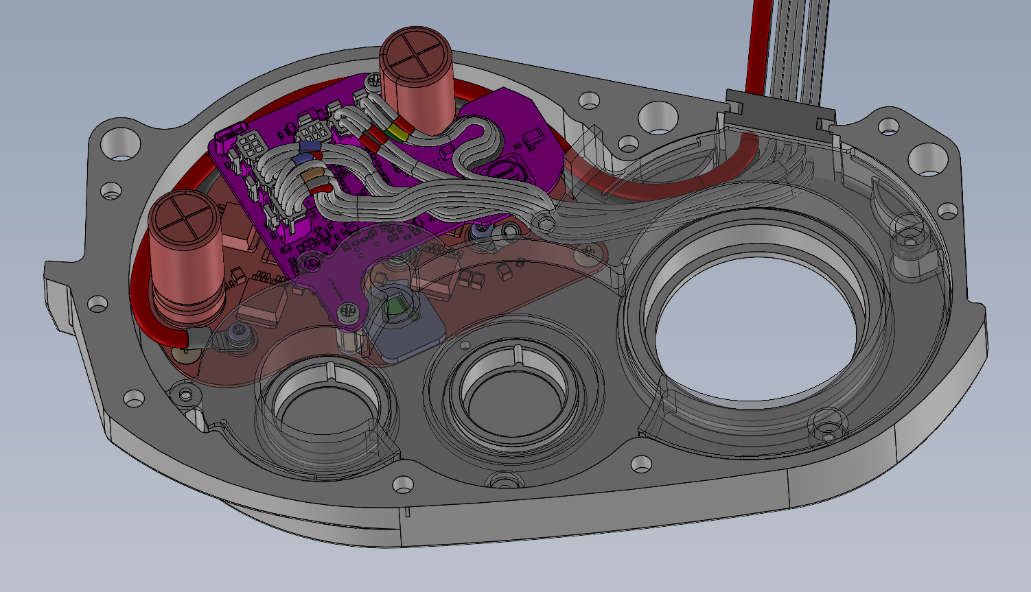

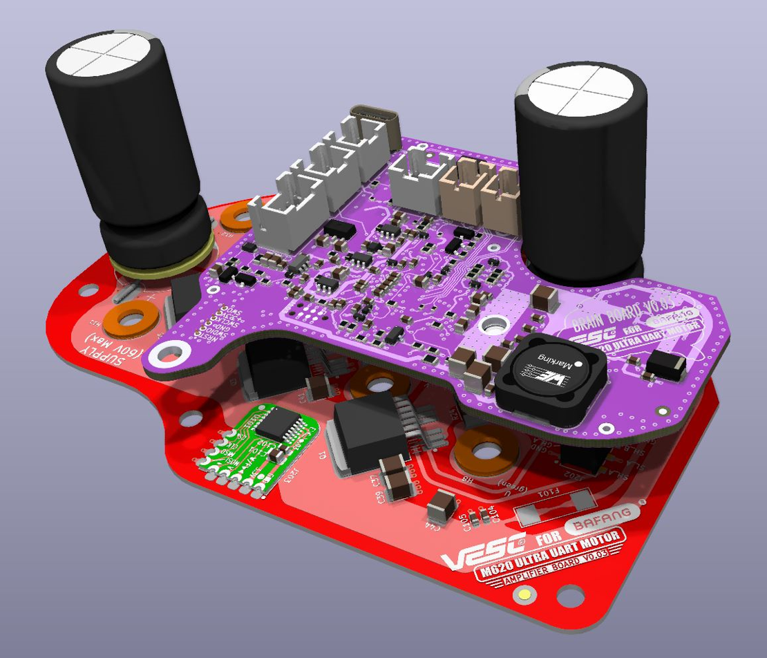

Innotrace controller is open source VESC controller traced on the custom PCB to fit the motor case. I am surprised noone else do their version of VESC controller specifically for Bafang motors considering it is not that difficult for a knowledgeable person (or for not so knowlegable 3 persons, a mechanican engineer to develop the shape of the custom PCB with mounting hardware to fit the motor case, an electrical engineer to trace the VESC scematics on the PCB and a firmware engineer to get the thing works with particular sensors of the motor particular way and adopt the VESC firmware for this particular setup, but each task is not diffcult). Luna Cycle is the only other one I know currently does custom VESC controllers for other Bafang motors but not for m620 or 630.
I haven't had any issue with smooth & proportional ride experience, since calibrating the baseline on the torque sensor (came set at 0Mv, which is never correct; resulted in very jumpy starts & tiny torque sensing range) & spending at least a dozen sessions test-riding then tuning, the Slow Start & torque response at each (¿motor?-)speed range & keep\decay\delay settings.
The tuning is of course highly specific to my ebike's build, my weight, gear ratios, display type, etc... but now that it's done, it rides as smooth & responsively as any high output ebike I've tried; comparable to a Bosch but with loads more power, frankly.
Innotrace has been reverce engineered

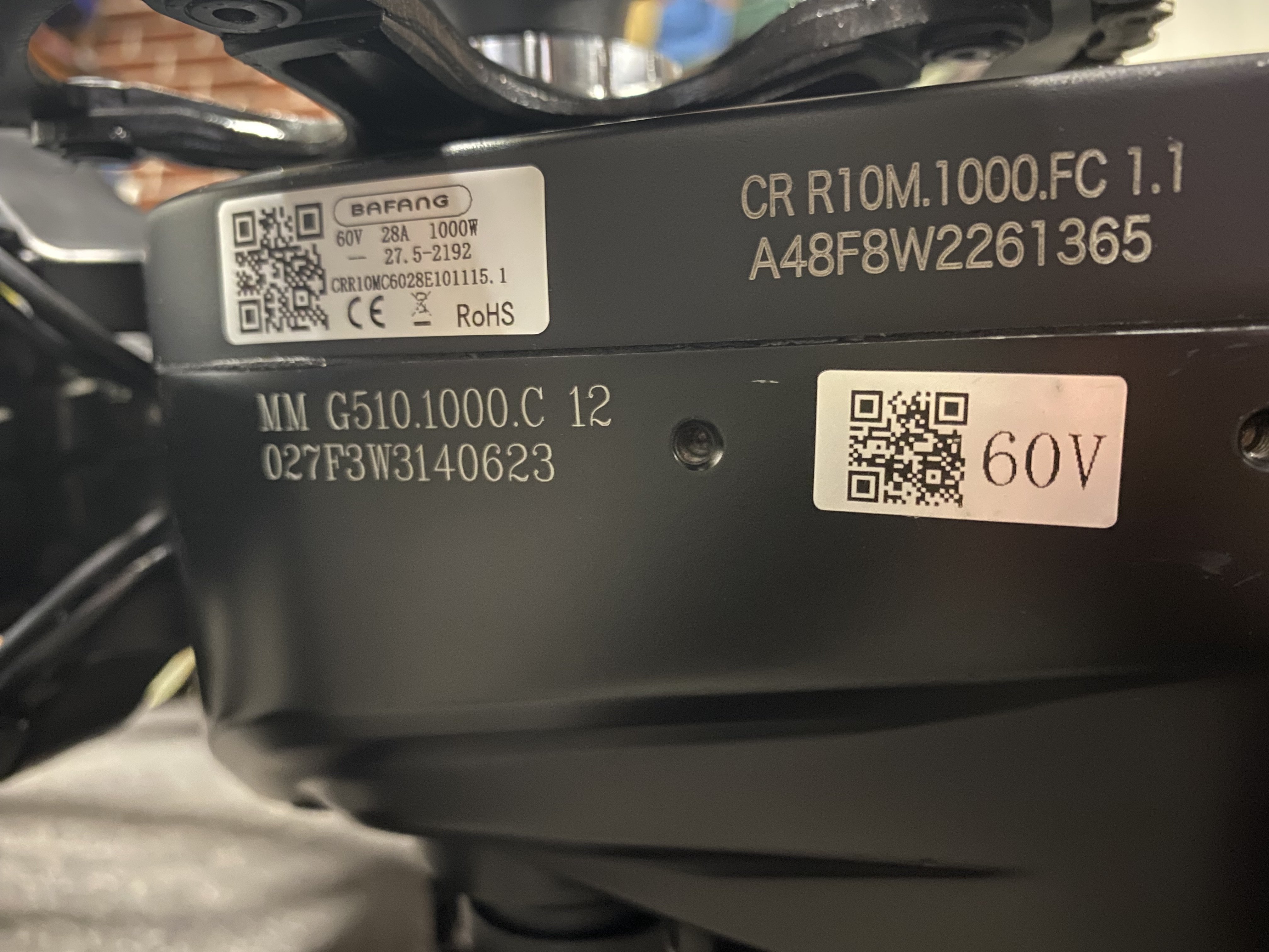

I guess interest died out on the m630 eh? I've been working with bafang and they sent me the m630 60v 30a firmware as well as the 48v40a and 52v35a It took me awhile to have them raise my security clearance on the besst tool to unlock 37 mph as well. There doesn't seem to be any "peak" power output on the 60v firmware, it goes to 1500 watts and stays there. (I have the 1500 watt constant power firmware) I was hoping i would see the 2kw peak or at least 1900 watts pop up on the screen like it theoretically should but bafangs firmware limits the output. We talked for a solid month and they only way they would greenlight true 60v 35a versions of the firmware or versions of the firmware with say a 30 second long peak at 1800 watts before dropping to 1500 watts is if i ordered 100 units of the motor lol. I've got it paired with the a510D with a 46t front chainring and a 30t rear cog, just trying to dial in the external gearing so it will actually push to 37 mph. Last test I did it was topping out at 27, i think my front chainring is too big since the motor comes with a 36t front but I will play with it. The a510D shifts like a dream but it shifts very fast on a little 20" wheel lol. you can barely feel it shift and it is basically dead silent. I would say the a510d is half as loud as your average freewheel clicking noise. The m630 is also alot quieter than the m620 I was very surprised at how quiet it was.
