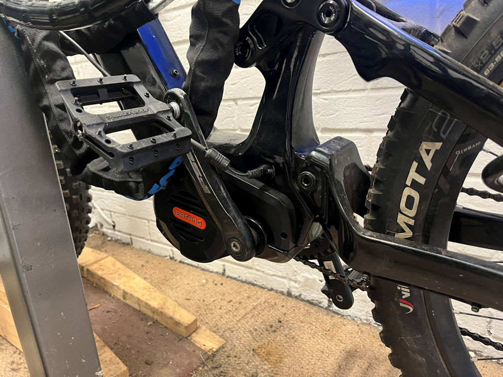

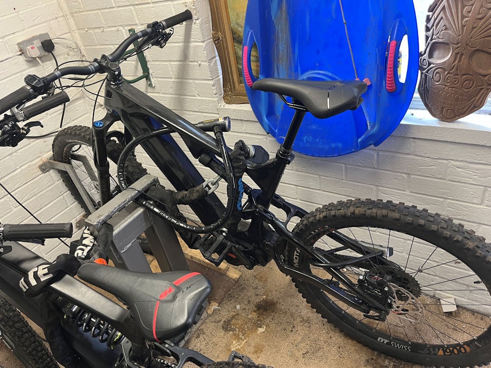

I have a carbon frame fitted with M620. If I remember rightly, it's an E22; I bought it from Carbon Cycle off eBay a couple of years ago. I think the battery is 48v/17.5ah/840wh/Samsung 35E cells.
Can anyone tell me when the M630 is expected to be available; and would it straight swap into my frame.

Hi @Fencer
The M630 shares the same mounting position as the M620.
However, the M630 is CANBUS ONLY. Meaning that if you're using uart, the entire system will need to be swapped (display, wire harness etc).
Currently, I haven't seen too many M630 ebikes using conventional derailleurs, chains and cassettes. Moreso, using the new hub.
Kindly bear with me as I have received numerous enquiries about the compatibility of the M630 system with M620 frames. I will share what I learn soon👍🏿

Hi @Fencer
Thank you very much for this Neeko; very kind of you.
My M620 is CAN protocol, so no problem there.
What I really need to know, is where I can purchase the M630 [and/or hub]?
And yes any other information you learn will be greatly appreciated; also very kind of you.
