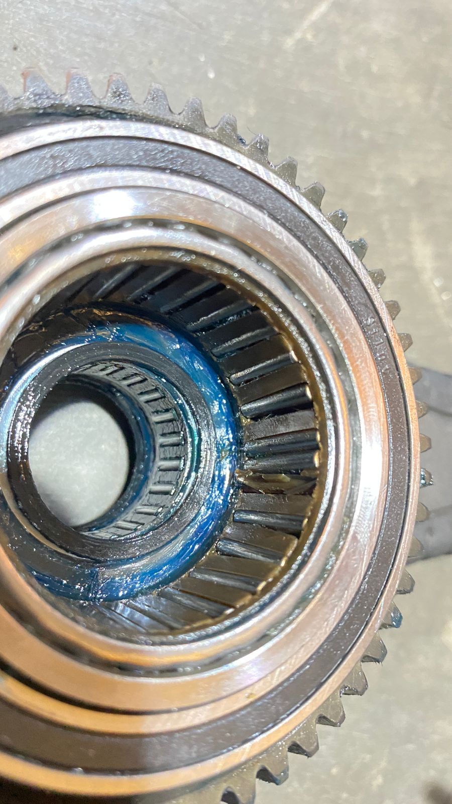

Same problem on my M500, and this what happened on motor freewheel. can't find local bearing, have to order from bafang :(

I took it apart today. Didn't see any damage anywhere. There seems to be only 1 one-way bearing in there.. It's smaller gear next to the motor drive gear. I have about a 100 miles on it now..

thanks.. that got it fix.. I added more grease in there an it made it worse.. So I cleaned it all out with brake cleaner and didn't put any grease on the big bearings you can move in and out.. also didn't put any on the "clutch" outside that those slide over
.. you could tell a difference and feel the little roller bearings move in and out once it's cleaned.

Hi temon10, I got the same problem.
Did you solve the problem? I have the exact same problem with the needle bearing. Did you remove the defective bearing yourself and install a new one? Was that complicated?

i bought a new bearing from chili. and it's working.
