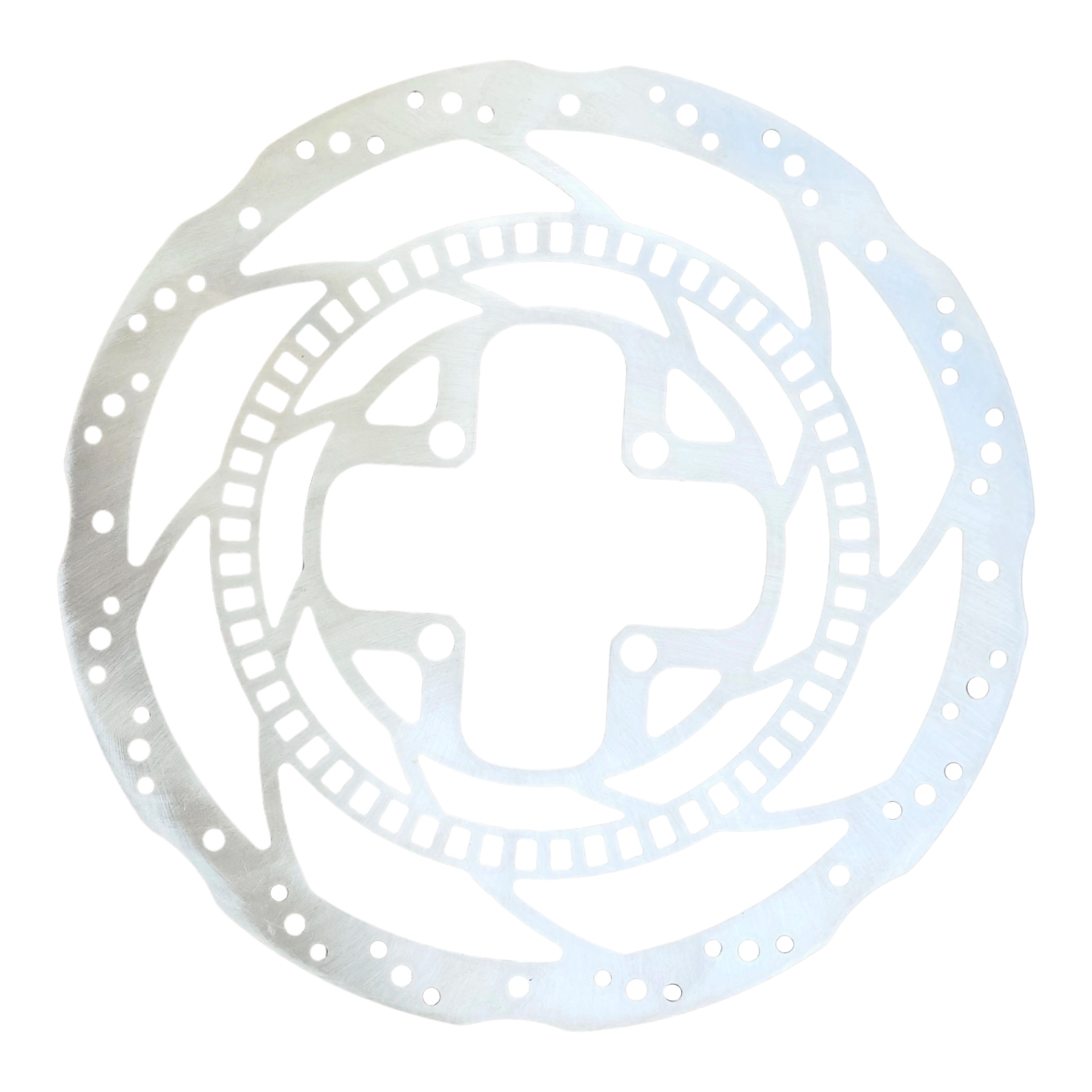

Do not expect any better climbing or better pedalling behaviour from disc speed sensor.
There is new torque sensor with new pas sensor. Looks to me now it is optical. I see there bigger disc (looks like plastic) with 48 impulses per revolution.

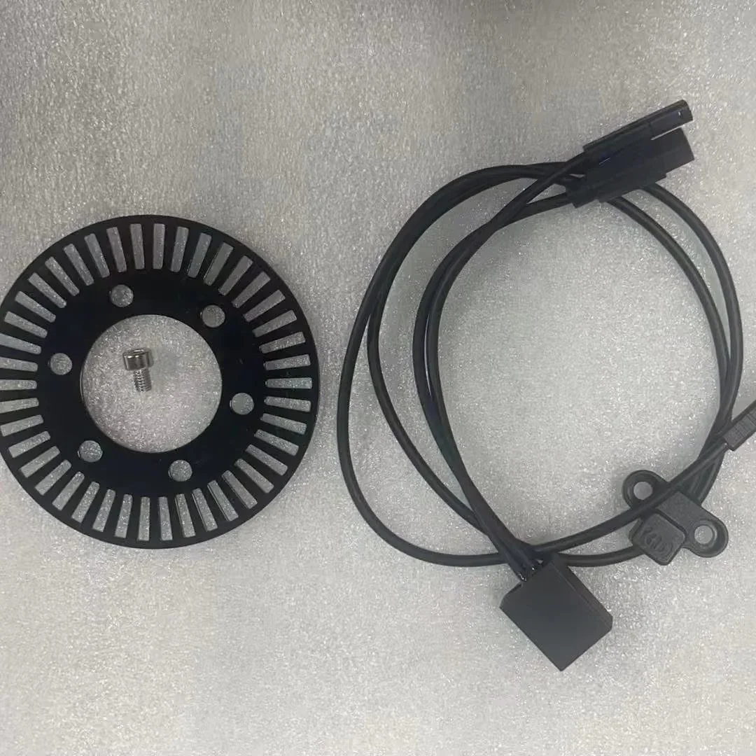

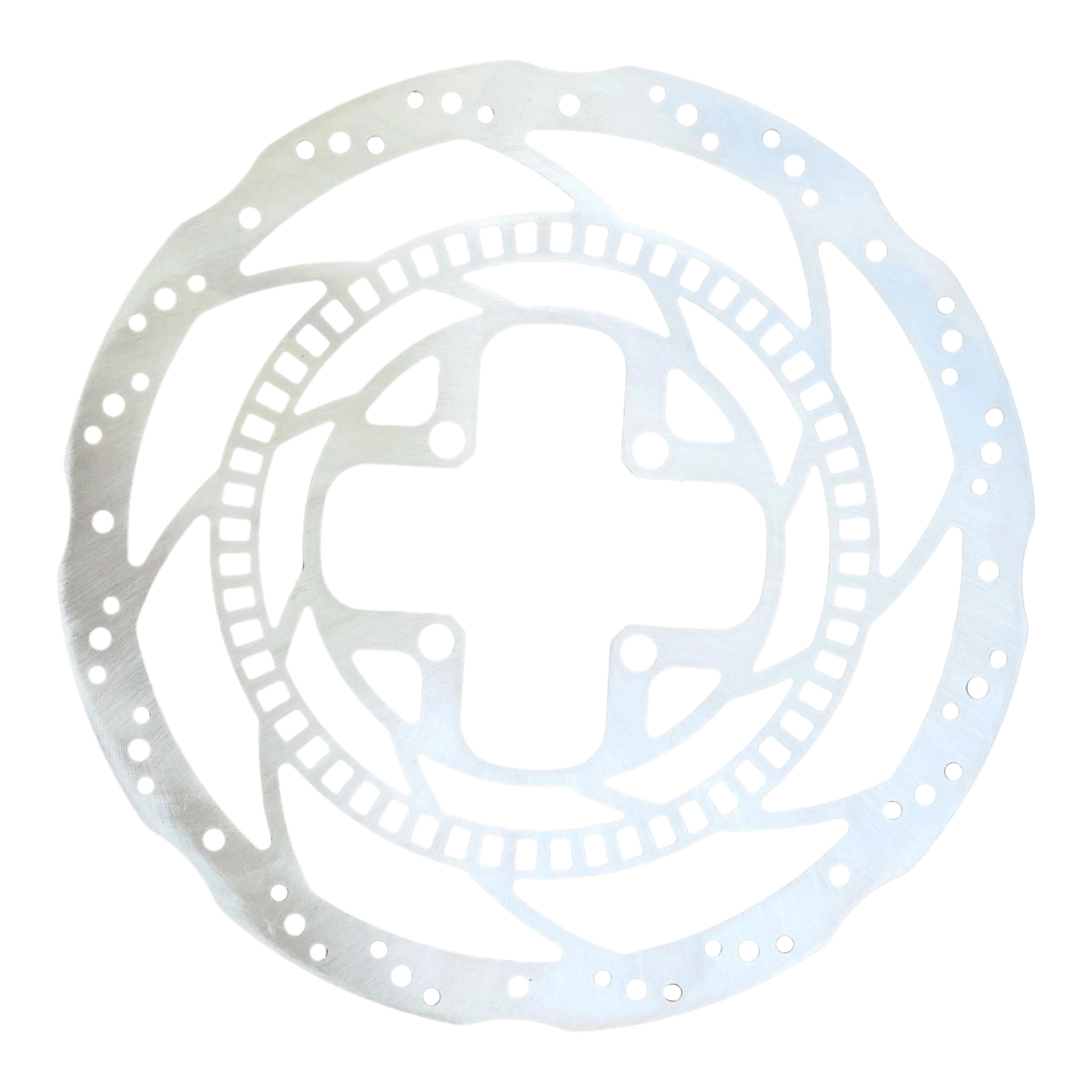

I would like to hook up the M510RS or M560RS to a Rohloff hub. Since the Rohloff uses a specific 4 bolt mounting for the disc, it is not possible to mount the encoder. I could order an ABS type brake disc for the Rohloff hub. But the number of teeth differ. I believe it is 42 for the Bafang system and 56 for the ABS disc. Is this number fixed in the software or can it be changed? Does it even matter? Or is there a workaround by giving in a different wheel diameter?

It might be close enough so you can compensate the wrong speed reading due to different amount of the openings just adjusting the wheel size in the display settings.
Hello.
I doubt Bafang will allow to enter number of holes of speed disc. I hope they will also release a firmware version for "old school" sensor - one magnet.

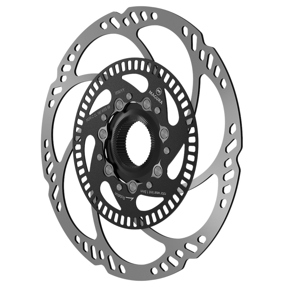

That will defeat the whole "RS" concept? I will have a custom disc made if it does not work out. I have Magura MDR-C discs and the tone wheel can be separated.
Mate, hardly would work custom disc. I doubt we would be able to set hole number. Also diameter of disc wont be the same.
But I can add this function to BBR to set hole number and will be possible to use old and new sensor.

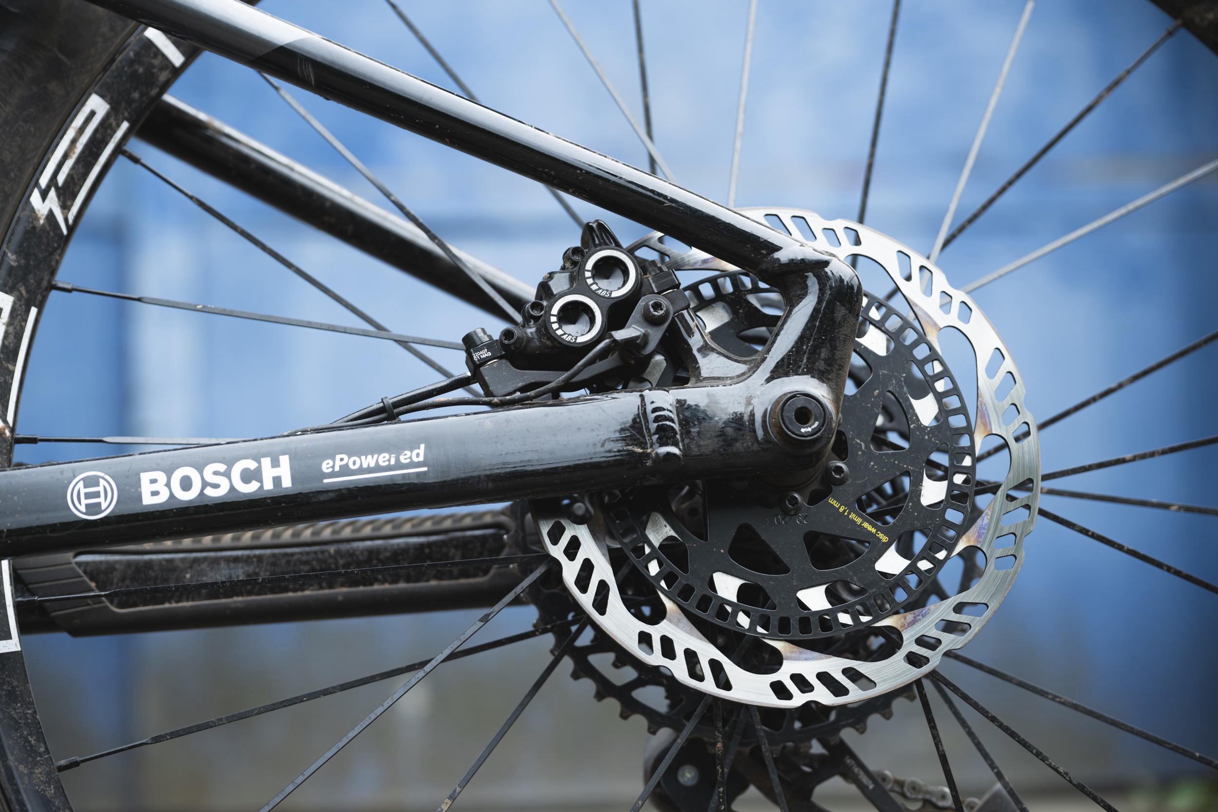

I wonder if the ABS sensor brake caliper bracket would work.
That would make a nice and clean installation!
I have no clue about the dimensions of the Bafang sensor yet. It will arrive in 1-2 months.
Or if a Bosch ABS sensor is adaptable to the Bafang system.

I doubt will be same signal (but could be), connector needs to be rewelded.
Also same number of holes needs to be saved (or can be compensated by circumference if not much off).

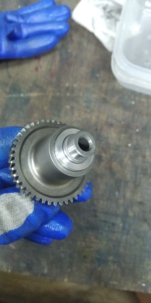

It looks like the one way bearing should disengage the motor and the gears is seized in my M560RS. Now spinning the crank arms also drags and spins the motor. The motor has about 300 miles. I used it with 50A 60V 3000W Innotrace M560 controller
Bafang still has not fixed the old issue existed since M600
Your new motor mod is putting extreme loading on a bearing not designed for that amount of torque ( you can't blame Bafang for that ). I would suspect that the shaft temperatures are also way above the designed limits and probably melting the internal lubrication enough that it dissipating or not effective.
There are various manufacturers of various quality of these bearings and you will need to download the spec sheets of the bearings, from memory of the development of TSDZ2 motor there was one manufacturer whose bearing could cope with the higher loadings, you will have to contact a bearing dealer or do research on the net to find the spec sheets.
You will need to log somehow the internal motor temps ( not just rotor temp ) as well to find just where the balance point of power and too hot a motor components is, I would suspect that the max Watts over a period of time won't be much more than what Bafang has designed the motor to cope with.

Did you run the full 50A 60V 3000w for extended periods of time? That is a considerable amount more than the rest of the unit would have been designed for. Time to pull it all apart and see what failed.
I did. All those 300 miles I used it at maximum assist level at 3000W for commute and wheelies.

If your controller doesn't throw an error when the clutch is locked, you can firmly lock the gears. The original controller, however, throws an error about excess current when pedaling, likely due to the generation.
