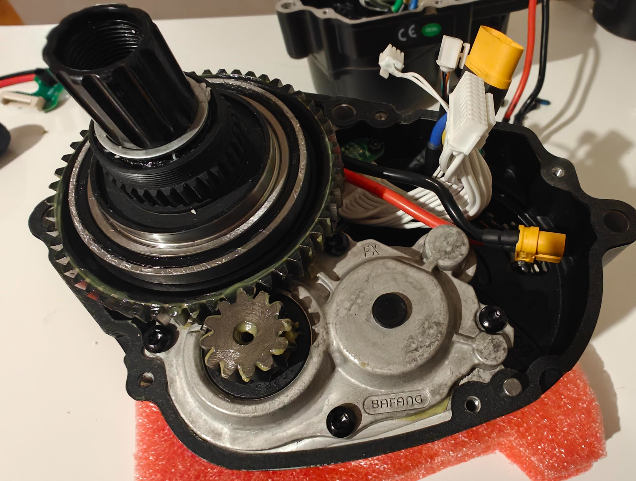

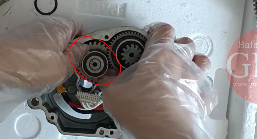

But this new revision of M560 sounds interesting. Did you have a chance to open it ? It is really that silent ? Not sure if peek gears would make it silent alone. Maybe some other design changes but I doubt about it. Maybe I would give it a try, how much it was ? But then I need to sell 3 motors I have in my possession M510, M600 and M560 older revision :)
It is some peek gear. And yes, only first gear from rotor axle is needed to have in "plastic". As here are highest rpms and most of noise comes from here. Just you are the guy, who wants to contradict everything. ;)
I have 2 on the way, will open one. And we can bet, internal gearing will be the same apart first gear. If rotor teeth stayed the same (and also next gear) will be possible to easily make quiet also older motors just with swap of gear. If bafang would want to sell it, as I had really hard times to get spare one way gear and motor was on a market for over a year.

What do I contradict ? The most noise is from the steel rotor wheel (the one with magnet) not from the gear themselves. This one spins highest RMMs creating this high frequency noise and not the gear wheels. I I doubt they would make rotor with plastics. It would not withstand the load...
So not sure what I contradict. Once you get your motors just open it up to see if they really did some structural changes because just changing this peak gear wheel alone will not make the motor silent. It can reduce it though but then the question how long it will last.
This is the peak gear in Bafang motors but pretty sure you know it. The problem is rotor in my opinion.

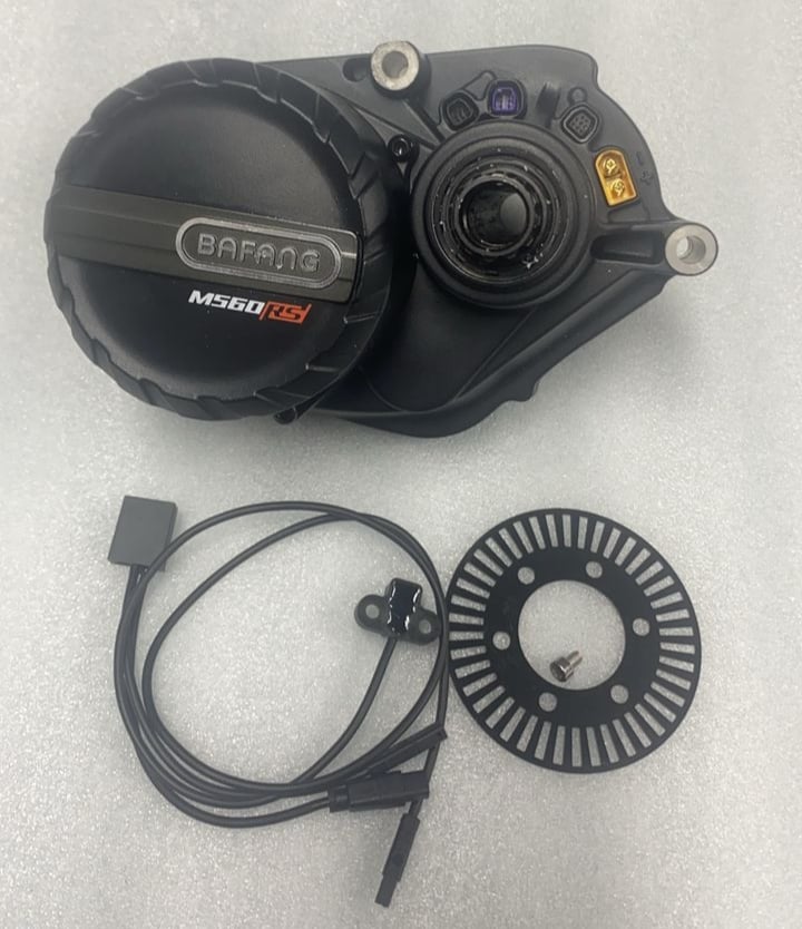

It's difficult to get real world test data but from what I can find, the 'RS' versions appear to be lower noise. In the comments of vid below owner states M560RS is quieter than Bosch Gen 5 which is saying something. BTW that's a 22kg beast of a bike.

Not sure what M560RS they have. But I doubt will be with PEEK gear. That sound on uphil is familiar to me. ;)

Interesting, it has been a long time since I worked in Mech Spec Purpose Machine design but looking at plastics properties , PEEK is indeed very high performance. Another is Torlon, even stronger but doesn't like moisture and less chemical resistance. I recently watched an Avinox M1 teardown video - it's an engineering masterpiece. I'm not sure Bafang can do this, I'd like to be proven wrong.
Yes, DJI is piece if art. 2.5kg - unbelievable.
It has 3 nylons (or some material) as planets. So not to be affraid about stripping it.

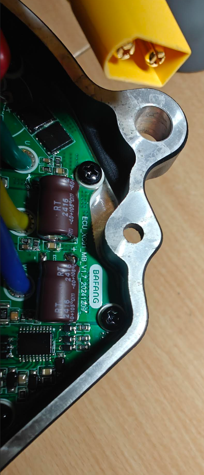

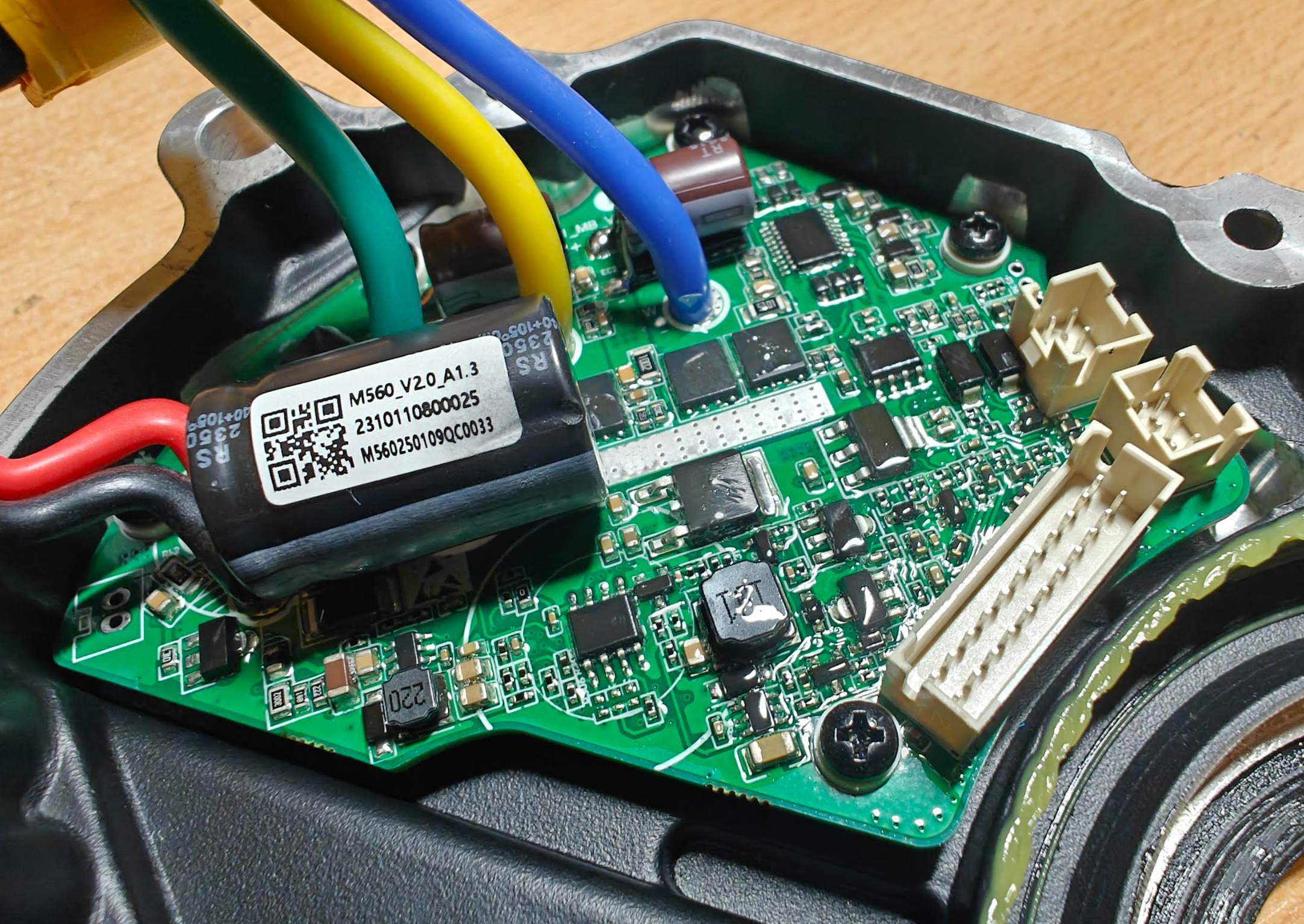

Did measure FETs switching speed of this RS controller, has 16kHz. Just if somebody is interested in this parameter. I guess all the Bafang CAN controllers has also 16kHz.
I'm not up on variable speed drives (controllers) for E motors but in the broad scheme of switching, 16kHz is pretty slow. As an example audio D class amps are running MosFETs at a few hundred kHz to MHz and now some are utilising GanFETs - but driving an E bike motors stator coils is a very different beast. Will have to do some study....
Is just normal for ebike controllers.

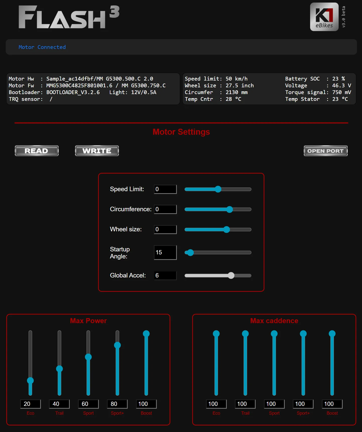

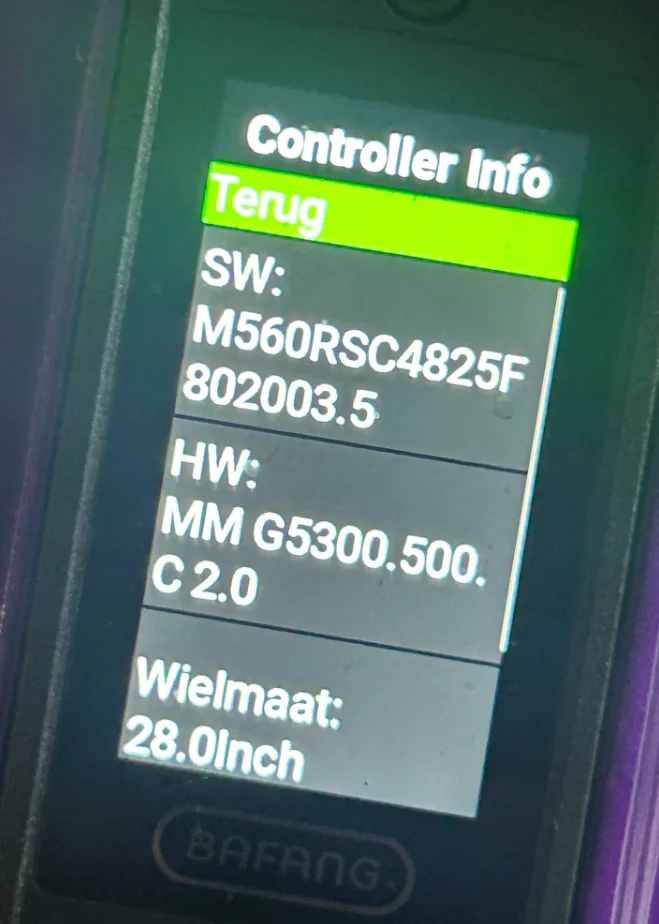

One interesting finding. Have tried to flash 750W firmware v1.6 into M560RS.
Torque sensor is giving torque signal. But to my surprise throttle and also speed sensor does not work. :( So looks like RS would stick with 500W.

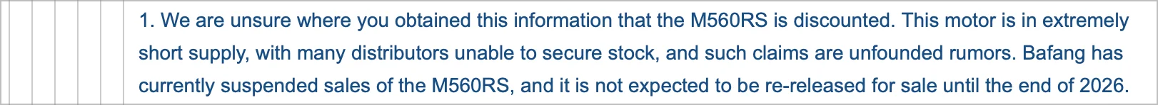

About 560RS motor discounted i got answer :
Dado, can You elaborate a bit please ?
Is it restricted to 500W only, it does not make a sense ...
Dont know why only 500W. Was available only in this single firmware.
I have tried to flash 750W v1.6, but wasnt working speed sensor. And to my surprise also throttle was not working.
