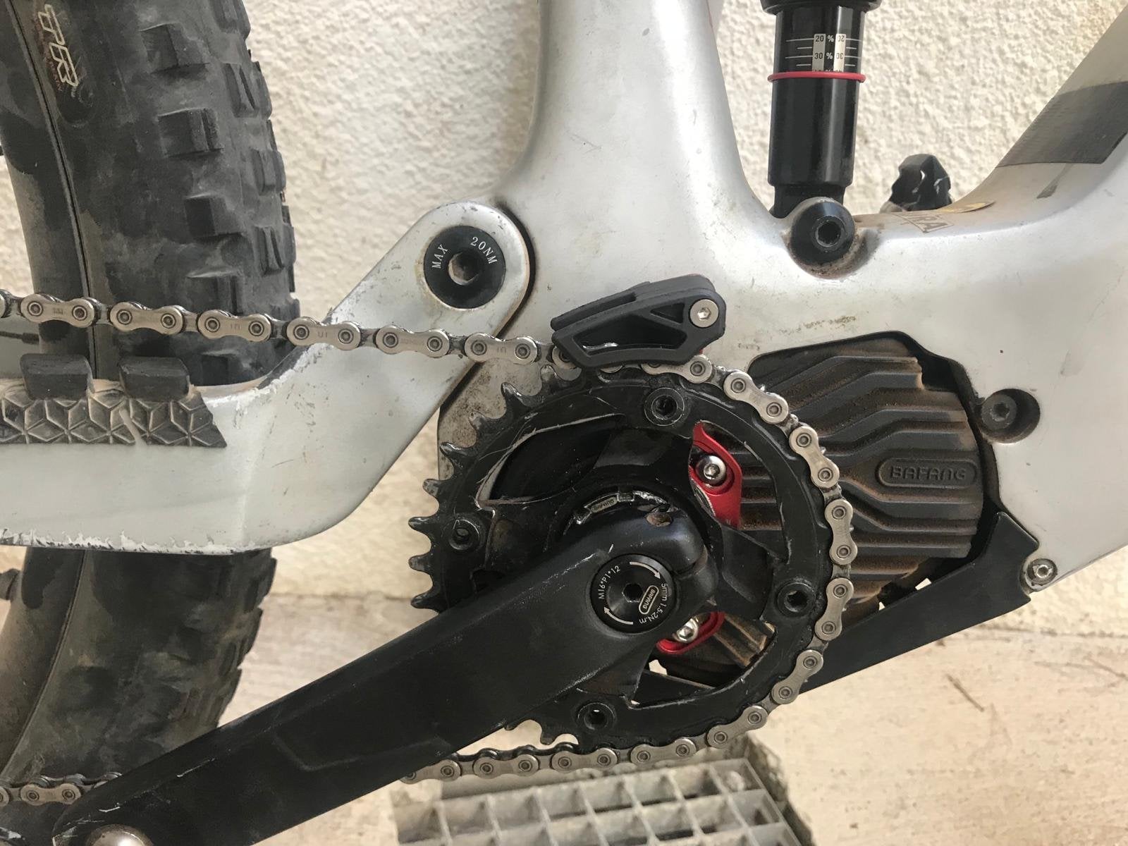

hmmm..... well mine don't... when I put the 2 bolts in (with no washers) then I put the chainring back on... it interferes with the chainring big time...so mine must be slightly different...who knows..
Are you using the right holes? Mine has three
mine has 3 too.... yes.. I'm using the only obvious ones... I mean it fits on...looks great... but then you put the chainring on and locknut.... tighten up then when you turn the cranks, it rubs big time... we thought after say 100 miles of a rubbing noise it would wear away.. but that metal is so thin it will just snap I guess... really weird.. I was only wondering if I was a washer missing from beginning... who knows... what chainring you running? looks like a 34T?? U see, I changed back to a 38T with a 11/52 cassette... I did have a 32T on it with 11/42 but too much spinning, I just prefer the 38T 11/52 setup, thought maybe the 38t chainring was the issue... but it states it takes up to 40T.... I'll just ride it without.. maybe being back to this set up will stop so many chain drops....
Mine rubbed from new (e-mythique) so I put a washer on the chainguide.
Maybe the 38 has an offset and the smaller rings dont
Possibly... can only be the reason I reckon... no matter... I think my chain will stay on better with this set up anyways.. I neve rhad many chain drops when I ran this set up at first... I only changed it as I fucked up the previous 11/52 cassette in a fall.. and I had a 11/42 from my gravel bike.. and I already had the 32T chainring...oh well... we'll see how it goes.. thanks for your help, regards Martin

so, for anyone who was looking in on my questions about getting this chainguard to work, I eventually got it to fit.. but I had to remove the 38T chainring.. as they won't work without rubbing rerally bad on the rear of the chainring if you try it!! So I changed out and put my 32T ring back on and changed the cassette back to a 11/42. Having not properly tested it yet, it worked perfectly on the bike stand in workshop....Pity cannot get the 38T ring to work with a chain guide... as I tend to need more bite... maybe I'll buy a 36T and see how that goes! But I was out on bike today with the 38T chainring and the 11/52 cassette and the chain dropped 12 times!! stuff that!! So obviously can't live with that... The tracks here are all very very rocky!! thanks for anyone who contributed, cheers
