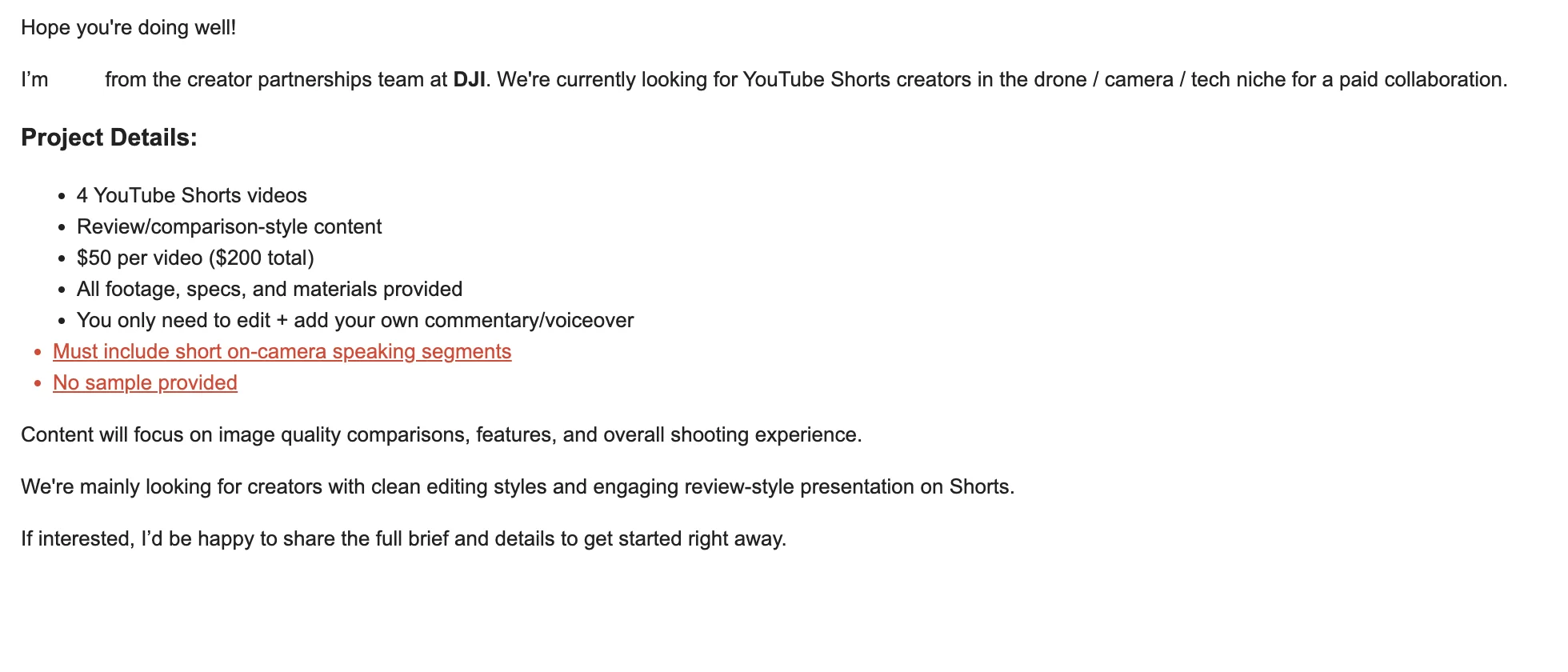

This is how they work... just saying, an email i received today...

maybe they should ask more transparently, "We would like to place an advertisement on your channel," i cant review something ive never use.d... if they asked for an ad i might say, oh yes, i understand...
Am I missing something??
That's pretty much the same message a zillion companies send out for product promo.
Each "influencer" decides if.thst fits with their model or not ?
Seems pretty transparent already with what they and others say.
Reviewing a product you have not touched, seen or used, is not a review. It feel like to me that the people wanting to do promotion dont actually know what the differences are. Maybe ive missed something culturally... who is going to tell them...
It's not a review. Even if you're "comparing" image quality, without sourcing the video yourself you can't really judge it against anything else and be truthful. I mean there are ways around this like just commenting "from what I can see..."
I like to look at reviews from DC Rainmaker as the standard and go from there. Ask yourself, WWDCRD? I get making money, that's a real thing - but "fake" reviews are bad and taint your brand.

Respect to those creators banking 200 bucks for 4 vids jfc is this the money we are dealing with?! :ROFLMAO:
It is an absurdly low amount of money, but it's the access to the new gear at no cost that drives subscriptions, viewers, more profitable sponsors, etc...
