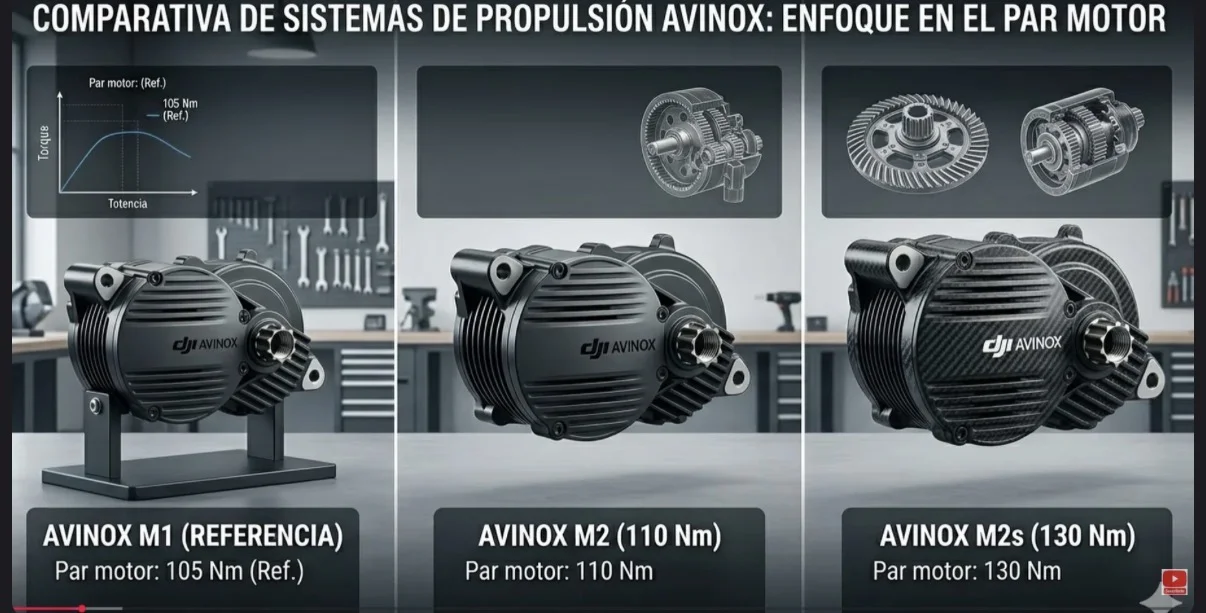

Could have sworn that I had saw a diagram of 3 different Avinox motors.
The old one, the new M2 mid range product & the top of the line M2s.
Did the M2s diagram show a CF case?
What was the other stuff the diagram was showing?
Check my comment a page or 2 back. I grabbed the shot from a Youtube vid. Not sure how accurate it is, but aligned with my thoughts considering the "s" in the M2S name
Yeah, that screenshot implies there is a difference in the gear pack or something. Composite case seems like it wouldn’t be good for heat dissipation, but it sure looks like there’s woven mat.
The other thing that is clear from that pic is the M2 and M2S can hover in free space. The M1 needs a little stand. Impressive. 😝
Wait... that M2S looks to have CF housing. Mounting looks identical. Would like to see other side to see if there are chain guard mounts. What's the image source?
