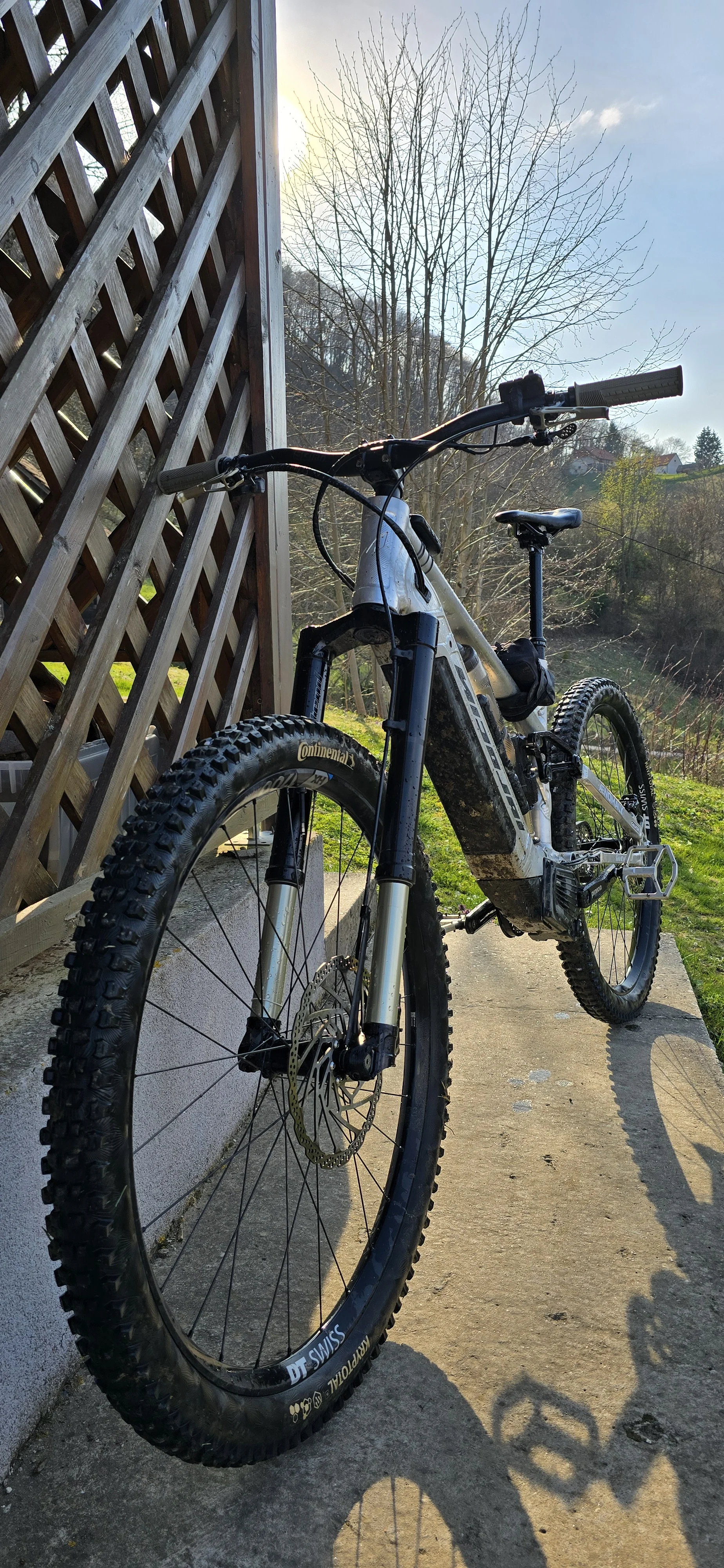

4000 km ridden, 99,9% in the dirt, slob, rain, snow etc. Had MGU replaced at 3000 km, it has a 2 year warranty. Snapped a belt, replaced in 5 min. I do agree with what has been said BUT I love this bike, gives me a big grin everytime I ride it. Nicolai's service is top notch, they send me free spare snubbers, small parts without money asked. Yes I paid for all but the experience is good and I'm happy with the blind descision to buy this rig. Am I a beta tester, dunno, if so I accept it.View attachment 181112
