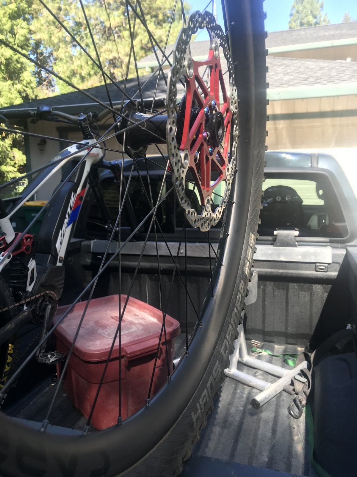

But i do prefer the feel of the carbon tear drop shape A symmetrical up front 711F98D2-0062-4C16-9C23-C62AE3EFDAF4.jpeg

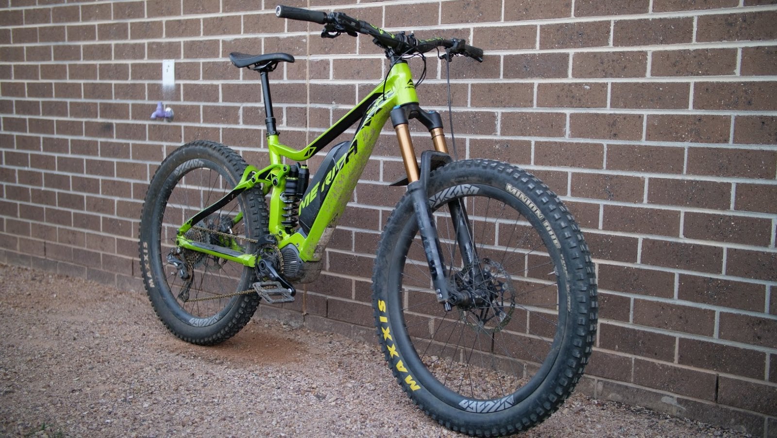

With the wide alloy eMTB rims they've skimped a lot on strength to get the weight down, my 42mm external rims that came with the Merida are only ~550g, which is less than my LB carbon 35mm rims on another bike. The Carbon rims are now still going strong on my 3rd frame, 4 years later. At $200 per rim (Nextie, on sale) for a decent 40mm DH carbon rim, they're not really that much more expensive than a decent alloy rim.
