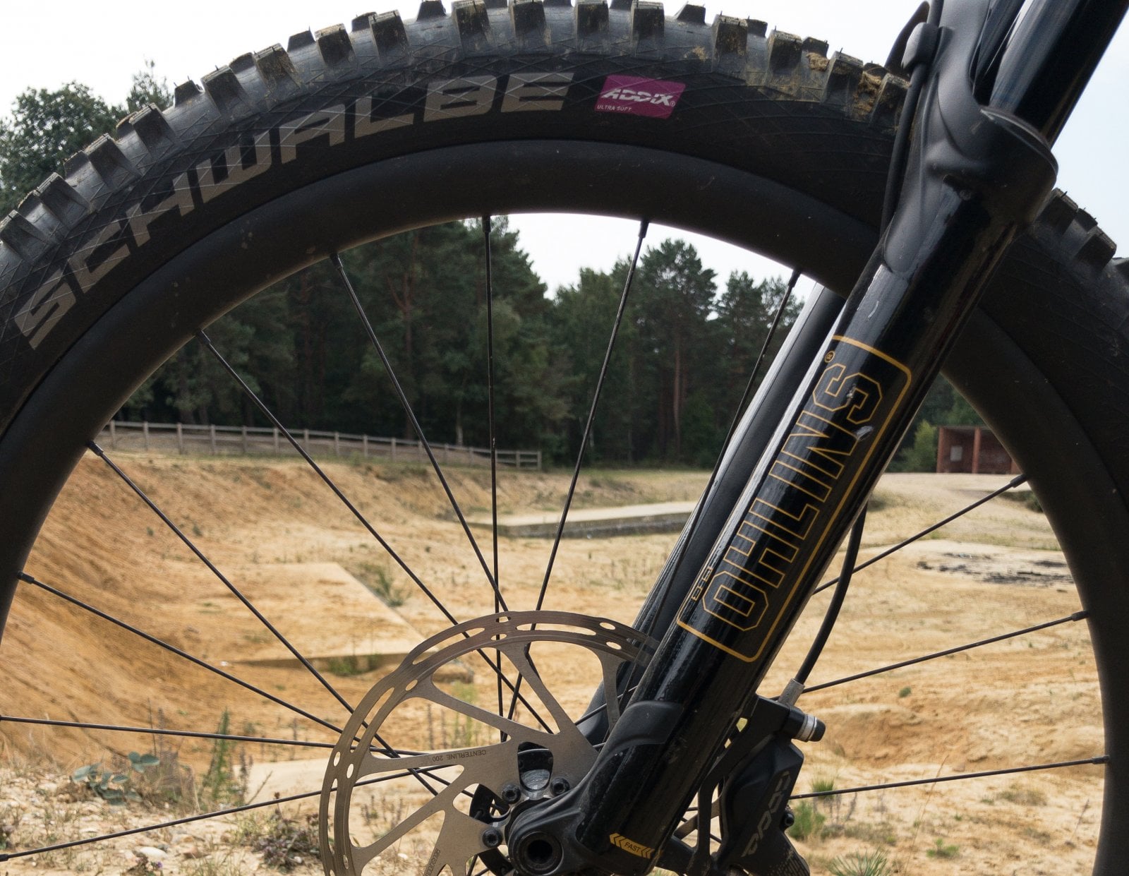

To those that have carbon rims and especially those who have made the switch to carbon, is it worth it to upgrade to carbon rims?
Does the motor negate the rotational weight disadvantage of aluminum? Do you have to run heavier tires or inserts with carbon because of the increased bike weight?
Are EMTBs with carbon rims more prone to injury than on regular bikes?

Be careful- go too light and you will lose rotational stability - which only shows up if you hit soft gloopy mud and your front end wanders all over the place.

I run the hybrid Carbon DT Swiss wheels with 240 hubs and love them. They are stiff and fast. I weigh 195# and hammer a bit. Zero issues. Great wheels built for emtb, but light. $$ though!

The difference would be so small it would be lost in all of the other things that affect range. I like the lateral stiffness of carbon wheels, but they are often not vertically as compliant as aluminum wheels, which can be slightly more comfortable to ride. Not an issue if you are running +tires though. Carbon wheels are light and sexy, but not really worth the upgrade unless you have play money. Says a guy that has them on all his rides...... lol

I have had two sets of carbon wheels - it's a must in my opinion. 50MM wide carbon wheels make the tire wider and thus a bigger print and stability. No tire issues. Just use 2.8 Maxxis or the like 120 TPI for heavy dudes (like me) I have beat my wheels bad and they hold up just fine.....

On that note - I wouldn't role a carbon wheel without it being 50mm wide as you don't see gains as far as footprint and stable flying DH

I've been running carbon rims for 5 years; I've just put an insert in after this happened.
I was running stupidly low pressure and cased a root!

I recently hit a square edged rock when running a MM 2.8 Snakeskin APEX Soft compound with 18psi on my carbon rims. It put 2 x 5mm holes in the tyre but luckily no damage to the SRAM ROAM 60 carbon rim. I am glad I went down the DH tyre super thick carcass route Instead of the insert route after seeing a very dented rim using Huck Norris inserts in another post which I will try and find and post for you.
Mind you, 5 years without damage is a fairly good stint. Although the damage looks like a proper rim right off ☹️

Yep, total write off!
Unbranded rim (bought 2nd)
approx 15psi maybe less!!! I knew it needed air, but I was short on time!!
90kg

And no smashed rim as pictured above.
But I think @highpeakrider logic is valid. Lightweight rims but heavy tyres ?. My logic is inserts work and are lighter but......
The photo below is what can happen. Huck Norris insert used, the tyre was okay the rim, not so okay ☹️
However, there is a carbon rim available that might give me the confidence to use an insert and lighter duty tyre and not worry about the rim. The only problem to resolve for me personally regarding the Welsh slatey terrain I ride in is cuts/slashes to the sidewalls which inserts do not protect against....so I still may have to use DH or possibly try a Super Gravity carcass.

IME, a good carbon wheelset that isn't built for featherweights is tough as hell. I've had a couple that had a no issue warranty sort of deal that I completely abused and actively tried to destroy while riding my local trails and suffered no damage. An aluminum rim would have still been in one piece, but would have certainly been dented up and out of true. I have cracked one rear carbon rim, but it wasn't designed for what I was doing to it.
Unbranded usually means cheap Chinese carbon rims which have endless quality control issues, just google them.
